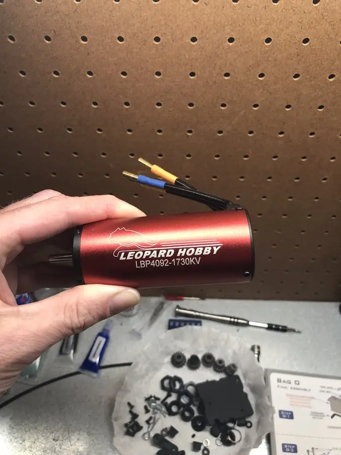

Well there are two choices with the 4092, 1730 and I think 1450. I was thinking 1730.

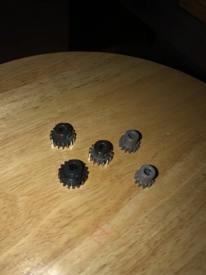

Are you planning to run 4s or 6s?
If you are running 4s you may even want a bigger pinion than those like an 18t. 1730KV on 4s (w/out a load and at full charge) has an RPM of approximately 25,604rpm. I run a 1900 on 4s (thats roughly 28,120rpm) with a 17t pinion to get me where I want to be.
If you go with 6s on that motor then you will have an approximate RPM of 38,406rpm that is about 36% faster and you will then probably want the smallest pinion you got like the 15t.
Was planning on starting with 15 and using 6s.

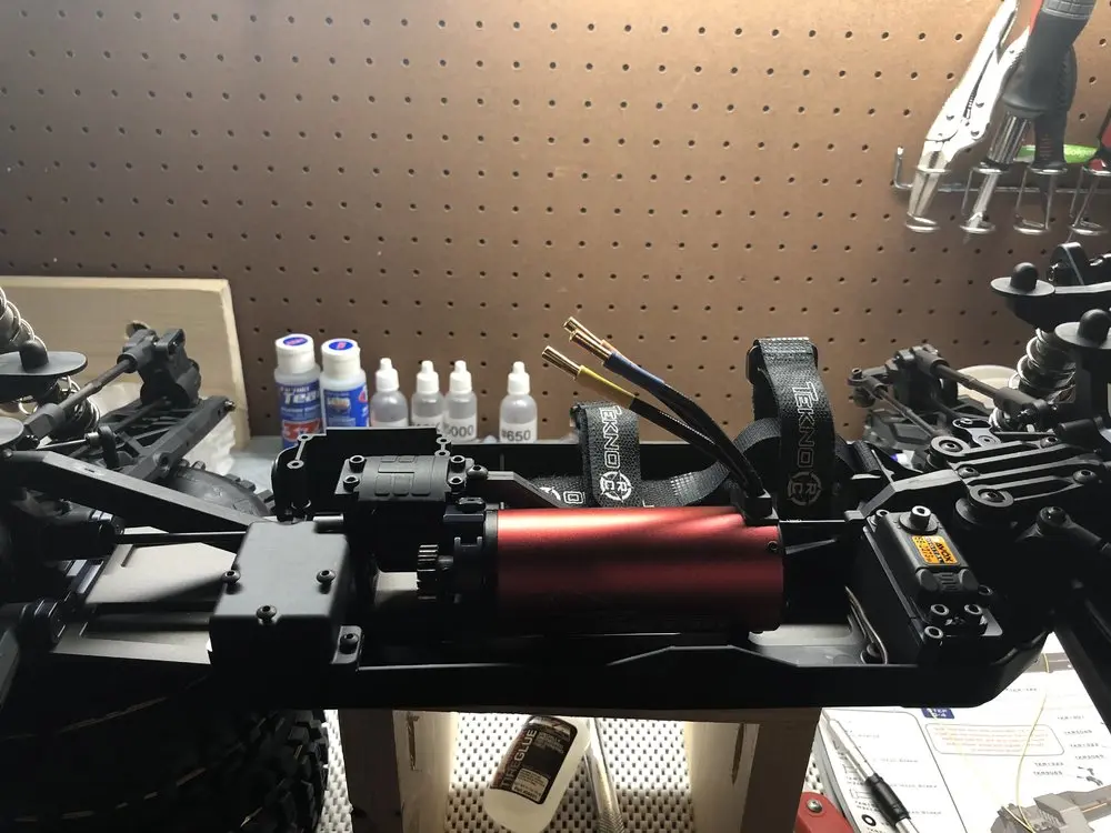

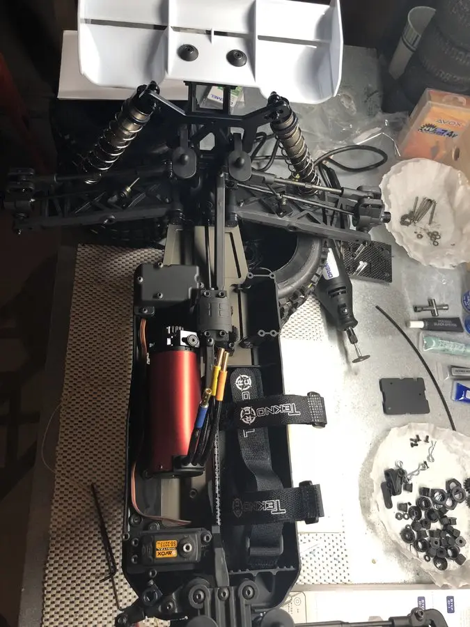

Good advice! And I love wrenching! Hoping to have this thing up and running in a few weeks! I’m definitely going to run everything at stock first and adjust from there. I’ve got a few planned upgrades that I’m going to make over the next few months.

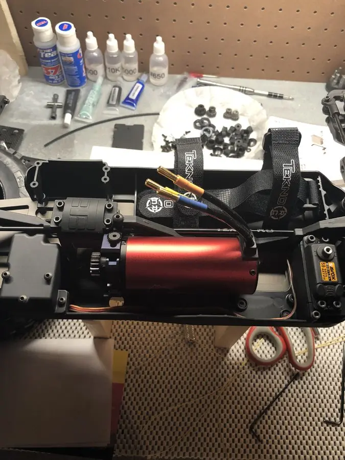

So between the max6 and the leopard 4092 I will need bullet connectors. I’ve never used them before. What is recommended? I’m guessing at least 5.5 to 6 mm in size for the 10 gauge wire?
Thinking something like these
https://www.amainhobbies.com/castle...nt-bullet-connector-set-cse095-0009-00/p34184
Those should be fine since that's bigger than most rtr systems come with. If you want to remove all doubts and get the biggest ones I've seen, get the 8mm ones for three doll hairs more.

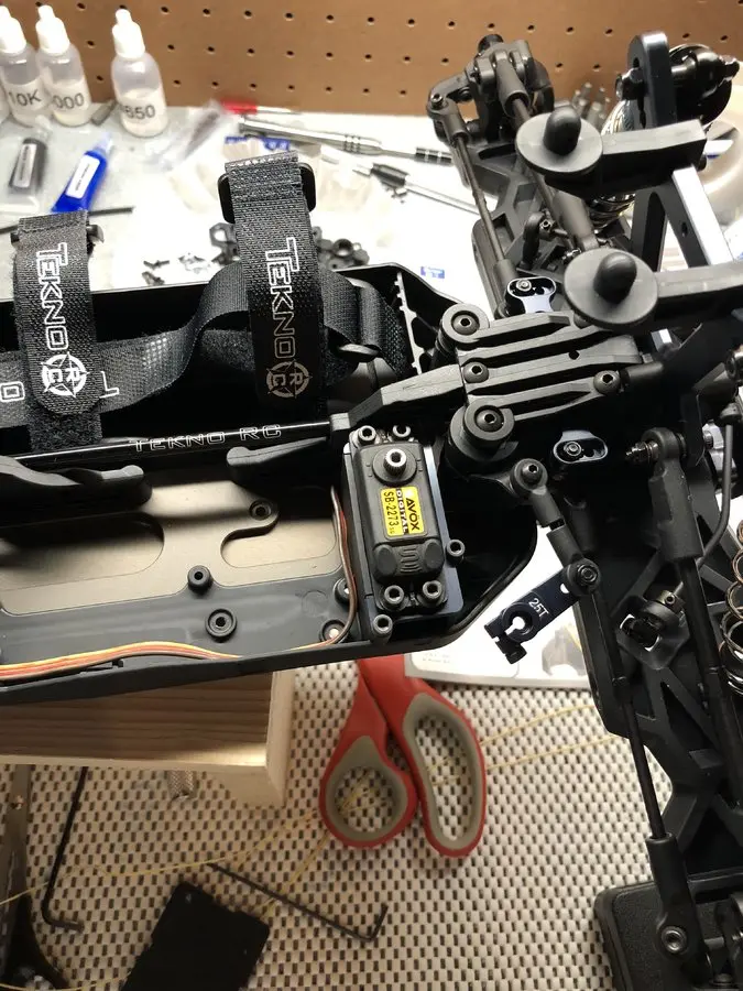

Servo mounted!
