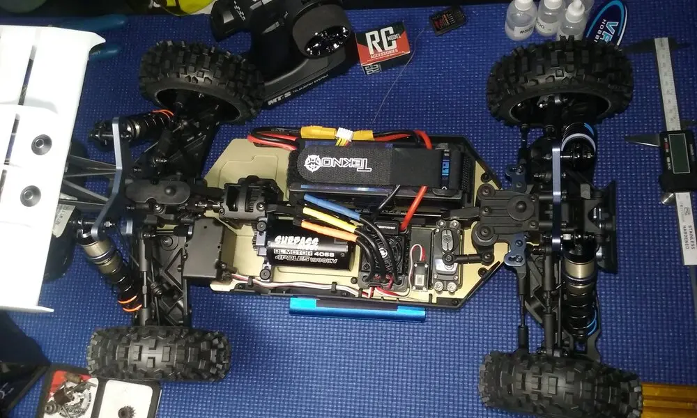

A 4268 1900kv motor would be great place to start. Pick your favorite brand and go. Visiting top ESC/motor brands websites will maybe persuade you in different direction than what you had originally thought. For a buggy basher build I went with ultra low budget Surpass Hobby motor...

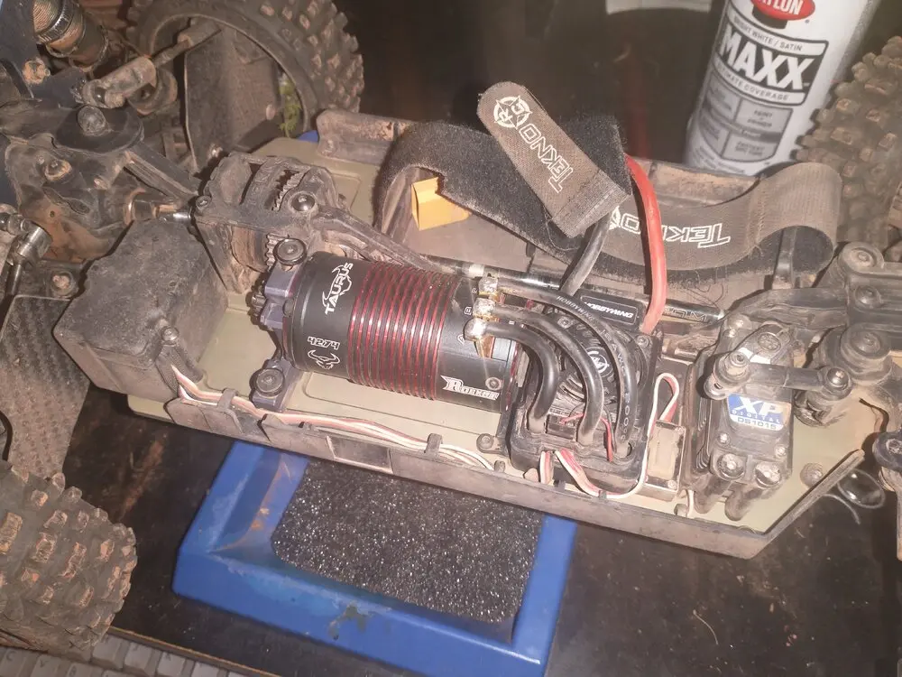

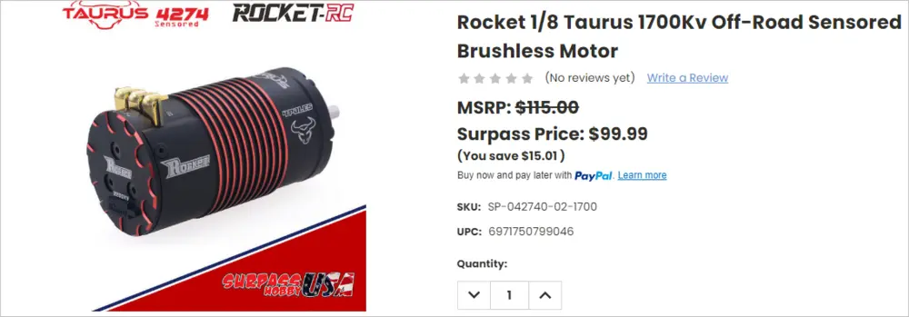

Later on I went with another Surpass Hobby motor. The 4274 Rocket motor was not enough for my monster truggy build so I put it to use in my EB48. I chose the 1700kv because (in my head) the powerband was better suited for my tighter backyard track. I didn't need that extra top end speed. The longer (truggy sized motor) can was just because I wanted extra assurance to handle extended run times in summer heat.
(Sorry for the dirt. It's the only picture I got with motor mounted in my EB48)
