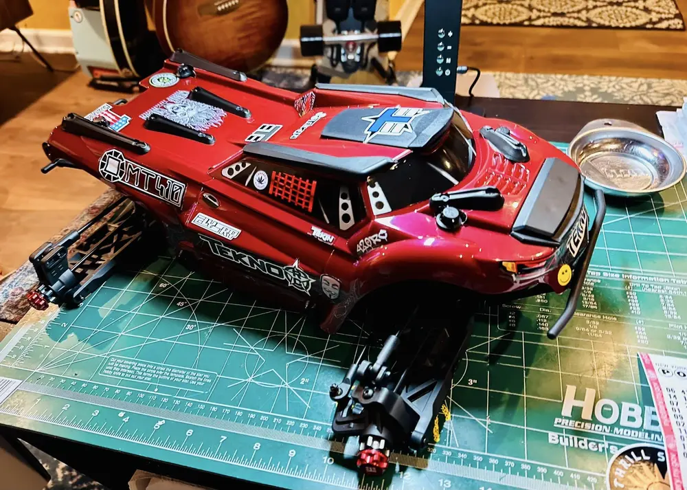

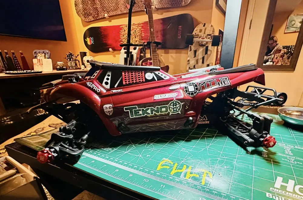

I just put an EB48 body on my MT410, the primary issues with fitting a body on the MT410 is
A) The shock towers are different. for the truggy, the shock towers are what the body mounts connect to. Without making custom parts, you probably want to buy the truggy shock towers. Mounting an EB48 body this is not a problem because I mounted the body with velcro.
B) the steering clearance seems to have changed a lot between generations so depending on which gen the body is for you'll need to do extra trimming.

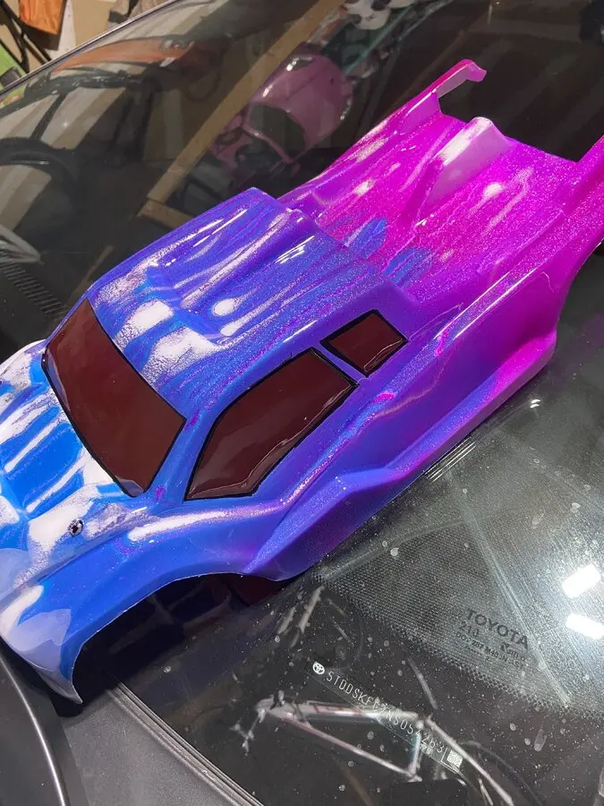

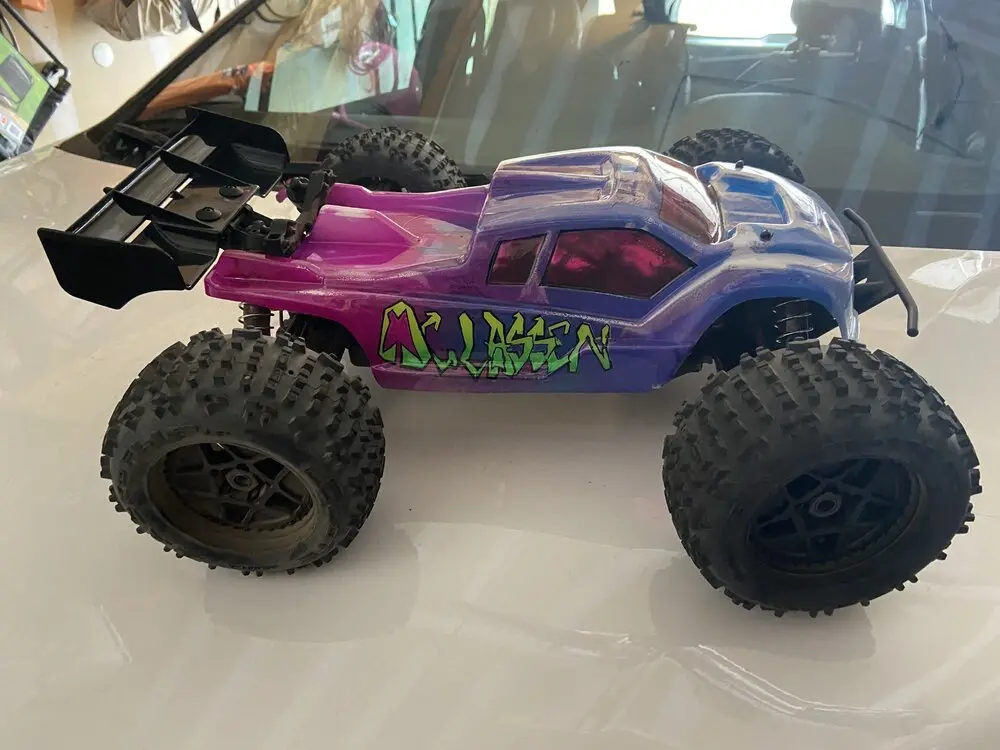

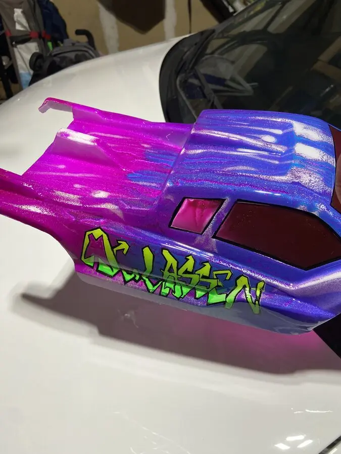

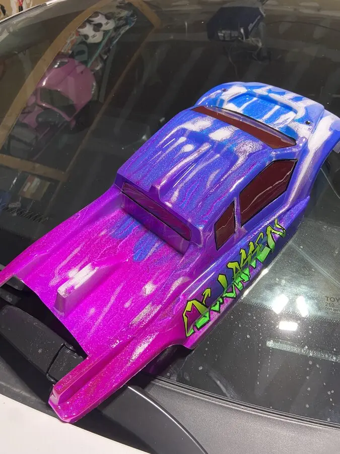

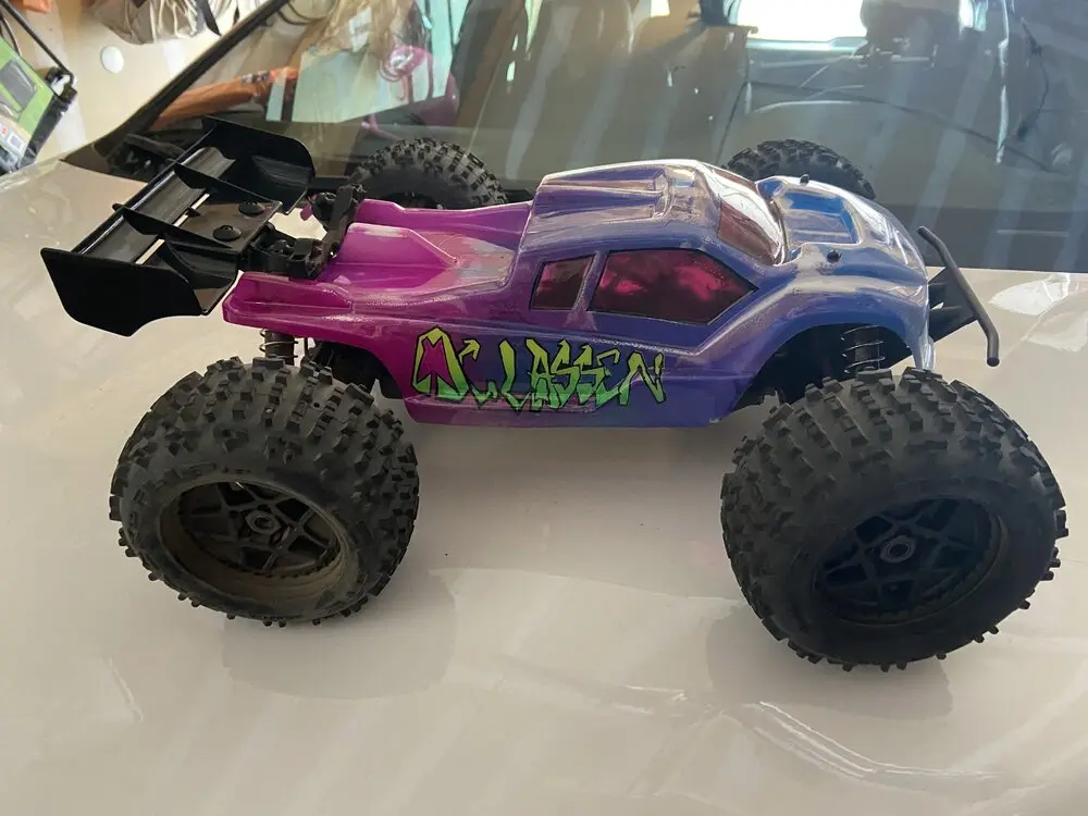

I went a little ghetto but didn’t need any additional parts. Jconcepts Mugen MBX7TR Finnisher body, and I cut out some of the bed. The rear side fins fit under the shock towers and basically lock in covering the shock caps so I just use two body pins in the front.
That looks class, and is exactly the look i'm after. Is that the low profile wing mount TKR5181?
That paint job is stellar, I can just about manage single colours :D
Thanks, dude! Yeah, it’s the TKR5181 paired with a generic 1/8 wing from Amazon.

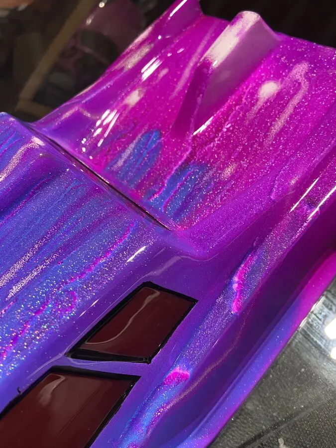

This body was all rattle cans including the sparkle (Tamiya Lame Flake). I used dish soap for the white streaking pattern by laying down streaks of soap before painting, letting the paint dry, then washing off the soap and painting white where it was. It was an experiment that kinda failed but I liked the result for sure.

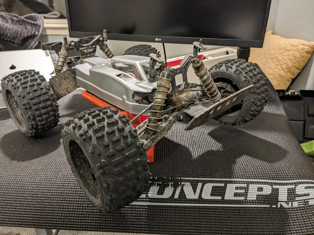

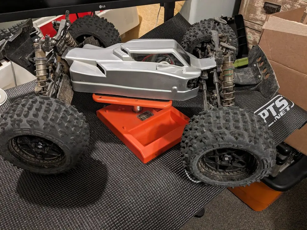

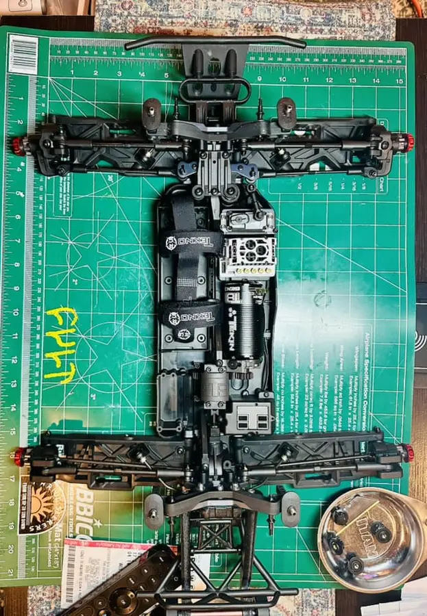

I forgot to ask, any pics of your build? Be interested in seeing how the buggy body looks on the MT
Yeah let me take some when I get home. It's kinda a frankenbuild, chassis I bought used and has the T-Bone bumpers and some M2C parts, and no wing, but I think the buggy body looks fine if a little strange to see alongside Backflip LPs.
