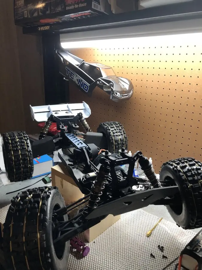

So I have it installed but the body does not fit properly with the two machined pieces from Mike :(:(:(
I’m going to reach out to him and see if maybe he can design something that would allow me to mount it in the front by the front shock tower. I just ordered some .125 kydex and I’ll fashing something for now. I had to modify the body to get it to fit. Basically I had to cut a hole near the back side of the roof.

I destroyed my ET body thinking I could get the max6 to fit....

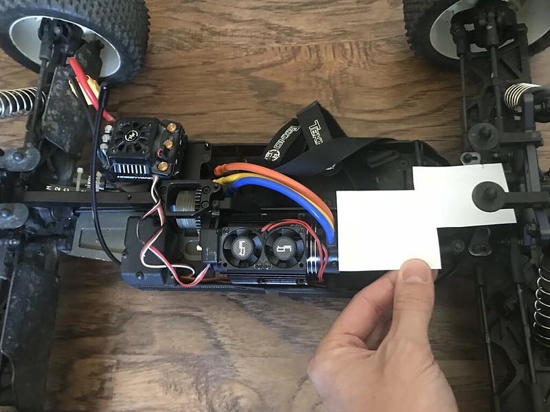

Picked up the MMX today at my LHS

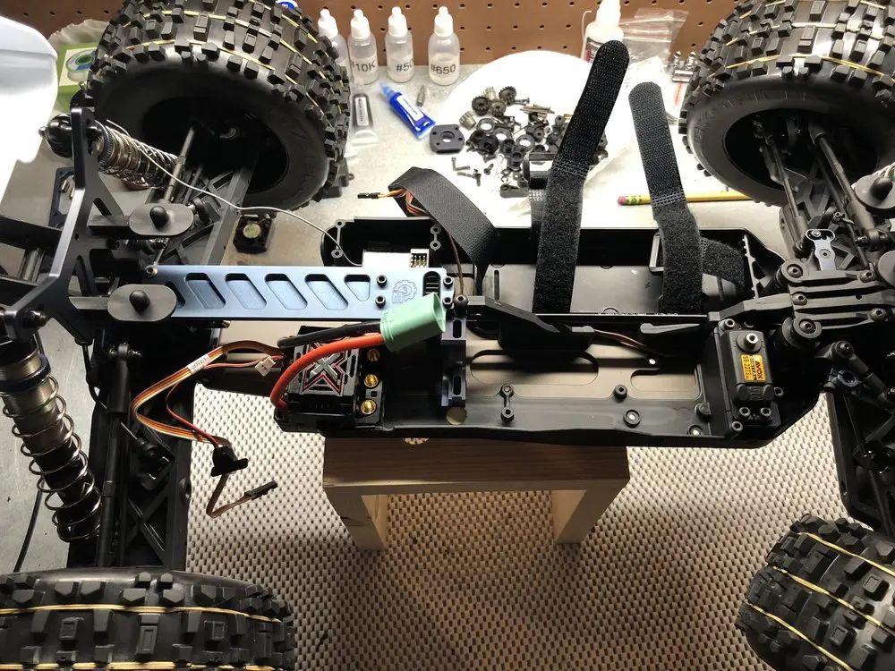

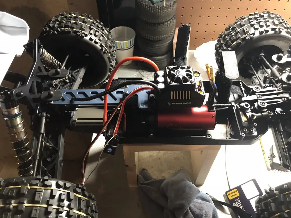

Started dremeling out the receiver area to mount the MMX. Definitely still using the M3 rear brace which means I’ll probably have to part ways with the esc mount. If this works out then I’ll post it up for sale in the appropriate forum.
I removed the small fan off the MMX and broke it already haha. The shroud is still intact and that is all that matters.

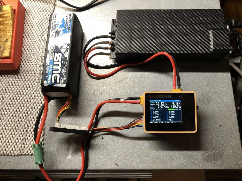

Ok....got my new PS and icharger setup and going!
I did some modifying on the receiver section to fit the MMX. As of right now I’ll put the receiver on the other side. I’m going to use the existing screw hole to mount the antenna tube. Should be easy. I might have to remove some of the side plastic to slide the MMX up a bit. I just reviewed @Overkill’s and I believe that is what he did.

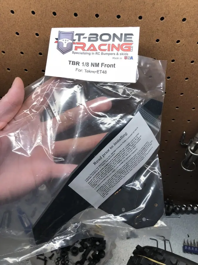

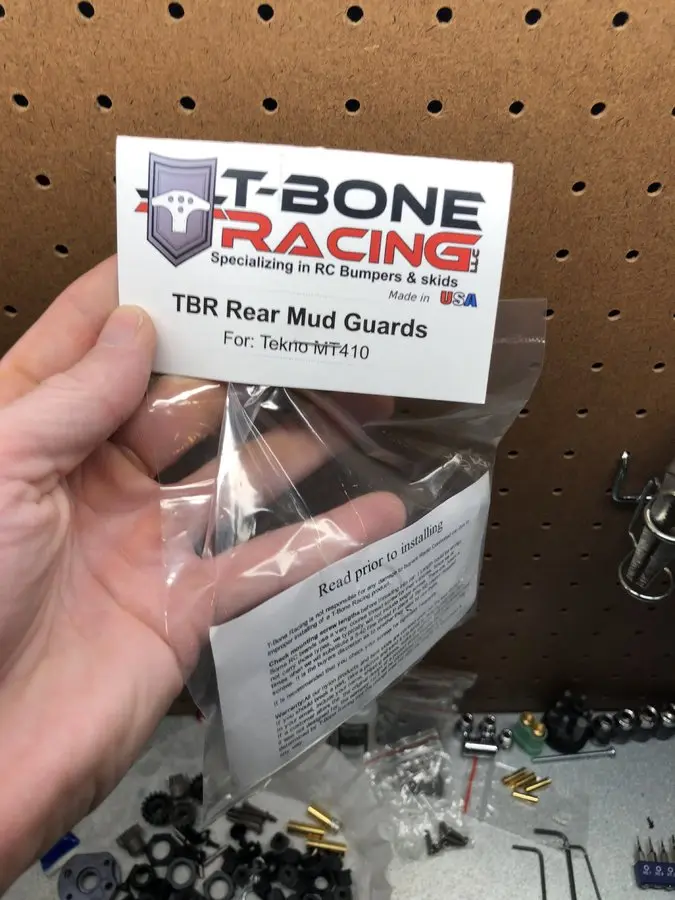

Not sure when my T-Bone parts come in. The status still says unfulfilled on my account. Weird. I’ll have to reach out to them....
Sadly this is a common complaint about T-Bone Racing. There are several others having the same issue over at ArrmaForum.
T-Bone Racing has told me in a PM that they are working to resolve the issues as quickly as they can. I hope for everyone's benefit they get everything back under control.
Might not hurt to send T-Bone Racing an email for a status update.
Sent them a message. They responded and said they are working on it!
Just got a message saying it was shipped today!

That would work! How is it working with where you put it? I imagine you had to modify the body?
You can see the ESC in the back corner. To not have to modify the body it has to hang off the ESC plate 50% and I have just Zip tied and Velcrod it to the rear brace. One zip tie on the plate and the other to the rear brace. I also had to order 3" longer motor wires for this location. Kind of lame it doesn't really work. That's why I contacted MMM Mike in Germany for a better solution.
If I wanted to use the M2C ESC mount on top off the center differential I would have to have a different body. For an MT410 this would not be an issue. Their MT bodies will fit it almost anywhere, but the wires for longer can motors still might not make it. My 4274 motor has the same length wires as the 4092. This puts the wires 20mm further from the ESC.
I really thing if Mike could come up with a plate that bolts to the steering brace and holds the ESC above the servo we will be able to fit nearly any motor with fans mounted and it keeps the weight in the similar spot as the stock configuration.

The Max6 will fit in the area your MMX is at. It may hang over the chassis a tiny bit.
