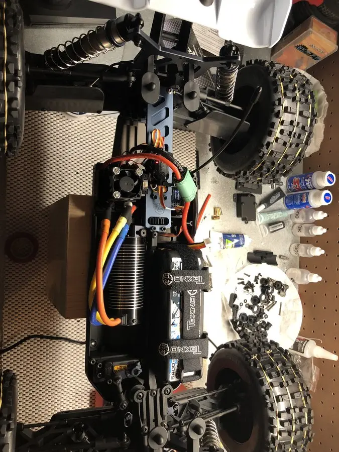

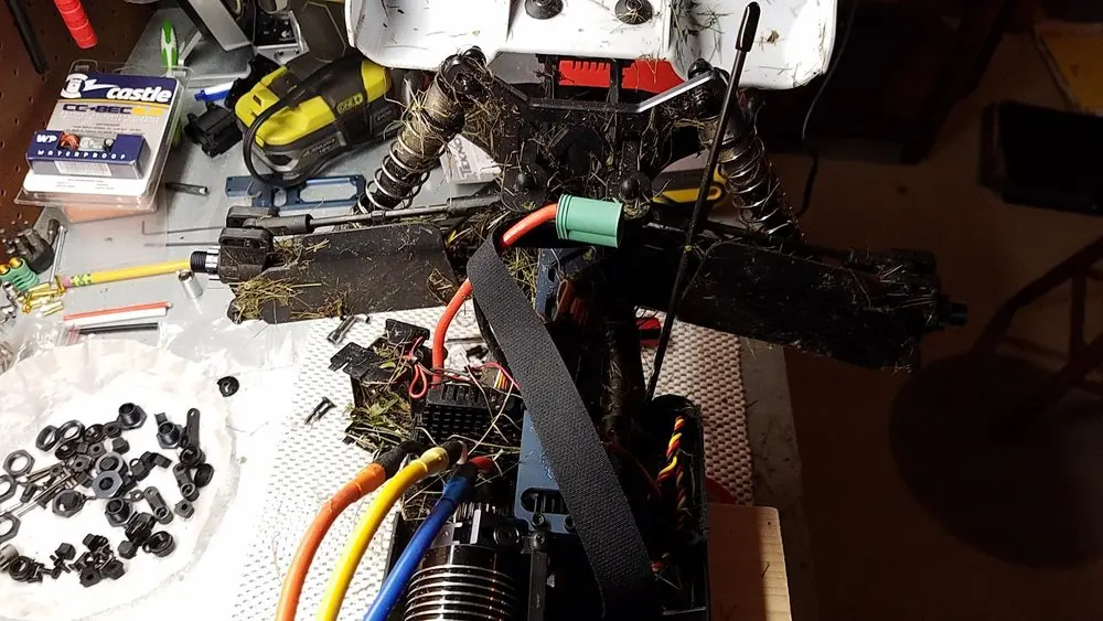

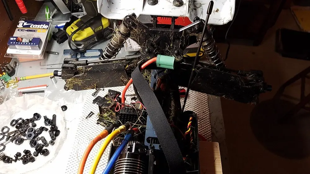

It is running!!! I’ll get video tomorrow! I installed the R1 fan and it turns on initially but then it shuts off. My ESC is also beeping about once every 10 seconds. Not sure what it is doing or why the fan isn’t running.
View attachment 1423View attachment 1424View attachment 1425
I have two Castle ESCs and they both beep about once every ten seconds. From what I have read, it is to remind you that the ESC is powered on so you don't leave the batteries plugged in and walk away. Also, when you plug the batteries in, the ESC beeps the number of cells that it is registering based on the voltage that it receives. I don't know quite what to tell you about the fan though.
I figured it out last night. I turned off the idle beeping. And the fan kicks on at around 150 degrees F.

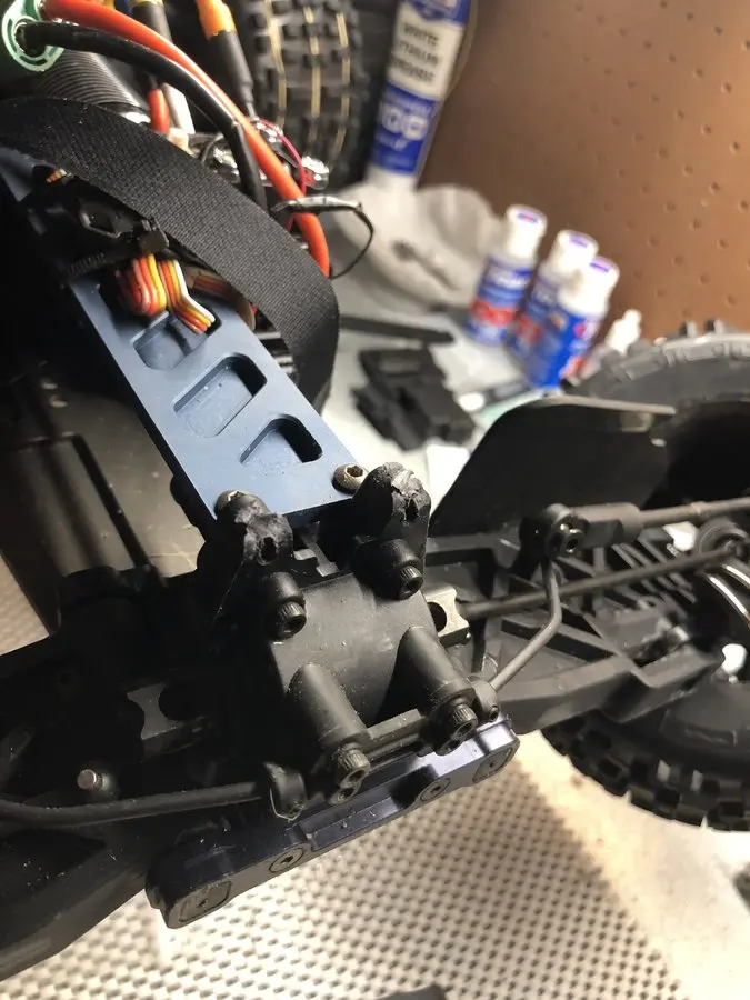

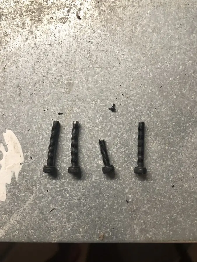

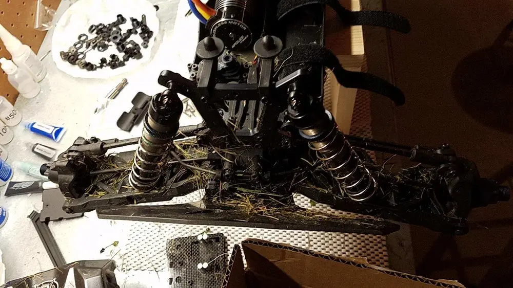

I took it out today and already bent the rear shock tower and two screws that hold it in lol.

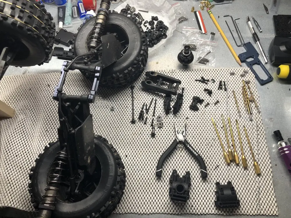

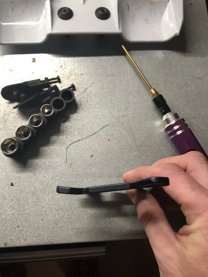

I took apart the bent rear shock tower and discovered that 6 screws were bent and the gear box was destroyed enough to warrant a new one. I ordered new screws and a gear box as well as a CC 15 amp bec to see if it fixes my servo issue. I did a lot of research last night and it seems MMX ,or just Castle Creation in general, has a weak BEC combined with a power hungry Savox servo. I’m hoping the bec solves the problem.

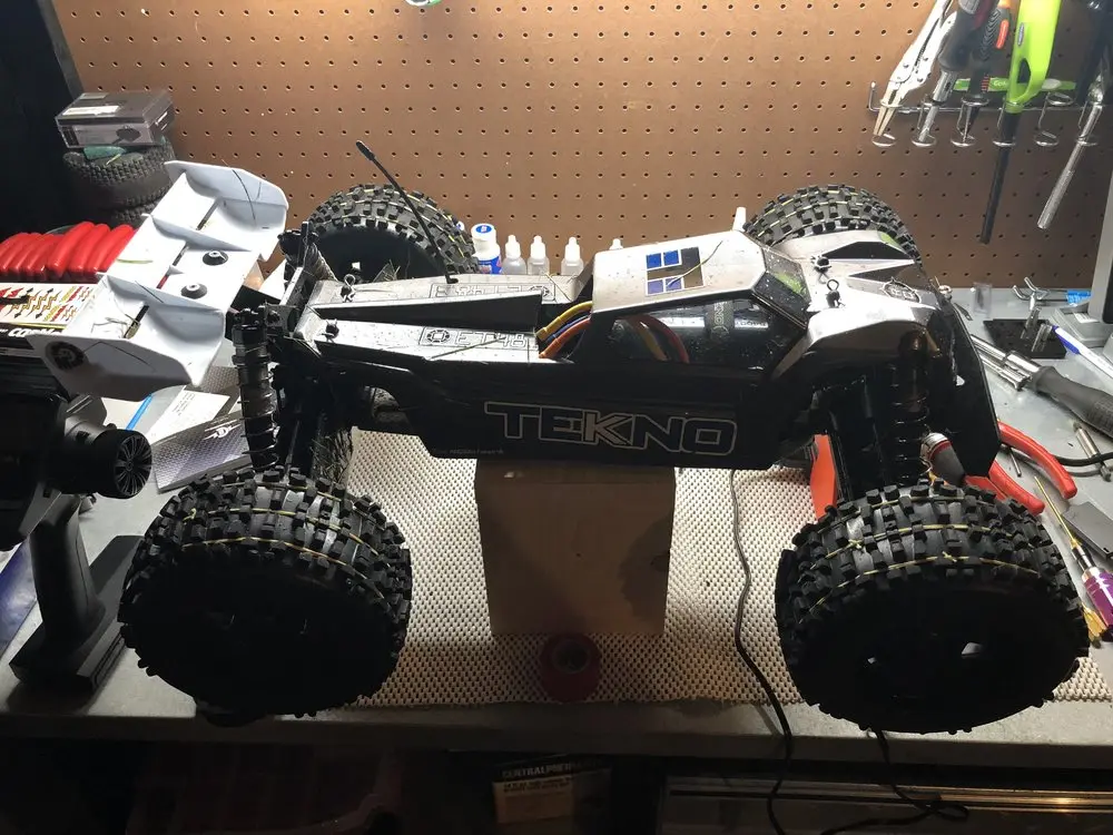

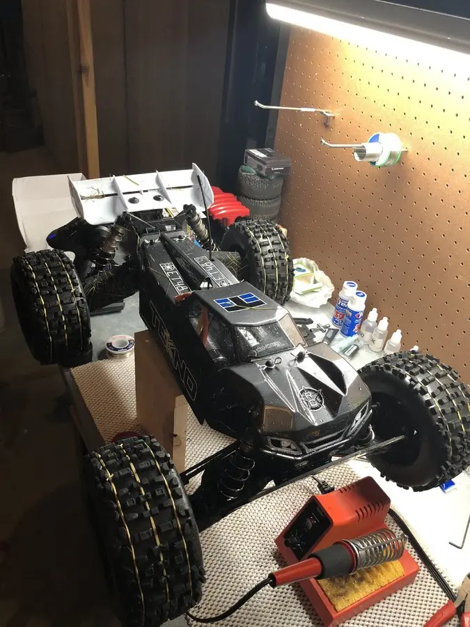

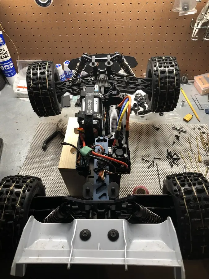

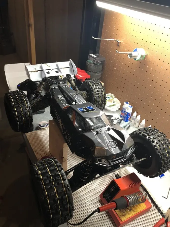

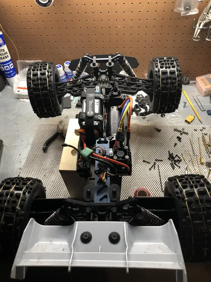

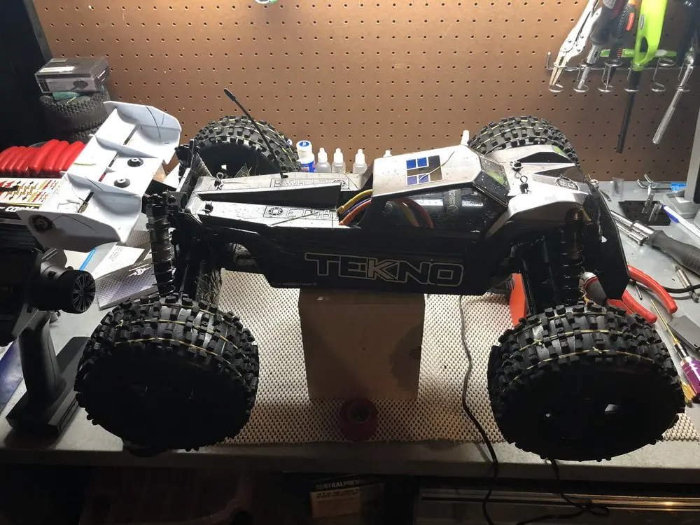

I got the new parts installed Friday night. New hitec servo, rear shock tower that I got for a steal on eBay ($10), rear gear box and some new screws.

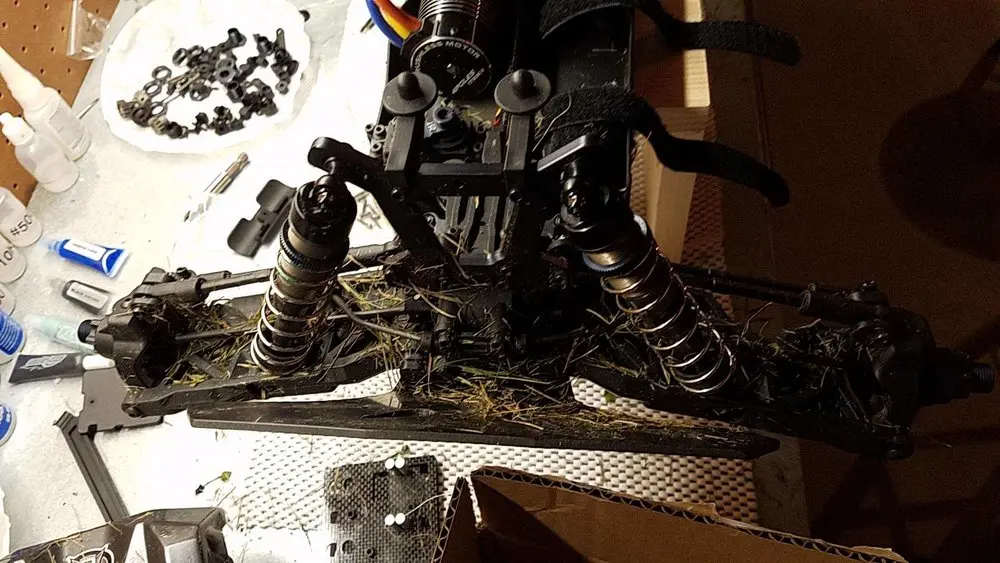

I took it out to bash in the park near me and the grass was still wet! Servo worked flawlessly at 7.4v. Here it is setup ready to go!
Here are some pics of it covered in grass.

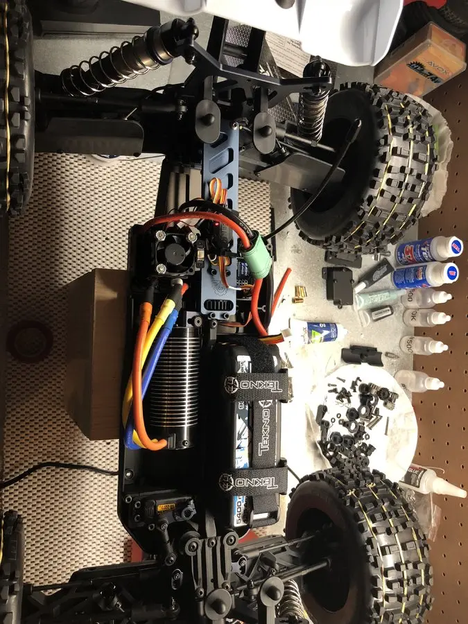

I took it out to bash in the park near me and the grass was still wet! Servo worked flawlessly at 7.4v. Here it is setup ready to go!View attachment 1452
View attachment 1453View attachment 1454
