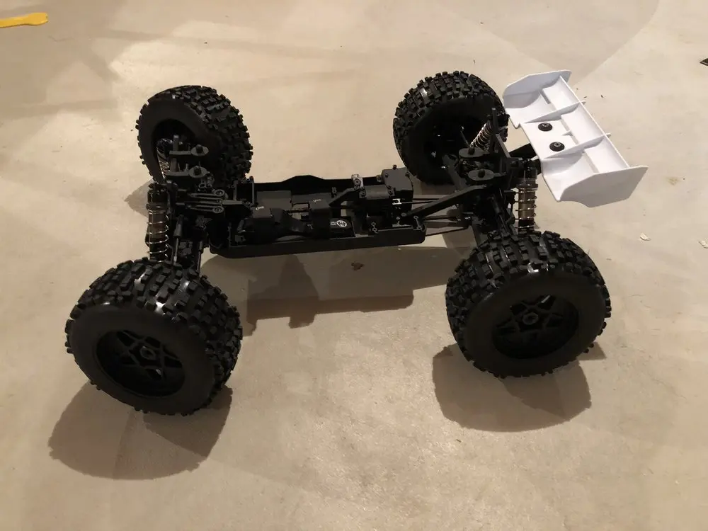

Annnnnnnnnd built!
Still have to purchase and add the electronics though. In due time. Next up is painting and decaying the body. Nothing fancy.

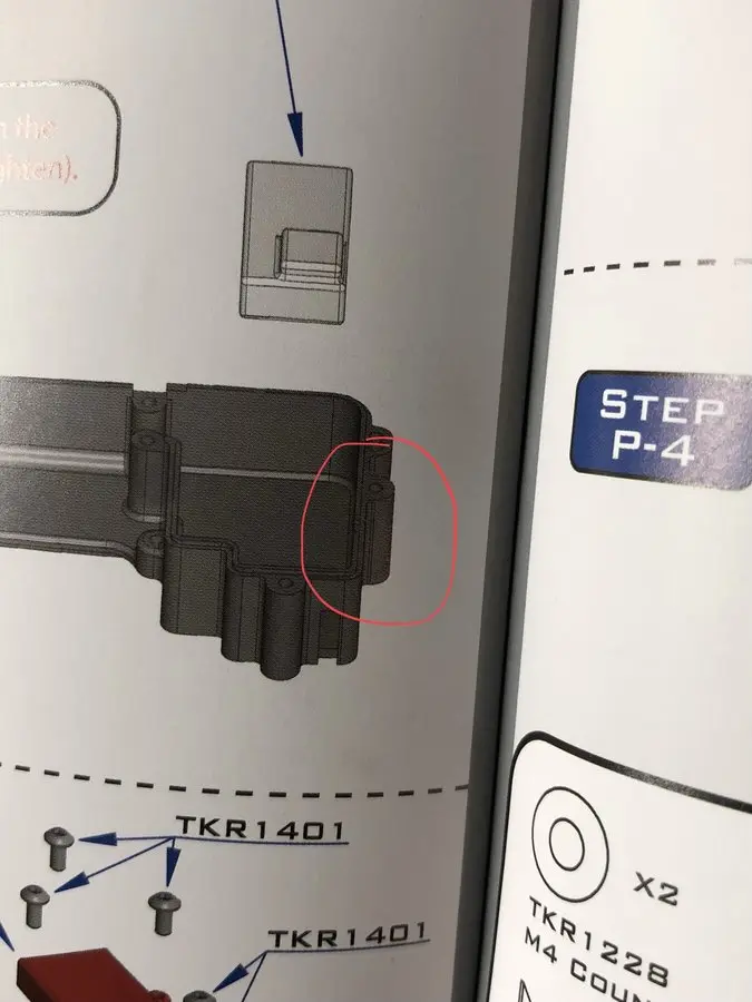

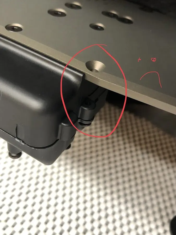

I did find one discrepancy though in the instructions or maybe it has been mentioned somewhere as not needed but take a look at the pictures below....
Notice how in the instructions it has plastic to screw in a screw? (See the red handy dandy circle I drew)
Now on the actual part there isn’t a place to screw in the screw. There is a hole in the chassis to do so but no where for it to latch on to. (Again, see handy dandy red circle and frawny face)
Am I missing something?
No you’re not missing anything. I had the same dilemma and found out it was a design change that didn’t make it into the manual LOL!
Awesome thanks! That is what I figured but wanted to make sure. Now I can sleep tonight! o_O

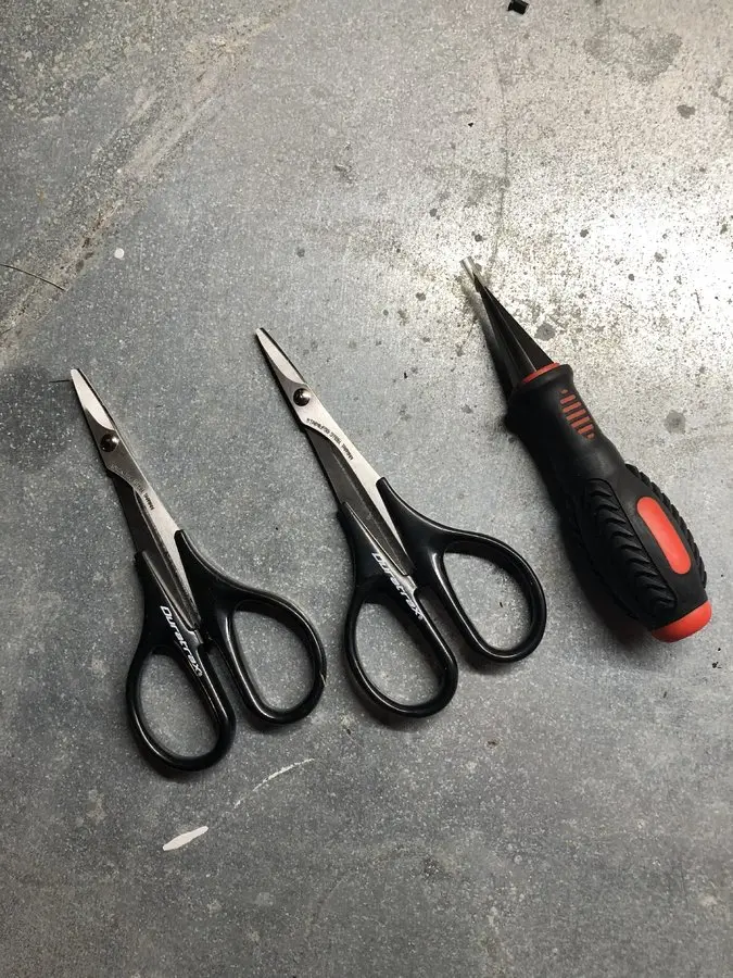

I just ordered scissors and a reamer and should be here by Friday. I’m going to try and get the body painted and decaled this weekend.

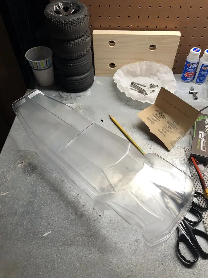

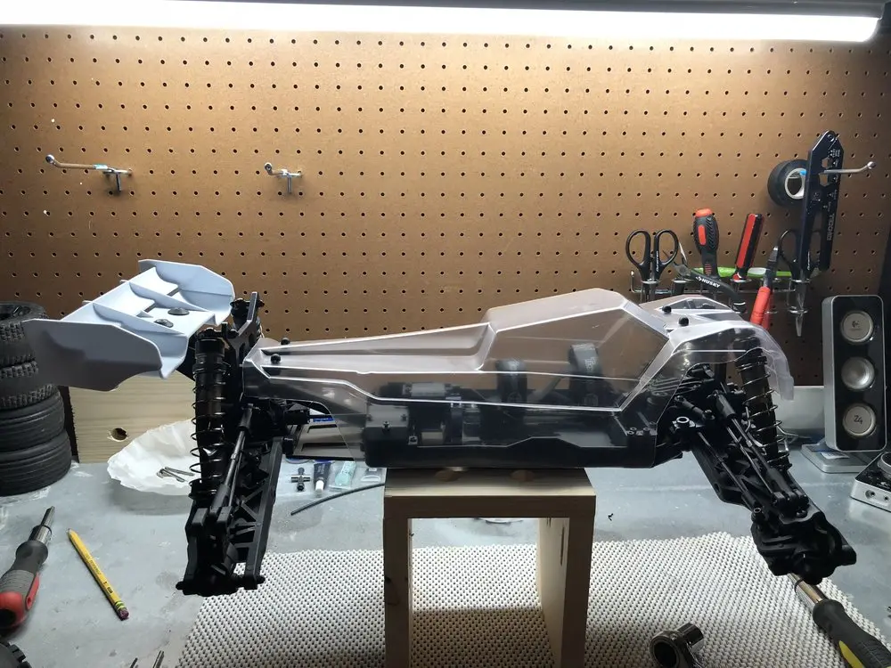

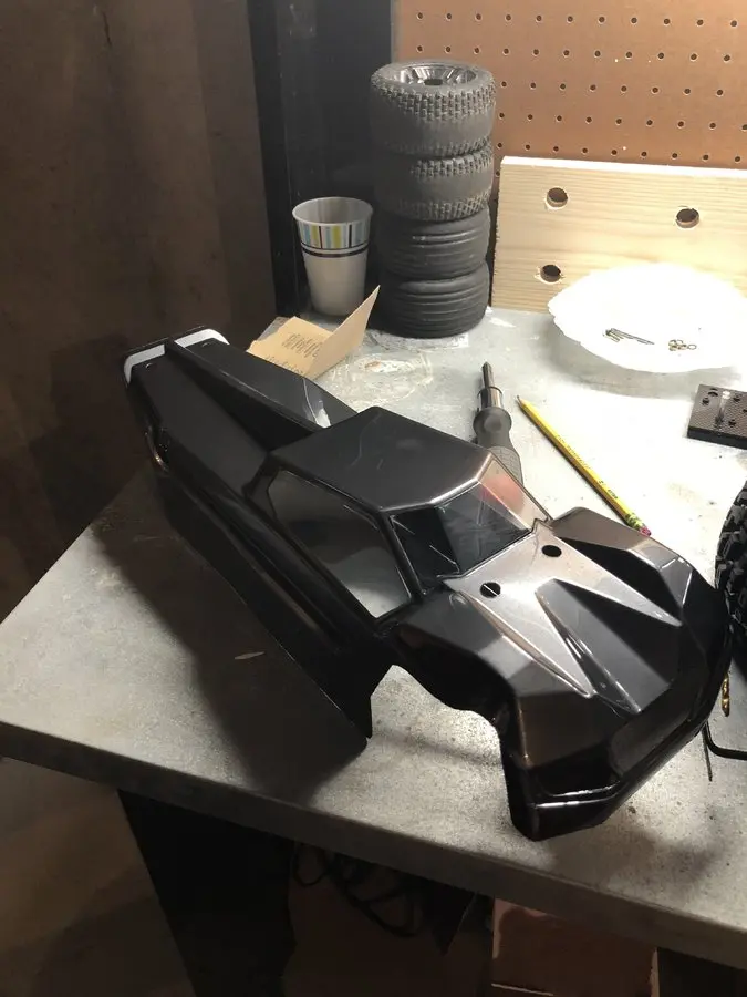

Body is cut!!

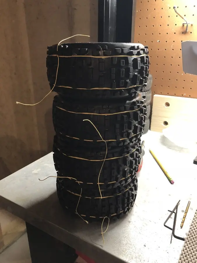

Started to belt the tires. I still need to dremel out the center parts and add the center belt.
Cant wait to see this thing in action!! Coming together real nicely @Slevin!
Thanks! @TBuggy!

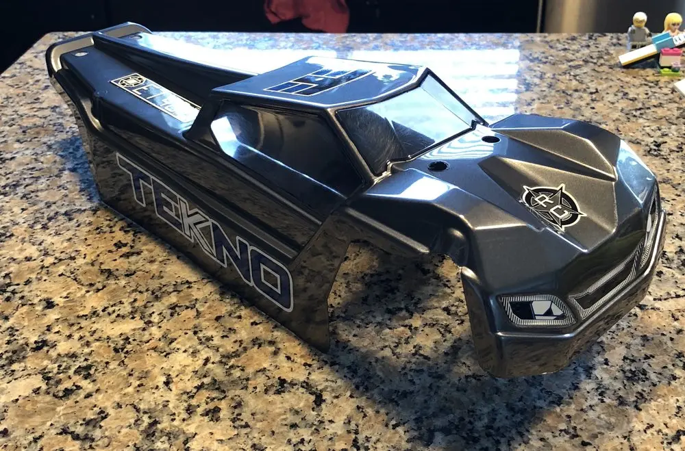

Here is the paint job. Nothing special. I’ll get a better picture tonight after I put the decals on.
And got some decals on it. Took a sharpie to the windows but it didn’t turn out all the impressive.
