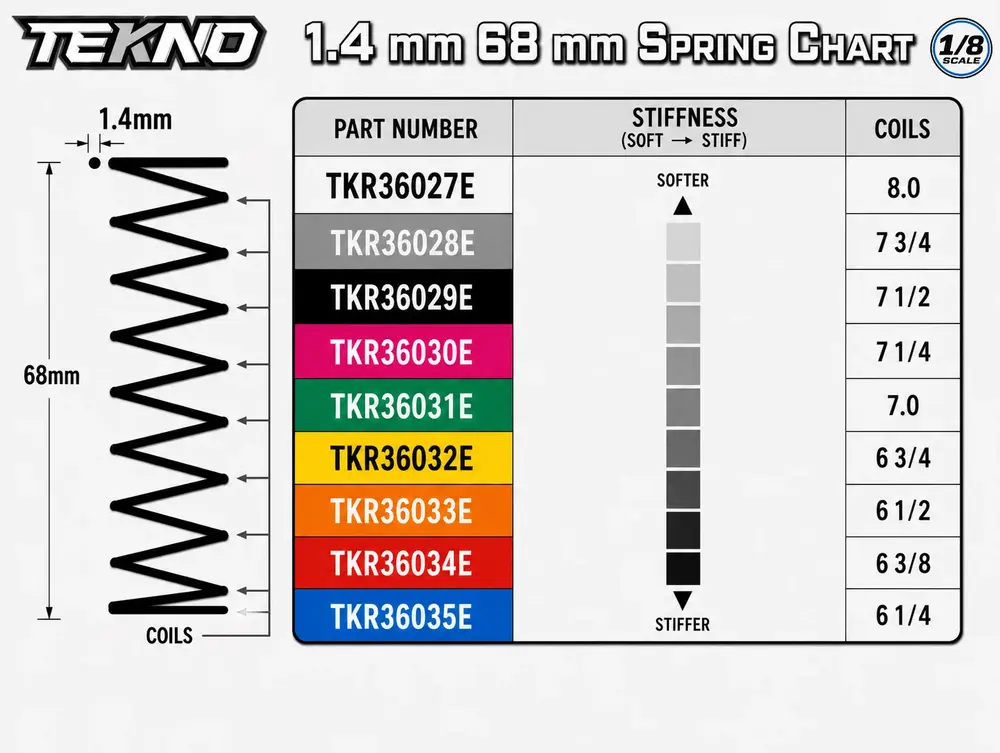

Looking to pick up a set of new springs and Tekno does not show the spring rates for their newly-released 1.4mm 68mm spring set for their "short shock" conversion. I ran some calculations and here's what I came up with:
Part NumberColorCoilsEstimated Rate (lb/in)
TKR36027EWhite8.04.18
TKR36028EGrey7.754.32
TKR36029EBlack7.54.46
TKR36030EPink7.254.60
TKR36031EGreen7.04.75
TKR36032EYellow6.754.89
TKR36033EOrange6.55.03
TKR36034ERed6.3755.10
TKR36035EBlue6.255.17
