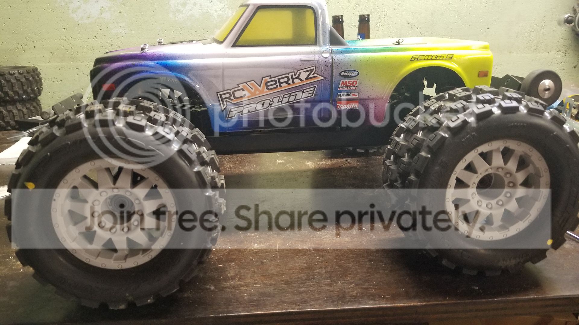

Even tho my MT410 is on the "fix me" side of the bench right now I threw some new wheels/tires on it Sunday morning before realizing my diff case failure. Back to old faithful for maximum chaos:D These have been in the package for a month and a half. About time to let em eat!!
