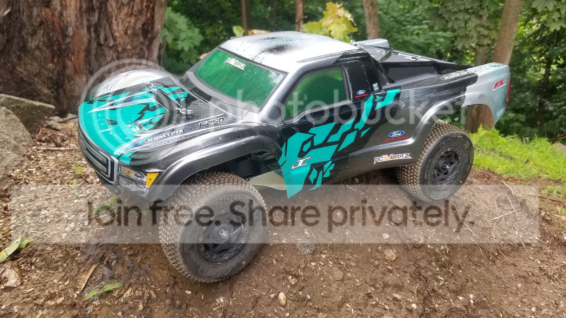

That new paint looks incredible!

Anyone who runs a Tekno SCT on loose tracks knows how bad they collect dirt inside. I took the J.Concepts overtray for the MT410 and did a little bit of trimming. I opened up the vent cut outs to let as much air flow as possible. Figured I'd try something else than the EB48 body or Dusty shroud. Find out how well it works this weekend.
That looks like it would work just fine. Definitely more roomy inside than the buggy body.
Worked out great! Not really any dirt inside the chassis whatsoever. Heat was also a non issue. Motor was 130F
