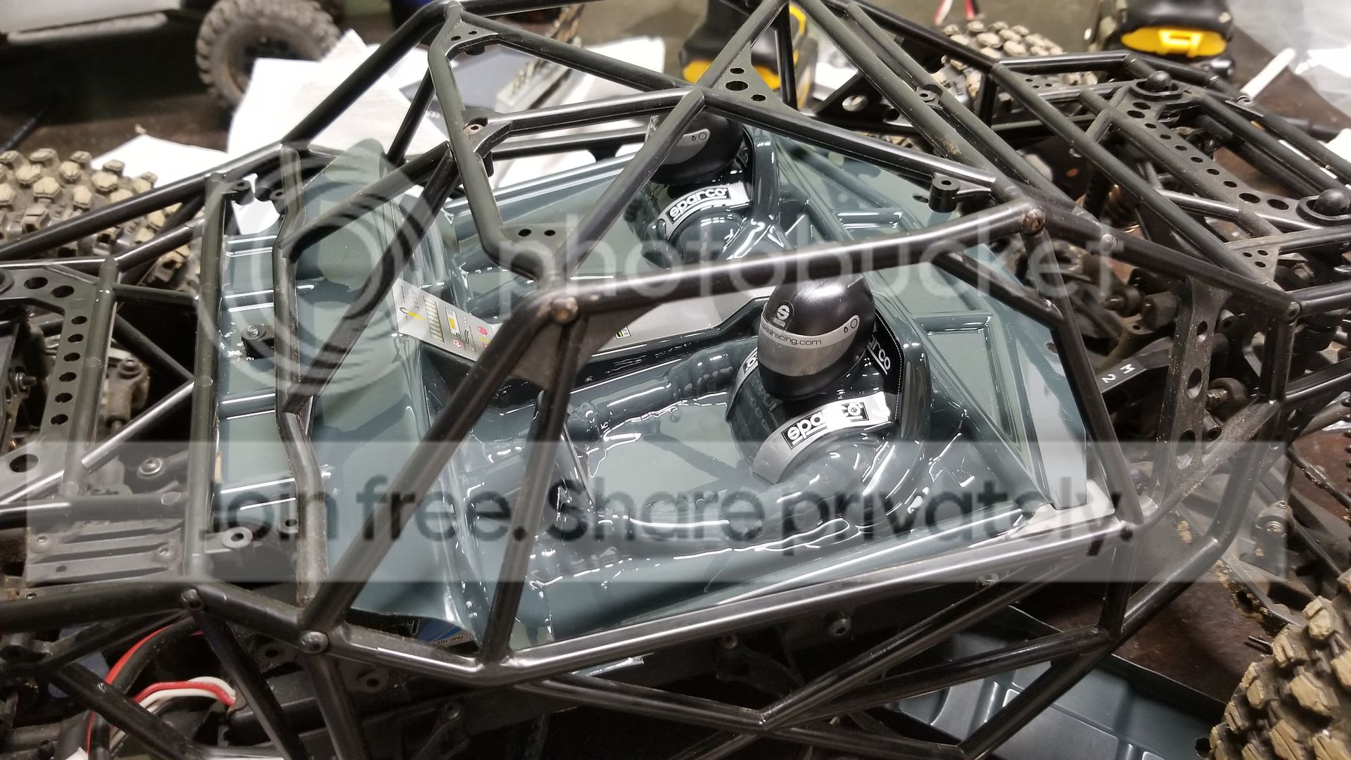

Yeti Score TT interior as a fill in til the Nomad ones are available or possibly permanently. Not 100% sure yet.
Needs a bit of trimming as it's about a half inch too wide. Screwed down the front and used screws long enough to stick out of the cage where the side panel mounts to hold the rear up. Still need to trim the mounting holes off the rear, but you get the general idea.
Looks like it will work just fine. The option that chainsaw suggested is pretty good too. Not sure what I’m going to do yet.

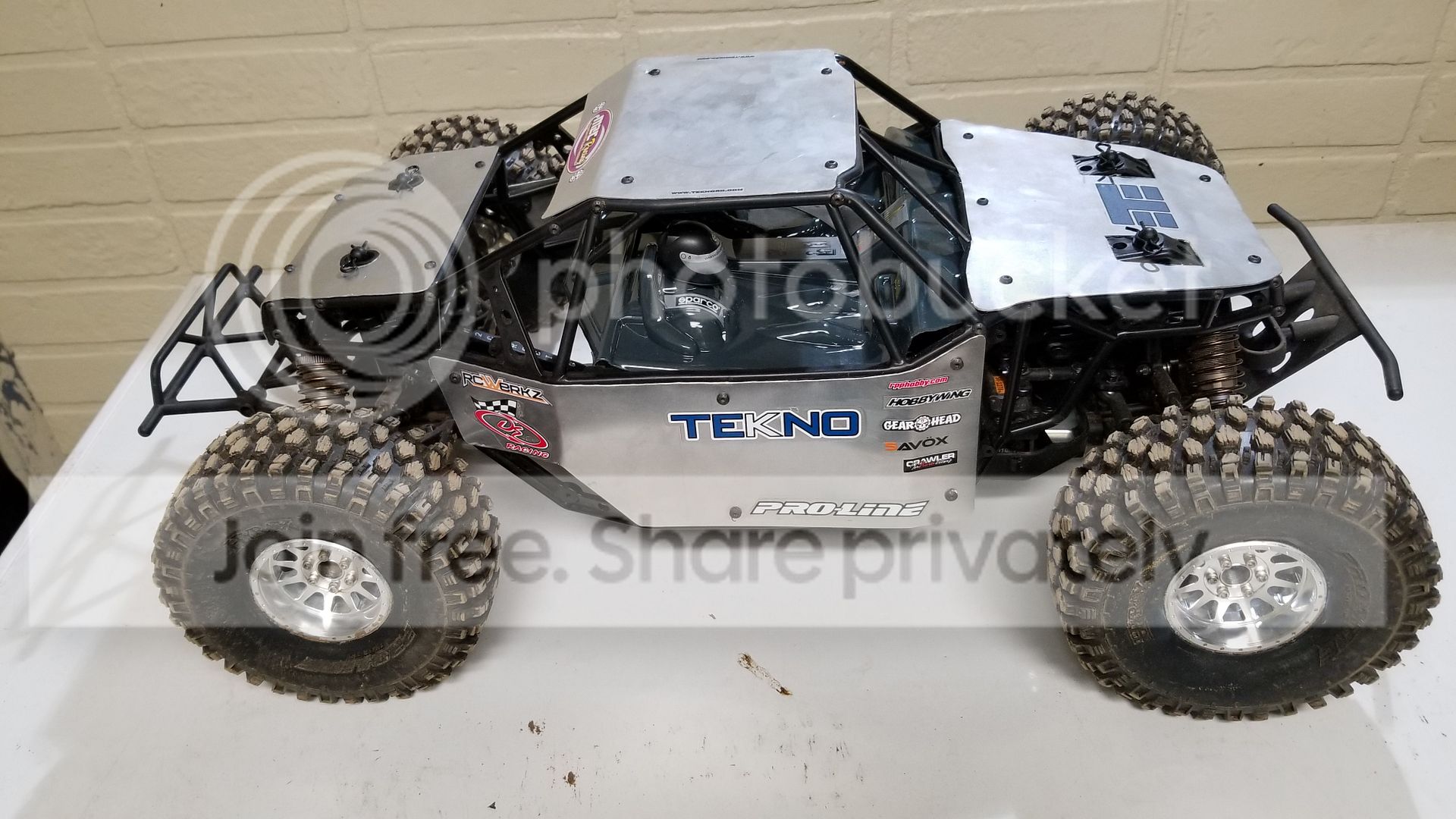

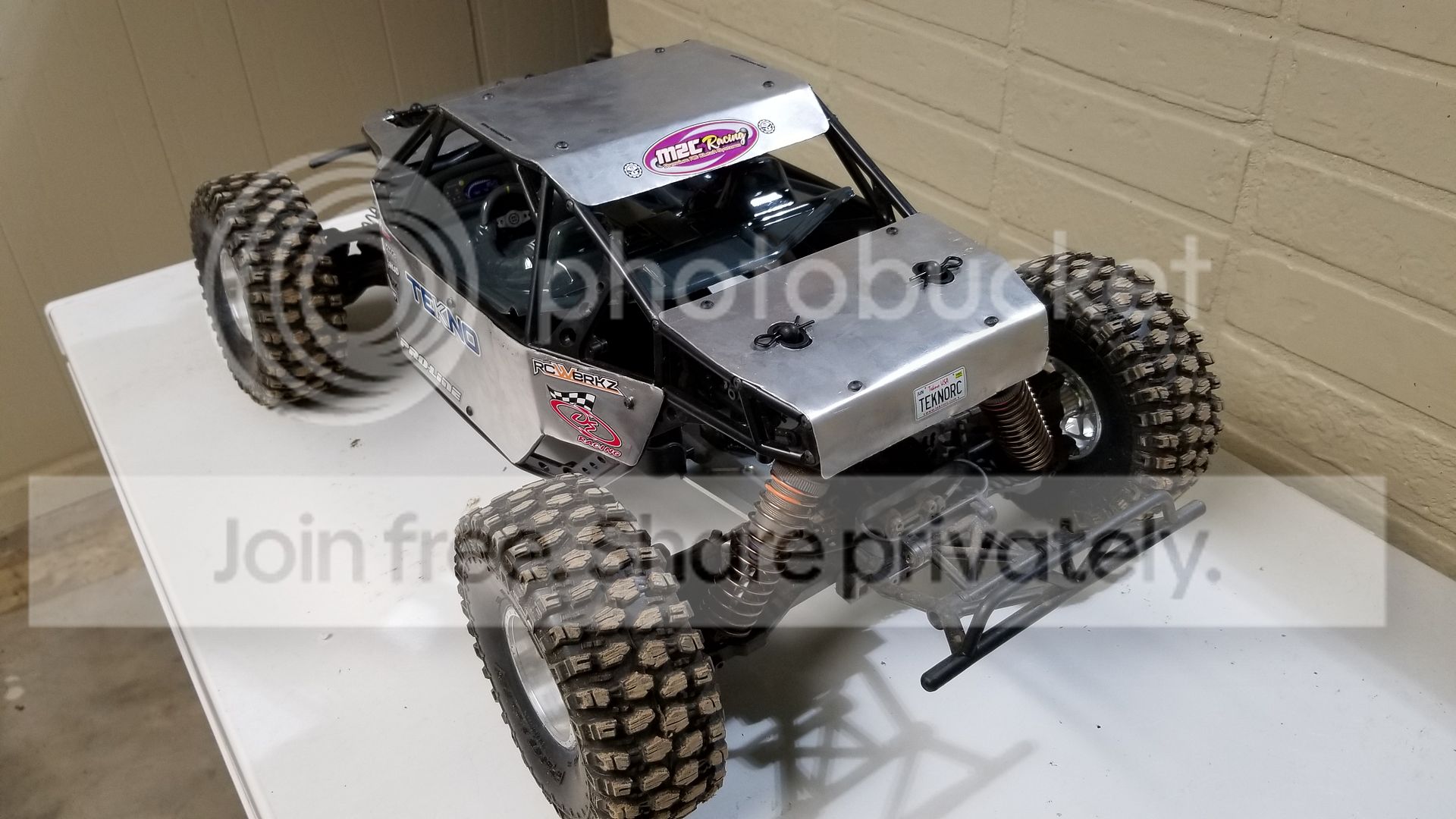

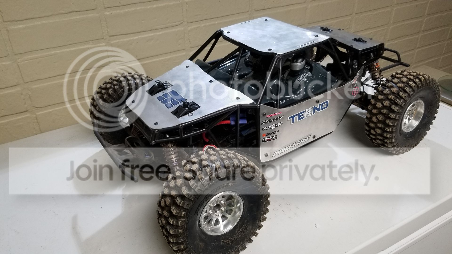

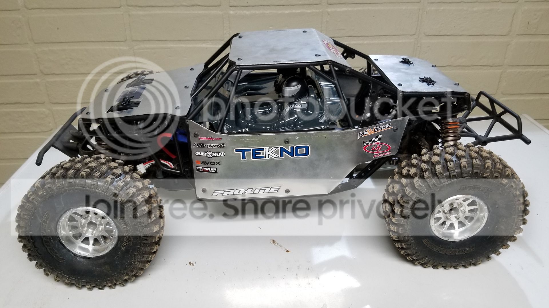

Well I'm not completely satisfied, but I gave it a valiant effort over the last 5 and a half hours. Came out OK, but I would really love to have something produced for aluminum panels for the Nomad cage. I still may order the lexan ones for options. I wanted to leave some cage visible and may do some front panels, but for now it's good enough:)
Just waiting on some VP 5mm wheel nuts and I'll be ready to rip.
It weighs in at 8lbs 8.8oz RTR with the panels, driver, and 3S lipo. My guesstimate was pretty spot on and I was able to keep it under 10lbs.

Yup Panels turned out awesome. (y)(y) Forming panels and cutting them sucks, is time consuming but usually 9-10 times well worth the effort. Massive billboard, custom and looks so much better than lexan.
Thanks buddy. Not sure I'm sold on them yet cuz the imperfections are driving me a bit crazy but once they get banged up a bit I probably won't mind so much;)

Bam! Looks really nice! I’m going to steal the design of your hood. Did you use a drimel to cut out the rectangle slots for front posts?
Steal away:) Yeah I used a cutting wheel on the Dremel. Didn't really have any other ideas on how to cut them. Thanks man.

I am struggling mounting the cage I removed the stock 410 mounts and got nomad body mounts. I know I have to trim them down but both front and rear are to far apart. How did you fill the gap sir
I didn't use Nomad body mounts as they are unavailable last I checked. I used HPI body mounts from the Apache SC. I ended up spacing the rear with another set of shock standoffs and used a few 3mm nuts to space the front. I'm not exactly sure how the Nomad mounts would space out but I'm pretty certain you could make them work in the same manner.
