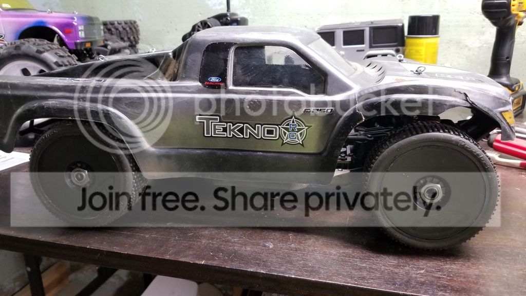

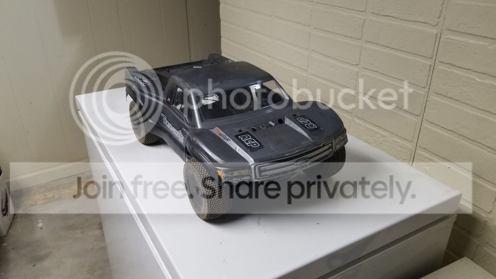

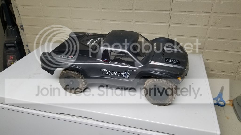

Here's my new to me SCT410.
Running the HW SCT combo with the 4300KV motor, Savox Ty Tessman servo, currently geared 16/44.
Pretty much just running the Tekno recommended setup sheet.
It has aluminum diff cross pins, aluminum hexes, aluminum A & C blocks, aluminum hexes, HRC hubs, .4 ackerman and bell cranks, shock pistons are drilled to 1.4, DE Racing rear skid, and I just did the M2C Racing ZRS shock caps. PL Holeshots installed at the moment.
I will keep updating as I upgrade, but here's some pics.
