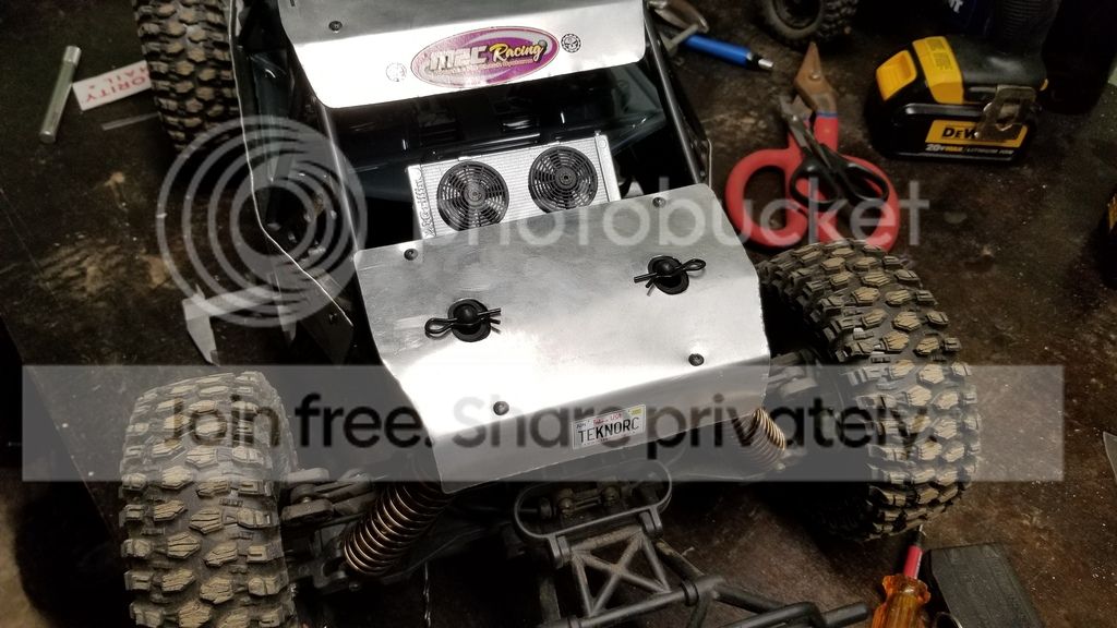

So I put a little scale touch on tonight. Kinda stole the idea from DMG. They actually make a mount to put the EXO radiator on the Bomber so I figured it was do-able:)
Hid the mount under the back panel so it's not visible. Threw some silver paint on the radiator core itself to break things up.
Looks great!

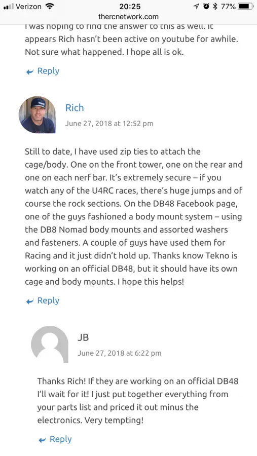

Rich from thercnetwork.com told me today that Tekno is actually making an official DB48....
I asked him last night about a release date and Tekno told him around end of 2018 to early 2019.
I would love for this to happen. I will wait before buying up a sct kit and moding it and if they don't release one then I will just mod one up. I just love the look of this thing and it's reliability compared to the other brands. The losi rock rey seems to be meh and I've read so much on Axial's crappy support. Maybe I'm wrong but I did just return a yeti xl that just had so many issues.
