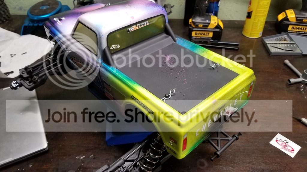

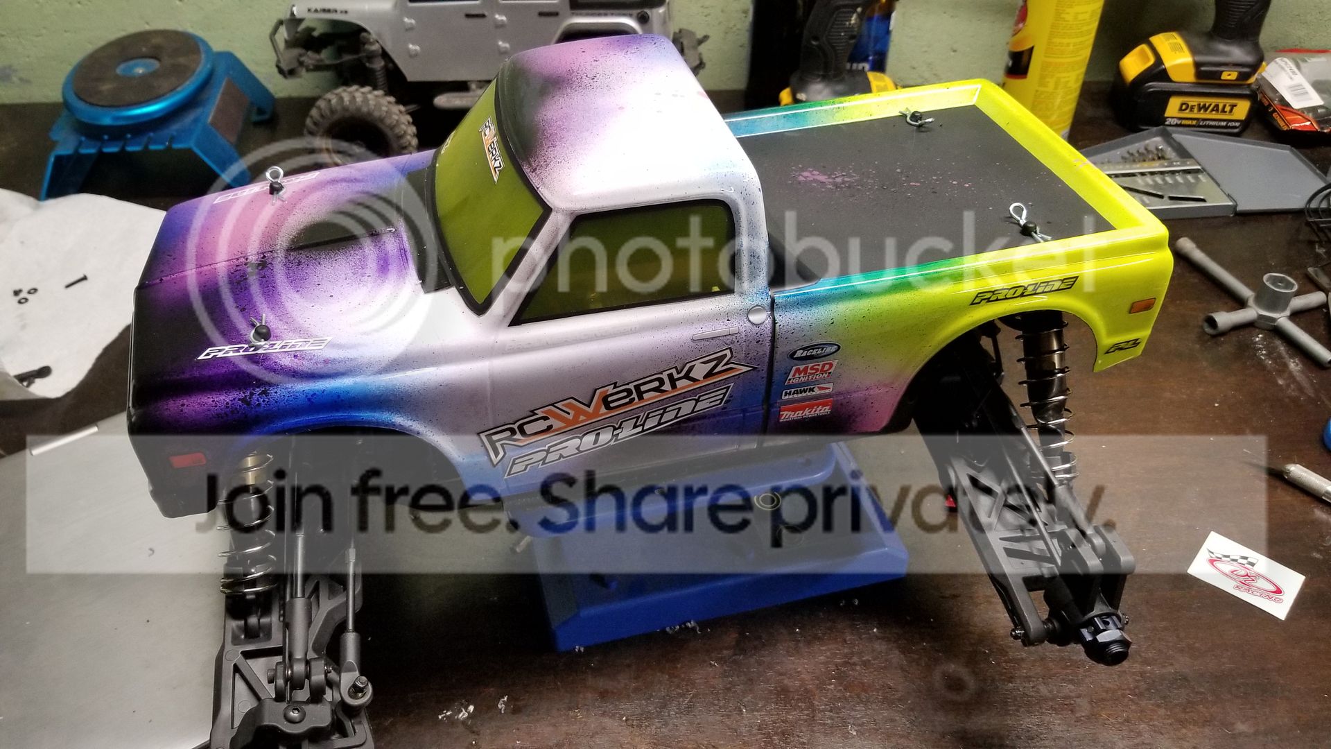

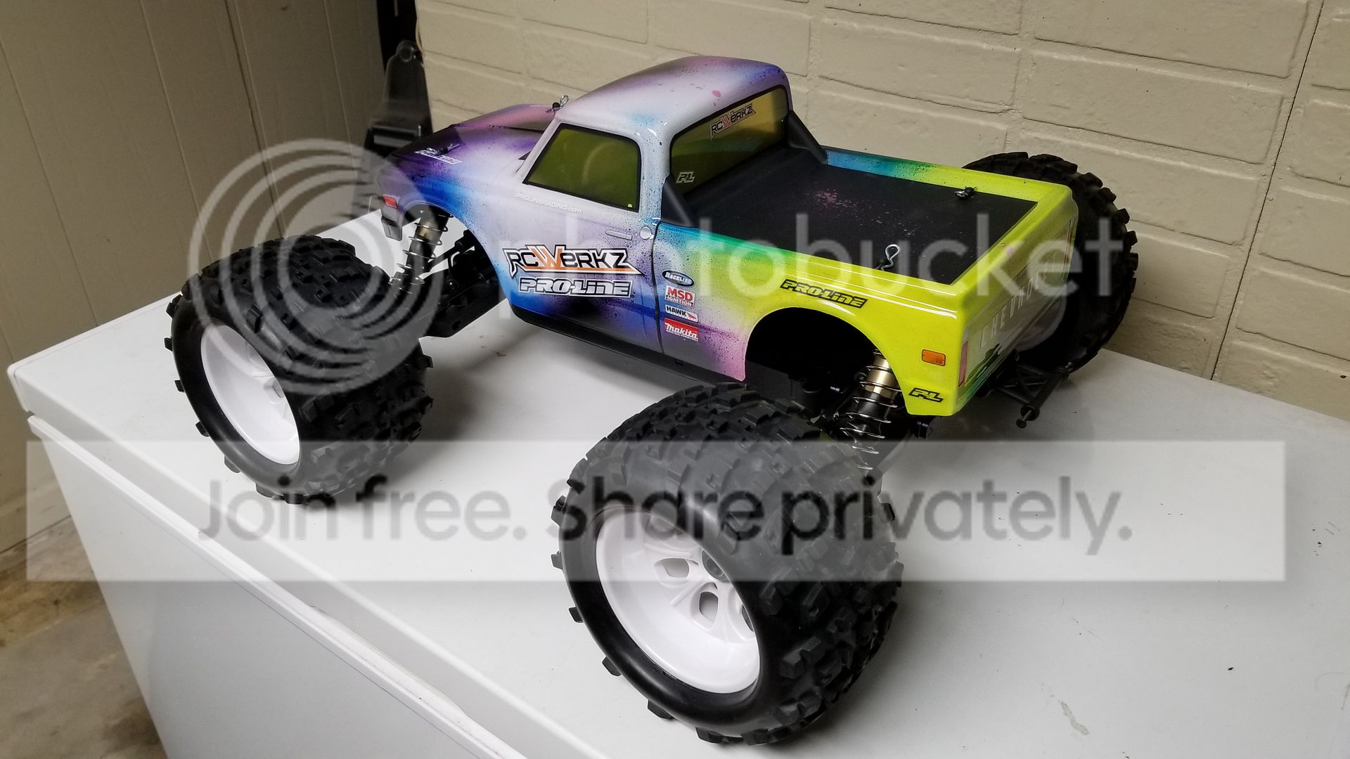

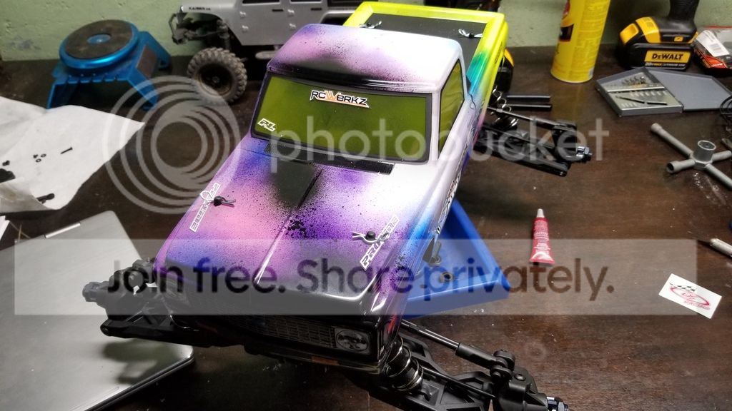

Was gonna give up for the night and move on to something else, but I figured why not mount my body:unsure:
My buddy Oscar aka RCWERKZ hooked me up with this one. The pictures don't even do it justice. It's already reinforced and ready to go too.

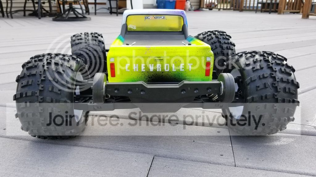

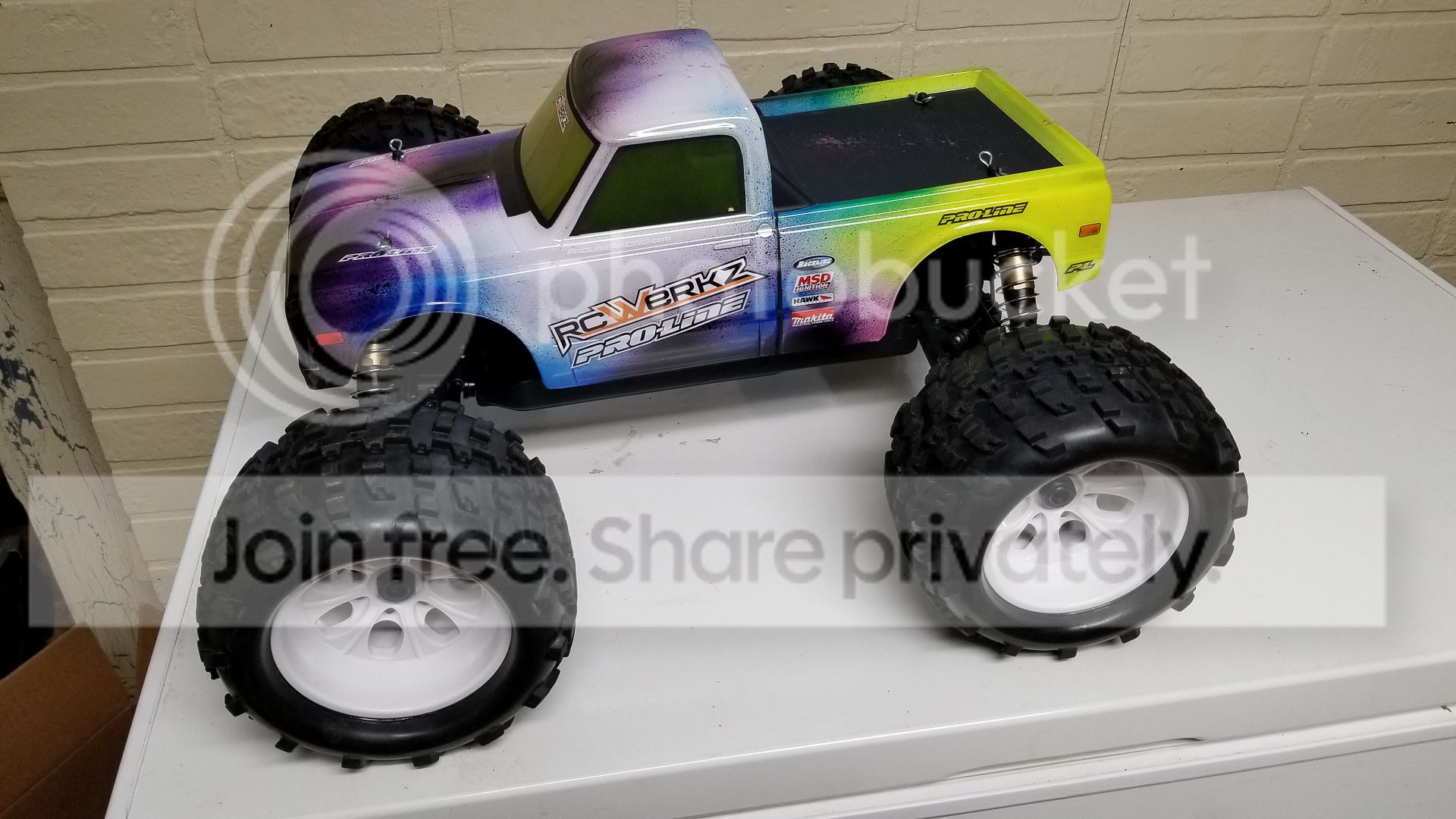

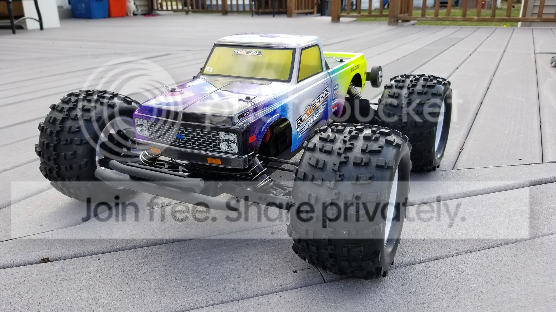

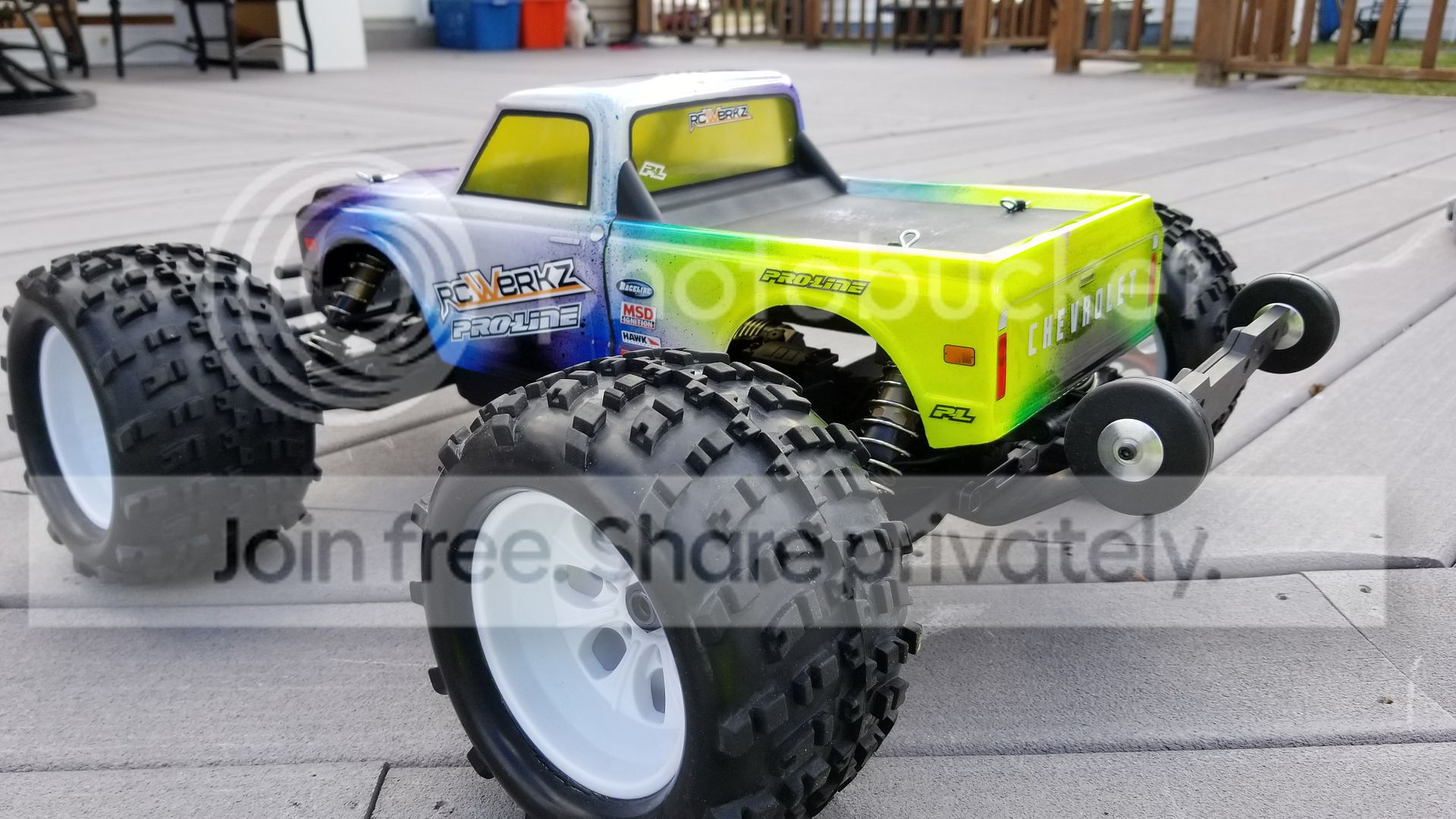

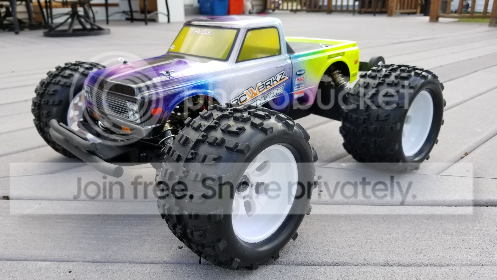

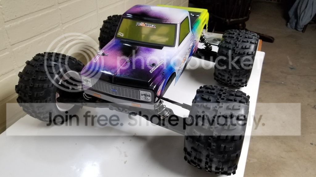

First time with wheels/tires on it. Everything is operational and the finishing touches should be just about done tomorrow.
