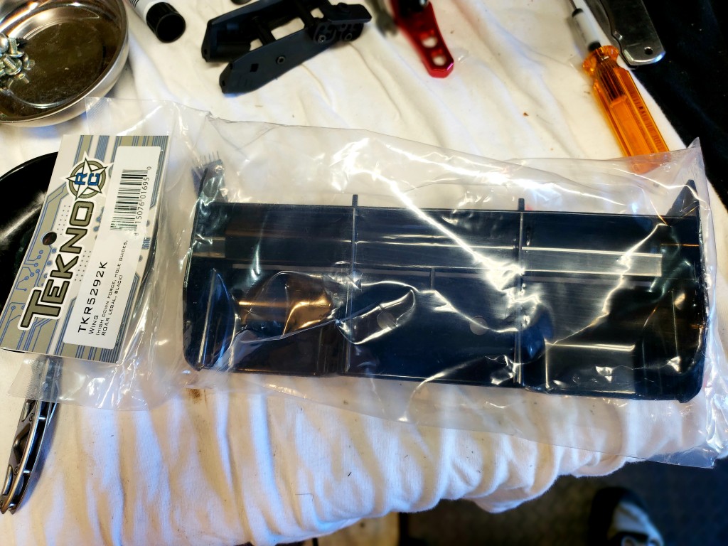

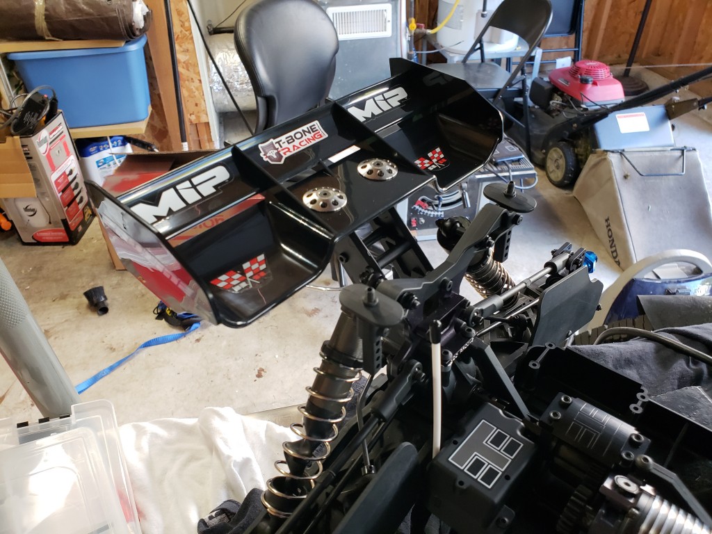

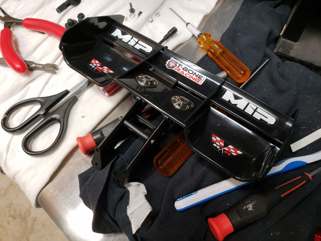

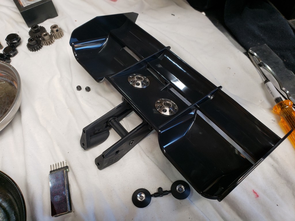

Finally something new. Decided to see how a wing would look.

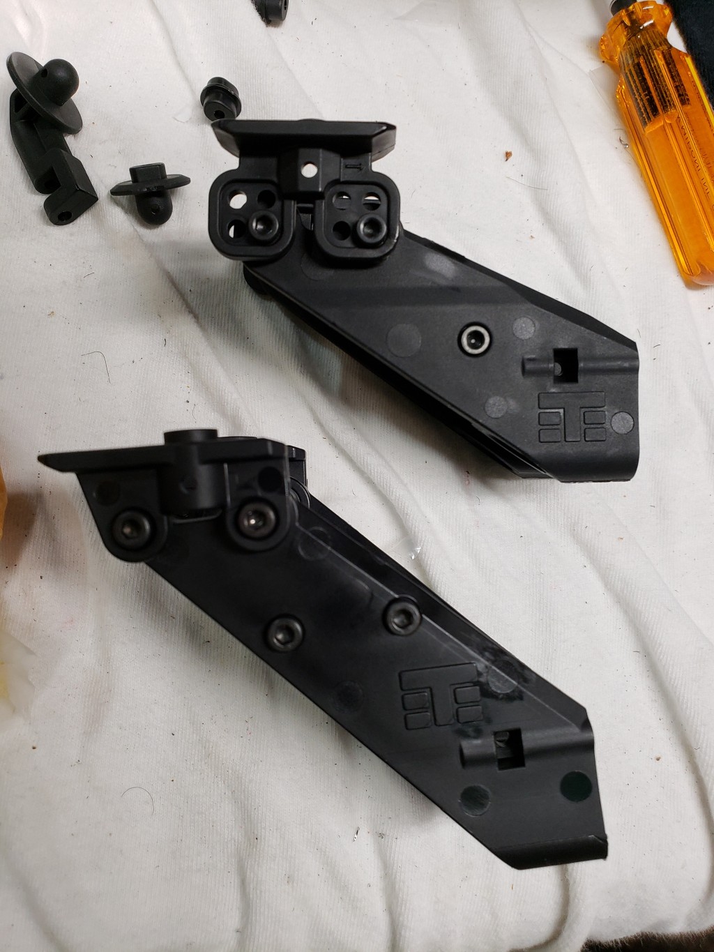

I didn't realize there was a v1 wing that mounted higher. Unfortunately I didn't discover this until I already bought the current one that will put the wing down too low to clear the body. So the old v1 mount is on the way.
The wrong mount.
Wing showed up a few days late after USPS sent it to the wrong city.

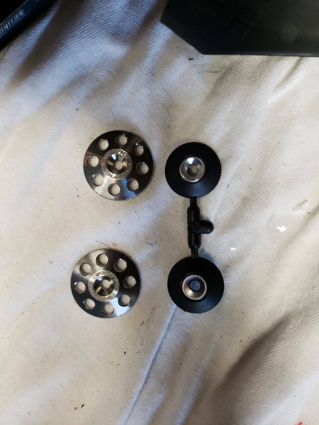

Exotek XL titanium buttons vs stock Tekno.
Assembled for kicks

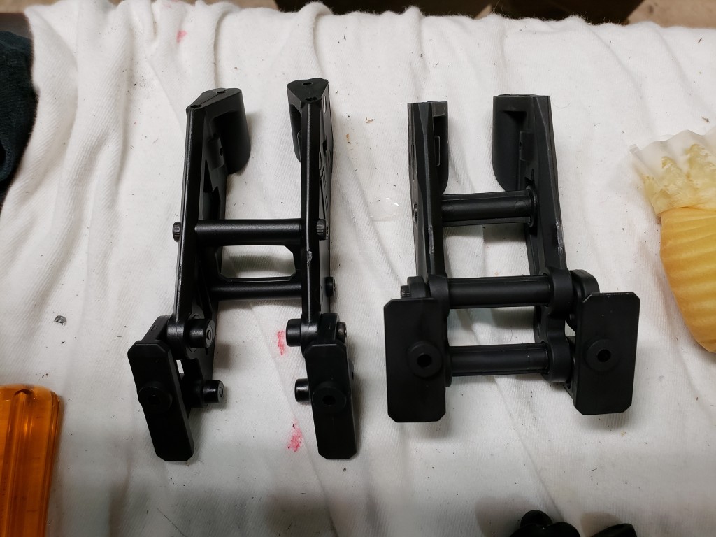

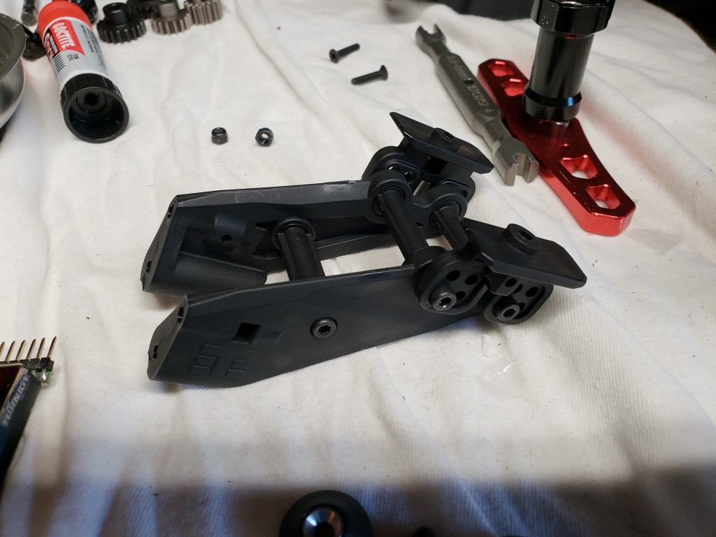

The v1 mount arrived.
V1 vs V2: You can see how the V1 is higher. The V2 seems to be designed a little beefier though.
Wing and speed stickers on.

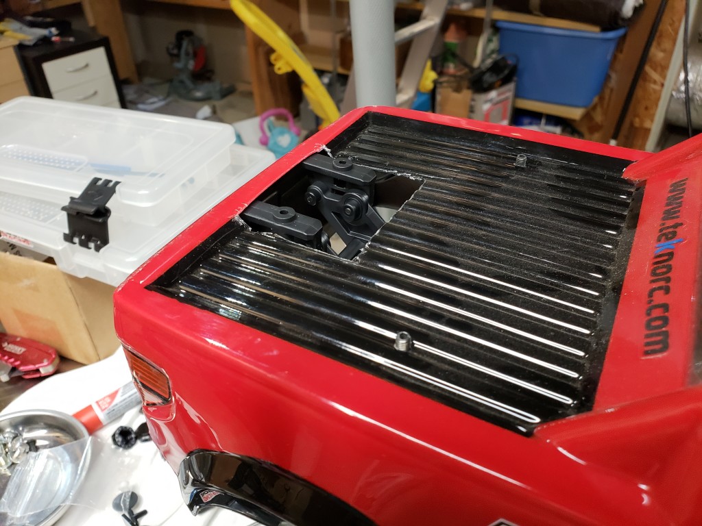

Next step is seeing how much of the body I need to hack up.

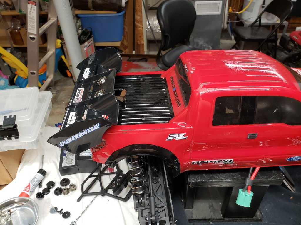

I cut a small section out of the bed to try to get this to fit with minimal modification to the body.

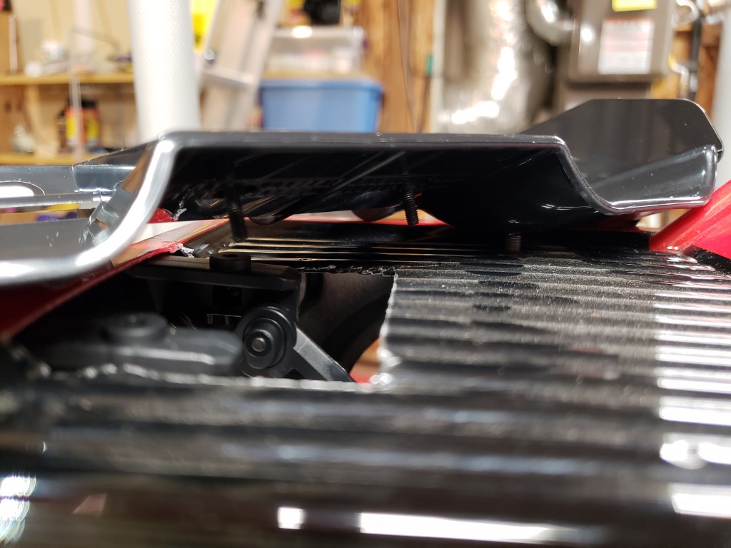

Unfortunately the body is up high, the wing still needs a lot of clearance to sit down on the mount, I'd have to hack away half of the truck bed. I may abort this mission for now.
The good news is that the mount fits perfectly under the body and will act as a hidden bumper!
