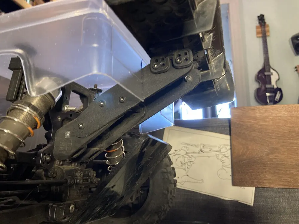

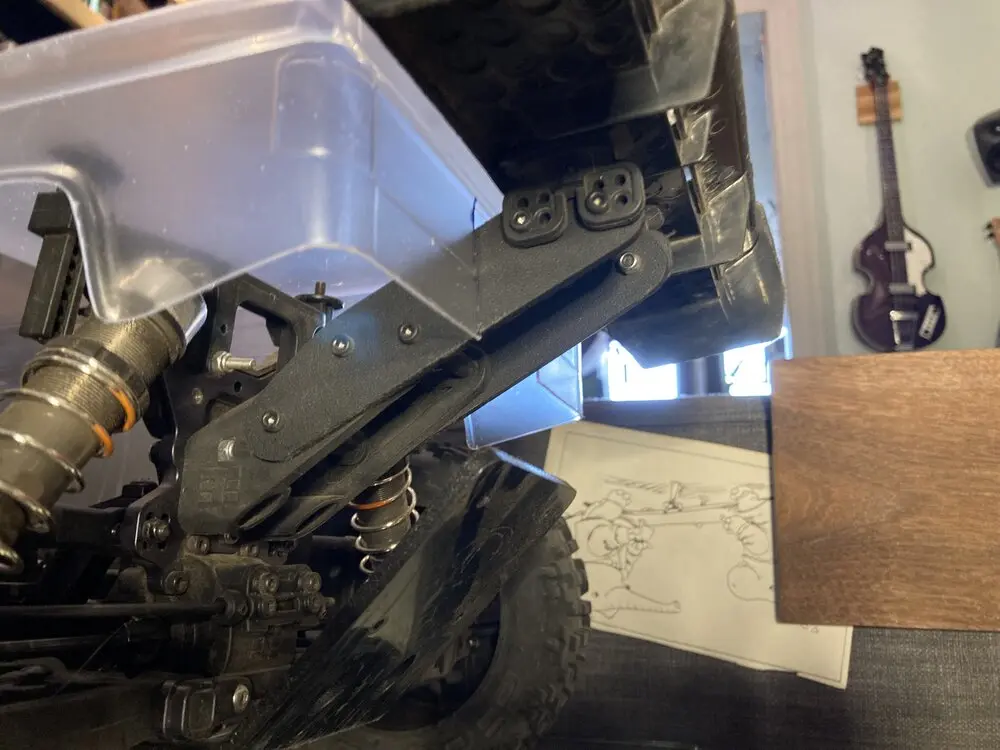

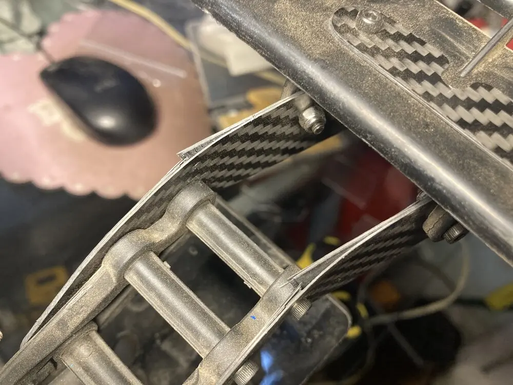

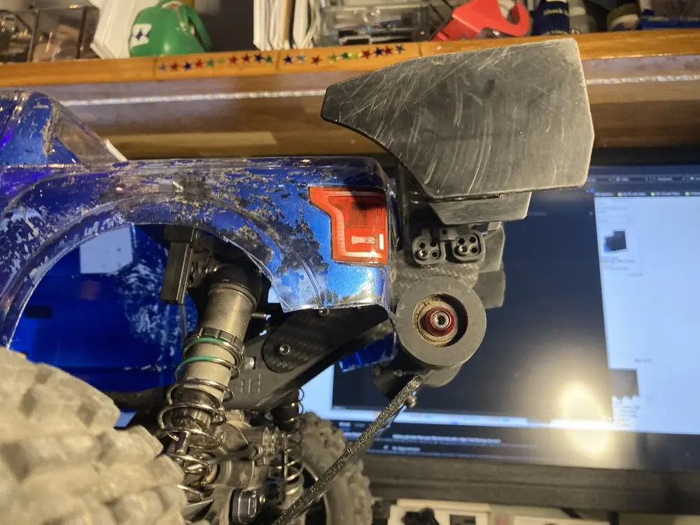

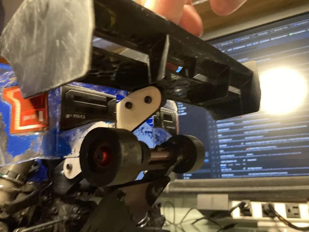

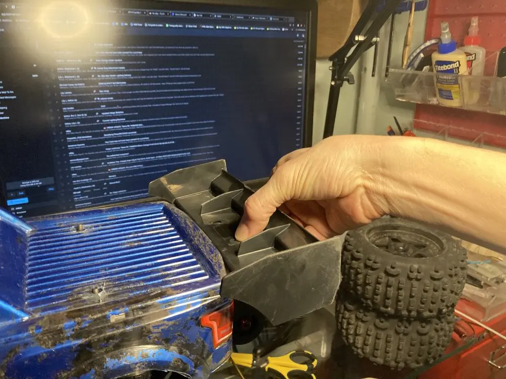

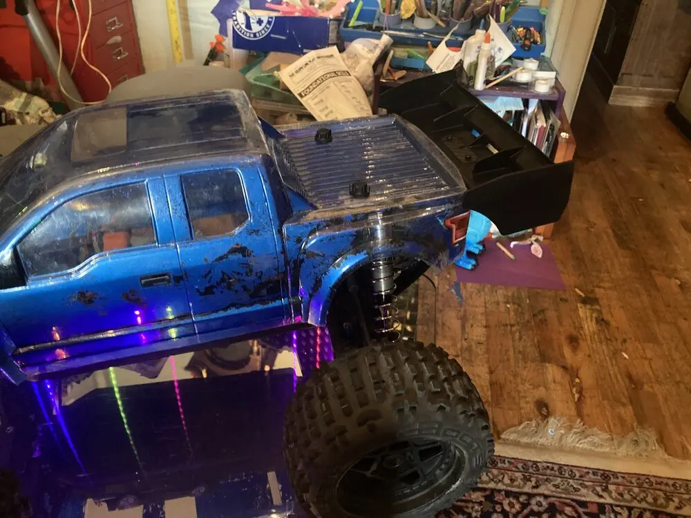

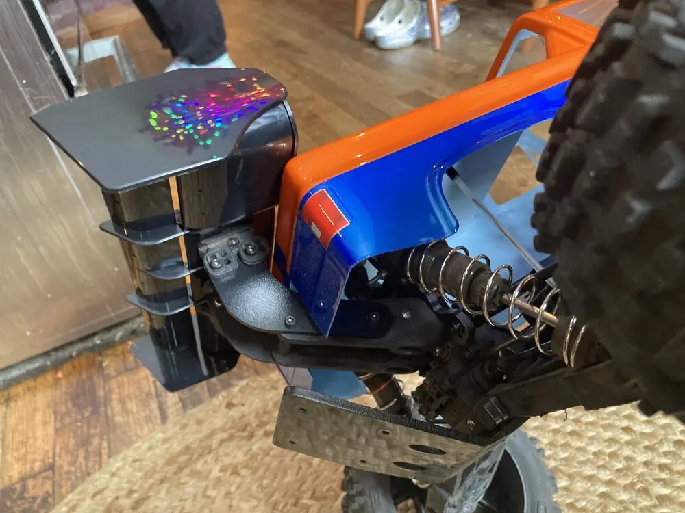

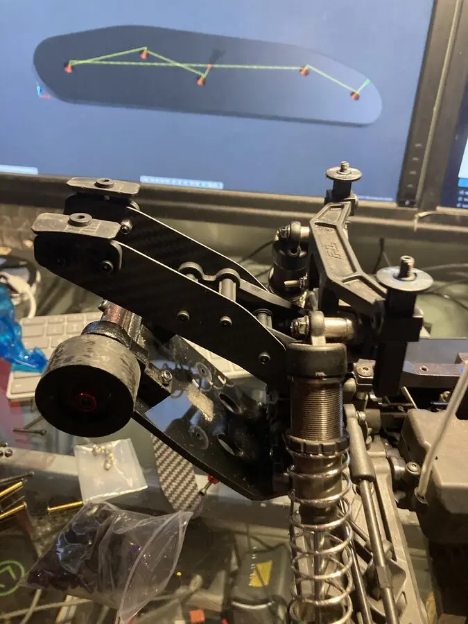

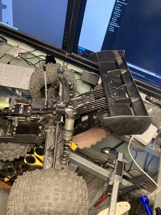

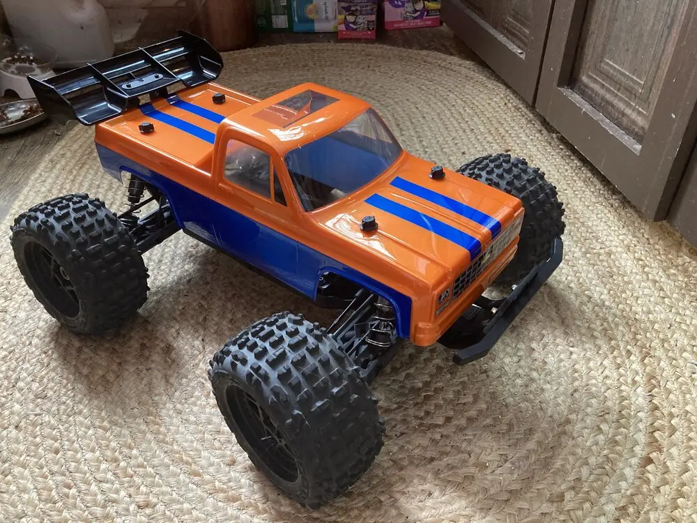

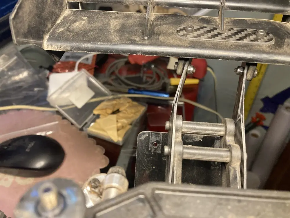

Decided to try and put a wing on my new (to me) MT410 (original size). I'm not really a fan of the look, but I added one to my Granite last year and the protection it offered to the rear of the body was well worth it. I know folks have already documented this here, but I wanted to mount a wing without cutting off the entire tail gate portion.
I used the low profile wing mount and added some custom made CF plates to position the wing right where I wanted it.
The wheelie bar in pics has been removed as it's not necessary with the wing in place.
The body is what came with the truck (from eBay) and appears to have been painted with finger paint, so try to ignore that for now.

Wait so the low profile wing mount does work with the stock towers?
Yes it attaches no problem to stock tower, but it's not long enough for a truck body to attach without cutting the tailgate off.

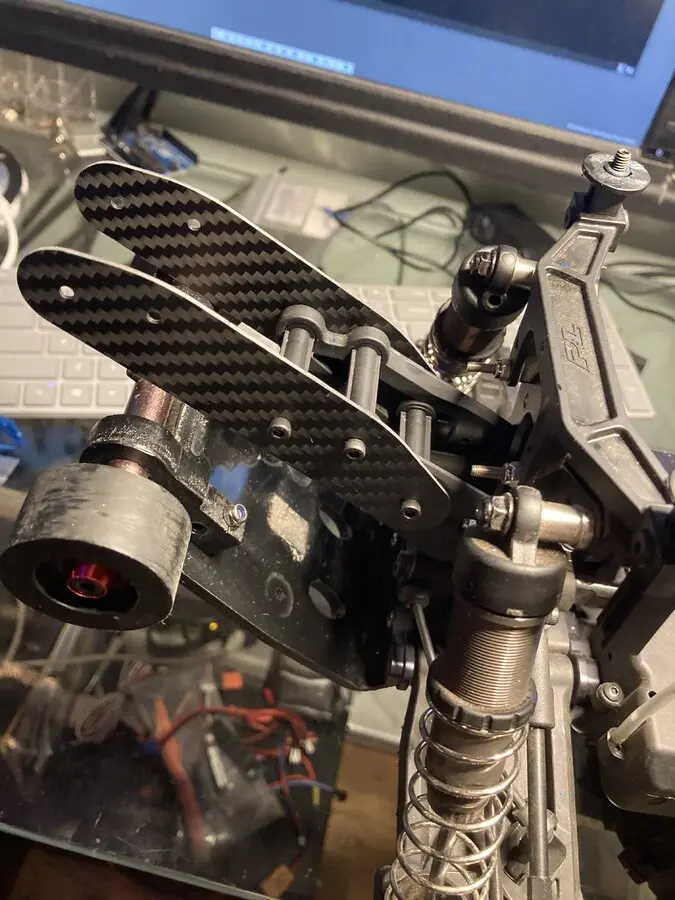

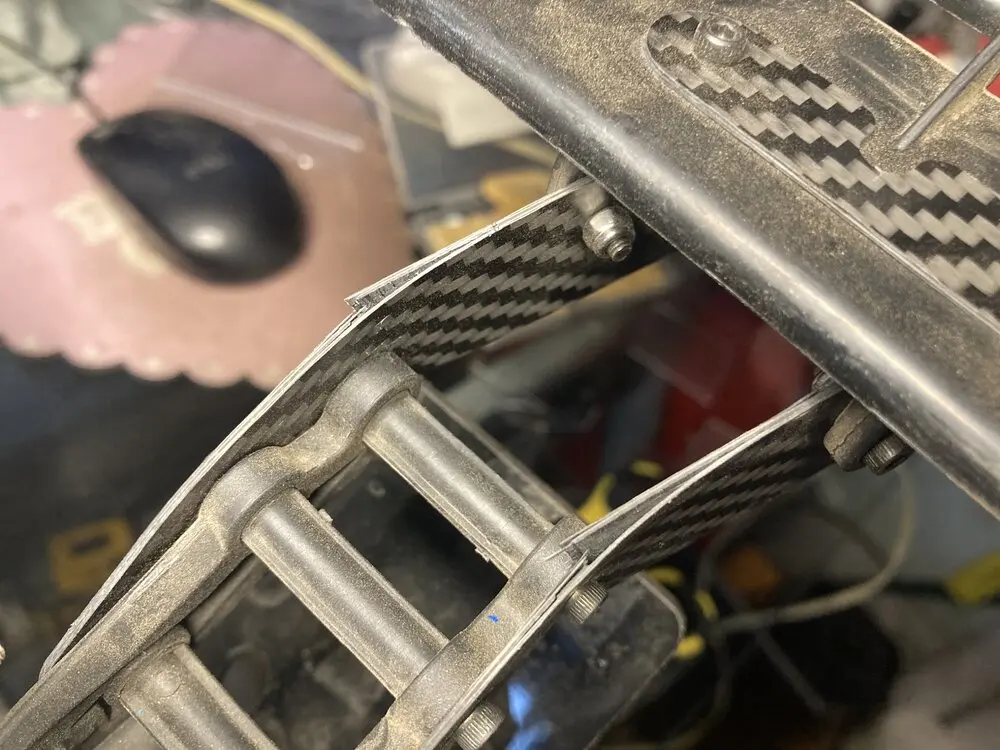

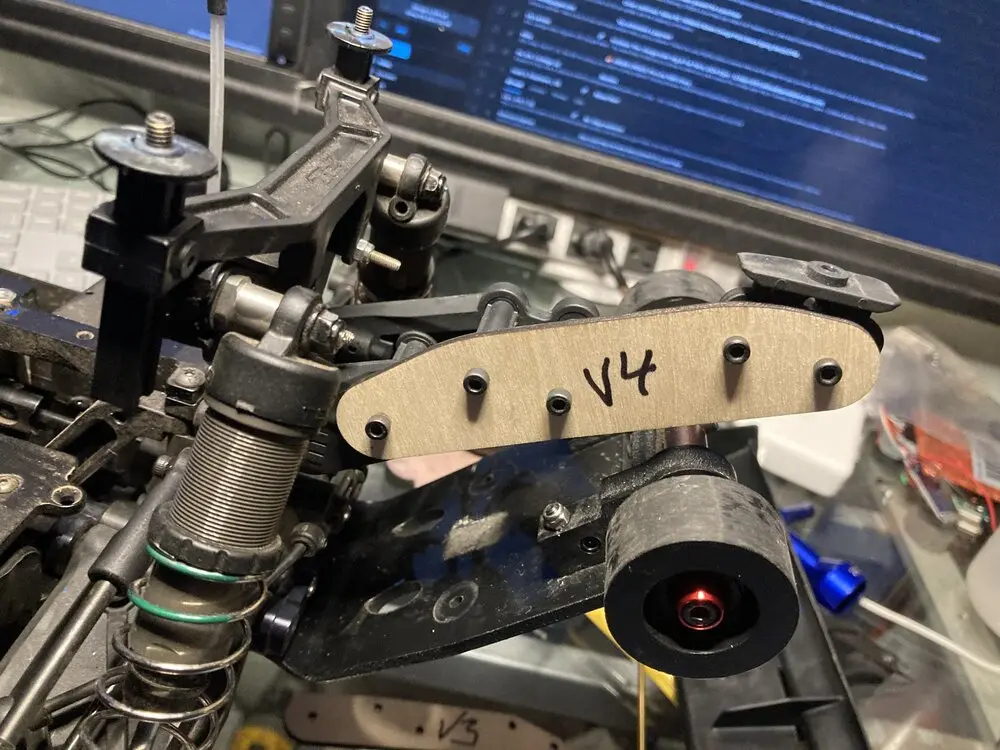

Things were great for awhile, but after planting the rear end off a 7' jump... maybe I was a bit optimistic using 1mm carbon fiber for this...

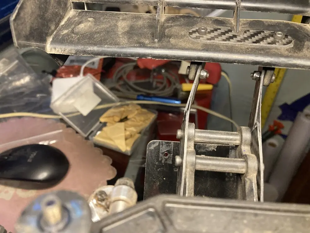

Milled a new set using 3mm Kydex and will report back how it holds up.
Took some big hits today, and the .125" Kydex held up no problem.

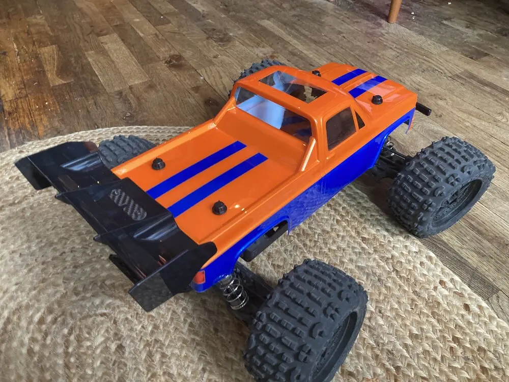

Here's a pic with the Kydex extensions and a new C-10 body almost ready for paint.

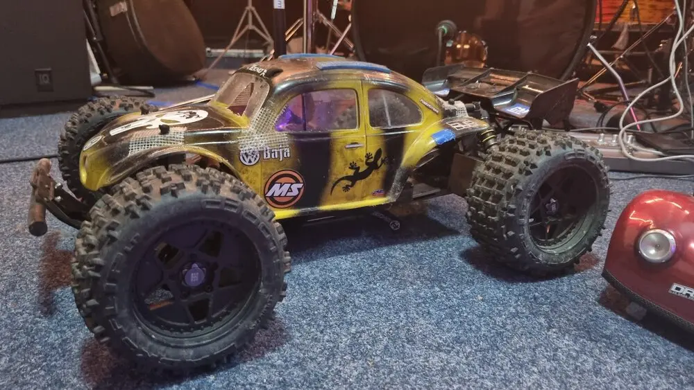

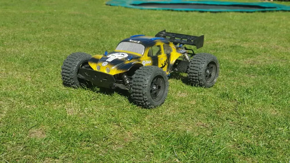

I use the low profile wing mounts and it fits perfekt!
But I use a Beetle body with LWB Chassis ;)

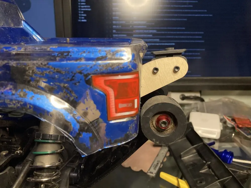

I will probably tweak the wing H and V position when I decide on a final resting place for the C10 body, but it definitely needs to move back some and up some from stock positions

Nice job, looks factory!👍I too enjoy the body protection a wing adds. Only downfall is the tail landings..
