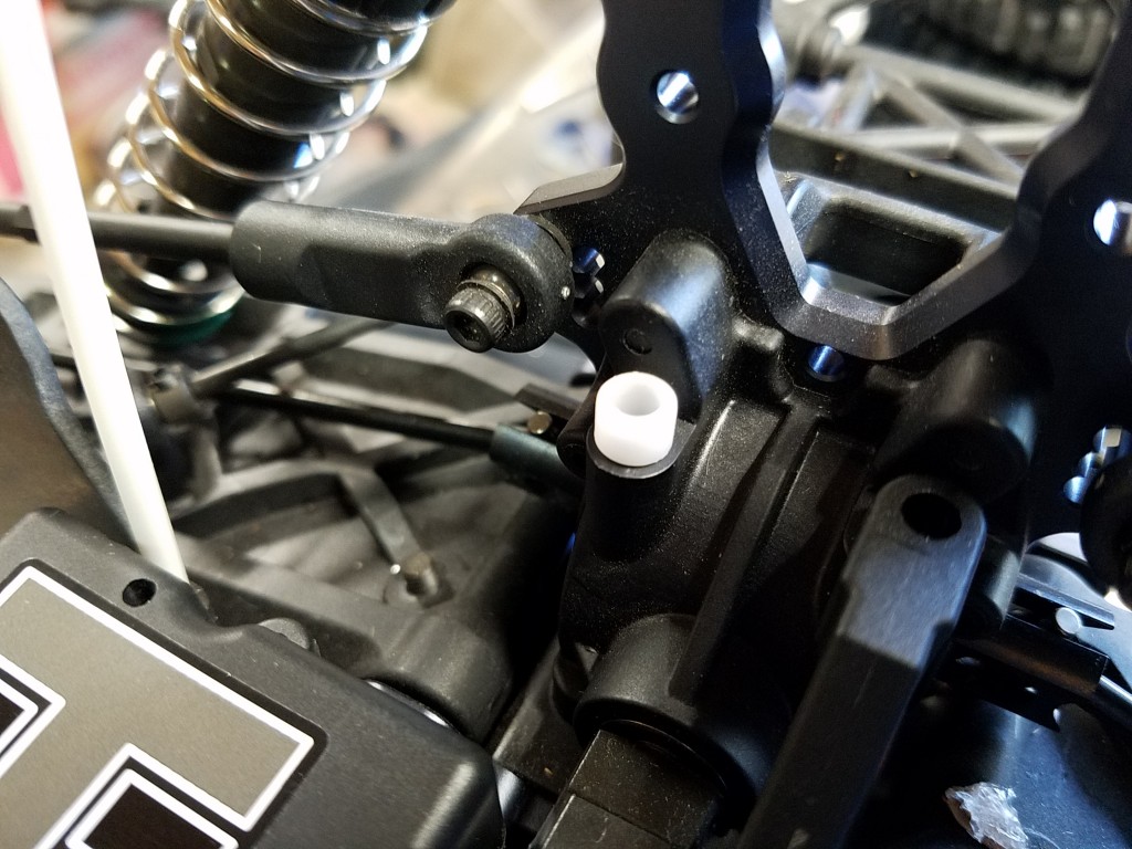

They actually used to come with an aluminum spacer before the delrin ones.
Interesting... I wonder why the change, hard to believe it would be a cost savings if I can buy 50 for $6...

When I received my 2nd one for the ET i was like what is this plastic thing?!!:ROFLMAO: I ended up reusing the aluminum one.
I would have too for sure. I went ahead and grabbed the bag of 50 of the alum ones I found on ebay, hopefully they'll fit perfectly. it'll be nice to have 49 extras.
An aluminum spacer there would just transfer impact forces to the plastic diff housing. The delrin piece, I would assume absorbs impact better and transfers less force. I could be wrong though.

You may be right, my first thought is that the plastic one would flex and prevent the brace from doing its job as well. Installing an alloy rear chassis brace would essentially do the same thing, increase the stiffness between the tower brace and gear box, but youre right in that it would likely reduce the tiny bit of flex between them too. Hard to say if there is any real world effect...
I really don't think that Delrin spacer will be a problem. Tightened down normally it shows no issues. I have the rear wing on my MT and those screws are for that.

I really doubt it'll be an issue too, but it is pretty thin... I want a thicker alum spacer if possible.

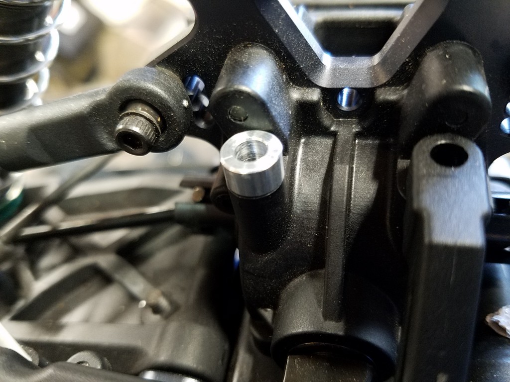

Got the spacer. Fits much nicer vs white plastic but is .13 mm shorter.

It works but does tweak that side a hair when i tighten it down, binding the screw above it just slightly. Can't tell it's off by eye... might try a tiny dab of CA glue on it just to take up that tiny difference so it'll fit perfectly, or maybe a piece of paper.

ok final thought, it works really well and i love how it is thicker so it has much more contact area on the gearbox like the brace.

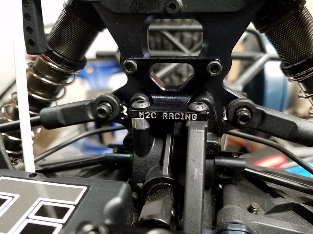

Even after tightening down the 4mm vertical screws I am still able to thread the top left screw in by hand whereas the other two that go in horizontally fall into the hole, Fits a heck of a lot better than the m2c center brace that's for sure! I will still get another one of those though since no one else makes one!
