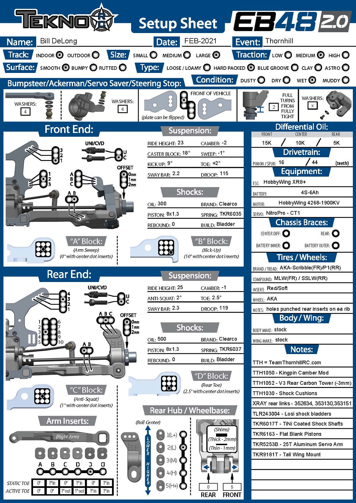

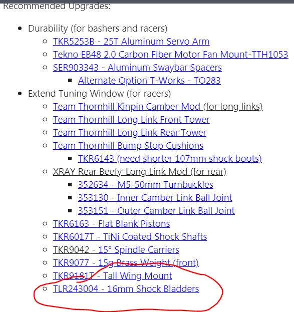

yo, Bill, you got a part number for the TLR bladders? is it TLR244061?

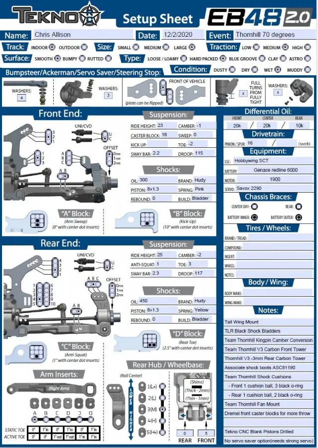

These are the bladders that I've linked in the OP and posted on my setup sheet:

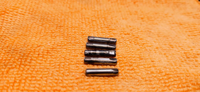

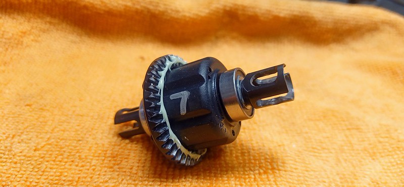

So after 19 race days plus lots of practice sessions, the time has come to replace the pins on the CVD's, I've already had to replace the pin on the center/rear universal once at around the 10th race day, which is about the same time that I rotated the CVD's from left/right sides respectively to double the life of the original pins and here's what the wear is looking like:
I've opted to use these 3x13.8mm pins from 6MIK and will try to see how many race days these pins last before they get similar wear:
https://dialedhobbies.com/accessories/tools/6mik-dogbone-shaft-pins-3-x-11-5mm-11-detail
More info on the Mugen Pin Replacement tool that I am using here:

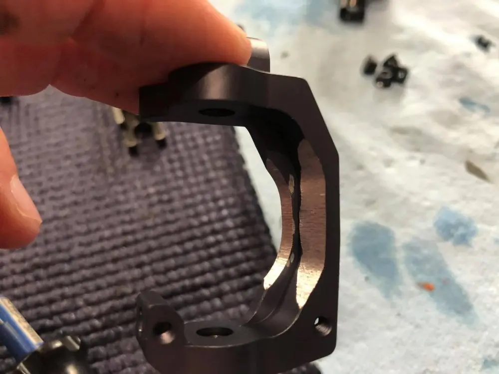

I have also opted to replace the set screws in the front c-hubs with 3x6mm button head screws to minimize the risk of stripping a screw inside the aluminum:
another quick question bud, on the springs, with both this setup and the former pink/pink setup, are those the LF springs or the standard?
i put the bornhorst holiday hangover setup on my buggy for our hard packed loose dirt track and it's like driving on ice. NO GRIP. i'm thinking my shock package/sway bars are too heavy. pink/pink might be the ticket or a better starting point for me.
as a comparison, my EB410 is completely dialed on the track so i know it can be done.
they don't provide a frequency rating in the chart, but I'm running TKR6035 on the front and TKR6037 on the rear right now:

Someone recently asked me how much grease do I put on the crown gears and it never occurred to me that I haven't posted an example of this before, this is the diff from my SCT410.3 but I still apply the same amount of grease on my EB48 as well, just a thin light bead along the perimeter of the gear:
I was planning to spend a lot of time at the track this week but unfortunately I got hit with a low grade fever a couple days ago... I broke the fever this morning, and plan to get tested this afternoon, but chances are I'll need to quarantine for 10 days before I can get back out to the track :(
Ok. this is the chart I was using:
so on Chris' pink/pink setup, he's using 6035 for the front and rear?
Yes, at least that's what he sold me when I was trying to copy his setup, ha!
It's probably splitting hairs where a low frequency is probably better suited for a rough track condition but Thornhill is hard packed and smooth:

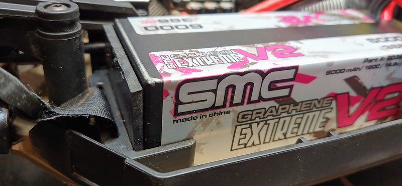

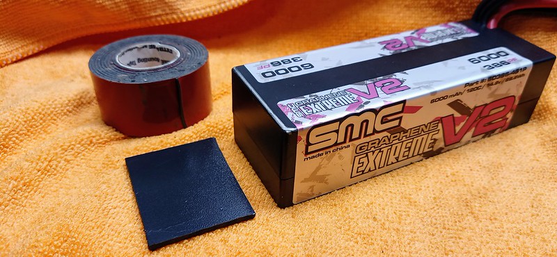

Many folks in my area have been running into an issue with their battery packs getting damaged after taking a hard nose dive causing the top half of the battery to separate and/or crack the battery case.
As a preventative, I've decided to cut a scrap piece of 1/8" Kydex. I had originally planned to use double sided tape to mount the Kydex to the battery but unfortunately the battery tray isn't long enough to fit.
I was able to wedge the Kydex into the tray with an extremely tight fit, in fact I probably need to lightly sand/plane the Kydex to make it easier to pull the battery from the tray, but is does fit and should provide better protection should I take any nose dives:
It's also worth pointing out that I have the wiring on the pack toward the rear of the car, this is very important because that's where all the soldered internal tabs and balance wiring is located so this minimizes any risk of damaging the internal wiring from a nose dive. It's fairly common to see folks have battery wiring issues if they place the wiring of the pack toward the front of the battery tray :(

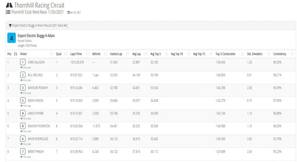

With this group of drivers, I normally would come in around the #5-7 spots typically, somehow the moons aligned and I was able to put together some consistent runs where I was struggling with consistency originally with the setup, I think the tire package really helped settle the car down and made it a lot easier to drive, though I wasn't hitting the same fast lap as before, so I probably need to keep chasing tire selection to see if I can pick up some more speed while not sacrificing too much consistency... balance is key!
I had a good race day yesterday and played around with some different tire combinations... I probably should've stayed with what I ran this past Wed night, but there are too many combinations to test!
Anyway, I was able to break a couple new PR's for this layout which will be the last race day on this layout as the club will be hosting the first round of the 2021 series this next coming weekend.
Hot Lap went from 33.128 to 33.066 ... almost in the 32's, argh!
Hot Main went from 14/8:19.644 to 14/8:07.684
My hot consistency was only 96% which shows that the tire package was very fast, but the car was very challenging to drive.

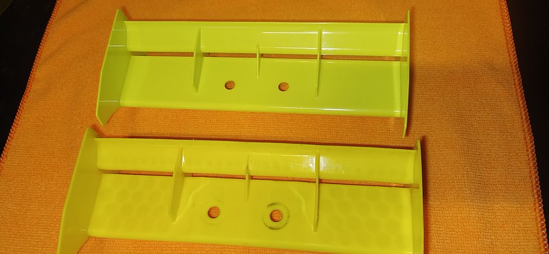

I also dyed a bunch of wheels and the kit included white wing today. I was getting tired of the mismatched "dull" yellow wheels and wing and prefer a brighter "neon" yellow to increase visibility.
The following photo isn't really doing this any justice, but I wanted to demonstrate the following dye product:
https://www.ritdye.com/products/neon-yellow-1lb/
The wing on top is the kit provided white TEKNO wing that was dyed Neon Yellow and it's a perfect match with many popular brands of neon yellow wheels on the market... I decided to use the same dye to a bunch of white wheels to get a perfect match.
The wing on bottom is the optional yellow wing from TEKNO, but it's a darker shade of yellow without any neon effect. I also noticed that when I dyed the white wing that it darkened the honeycomb effect so it's no longer visible as a bonus!

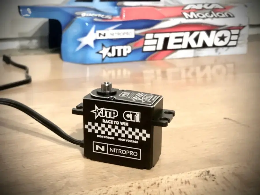

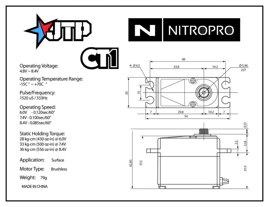

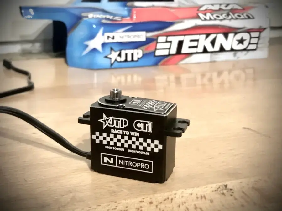

I was in the market for a new servo and as luck would have it, Jared Tebo decided to travel down to Thornhill for the first series race of the season this past weekend so I bought one of his CT1 servos which worked great in my buggy!
https://www.shopjtp.com/product/ct1
Although it was just a "Series" race, technically a club race, somehow it turned into a large regional event with 276 entries!
https://trc.liverc.com/results/?p=view_event&id=343259
I raced in the Expert eBuggy Class with a total of 55 entries which spanned all the way down to an E-Main:
https://trc.liverc.com/results/?p=view_entry_list&id=343259
I was fortunate to get a good run in the first round (only 2 quals) which was good enough to get a spot in the B Main (pretty much all pro level drivers stacked in the A Main) and I would finish 9th which made me very happy to be right on the heels with many of the team drivers that were trickled down into the B Main!
https://trc.liverc.com/results/?p=view_race_result&id=2811629
Really loving this buggy!

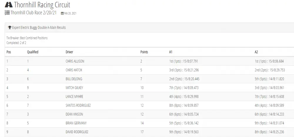

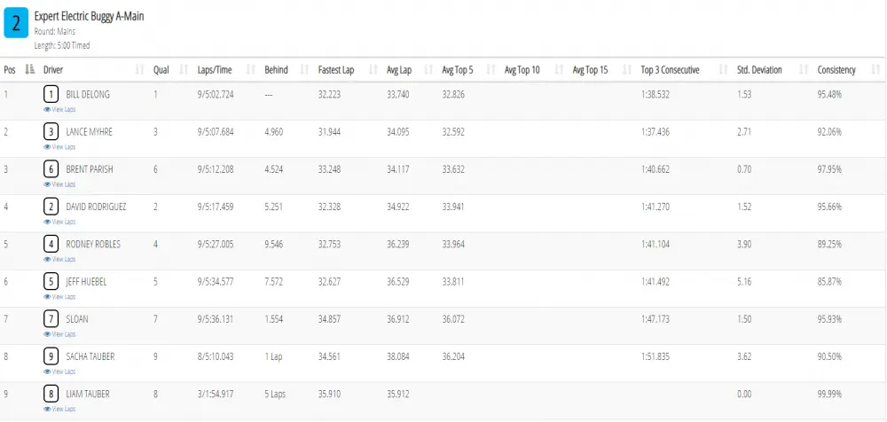

It's been nearly 4 months since I took a win in the A Main, but honestly it was only because of low turnout due to cold weather, ha! At least with 5 days on the current layout, I was still able to break 3/5 of my PR's this week so that was really nice.
I've switched from AKA Typo to Chainlinks on the front and that seems to give me a little more steering to help whip around the 180° turns a little quicker and the big advantage I had going for me was tire warmers which made my lap times just as fast as a warm spring afternoon even though ambient temps were in the low 40's:
https://trc.liverc.com/results/?p=view_race_result&id=2828519

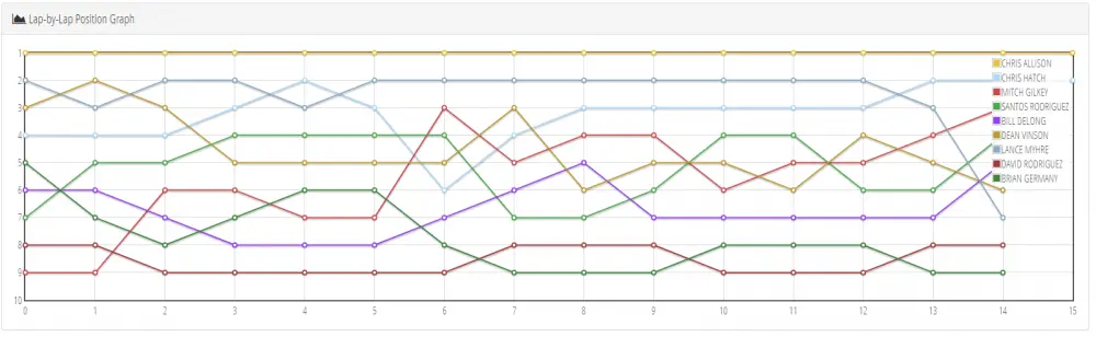

I would take 3rd overall in a field of 27 drivers with this setup which was a really tight field loaded with lots of close racing:
Check out all the action with the change of positions each lap of A2 here, good times!
