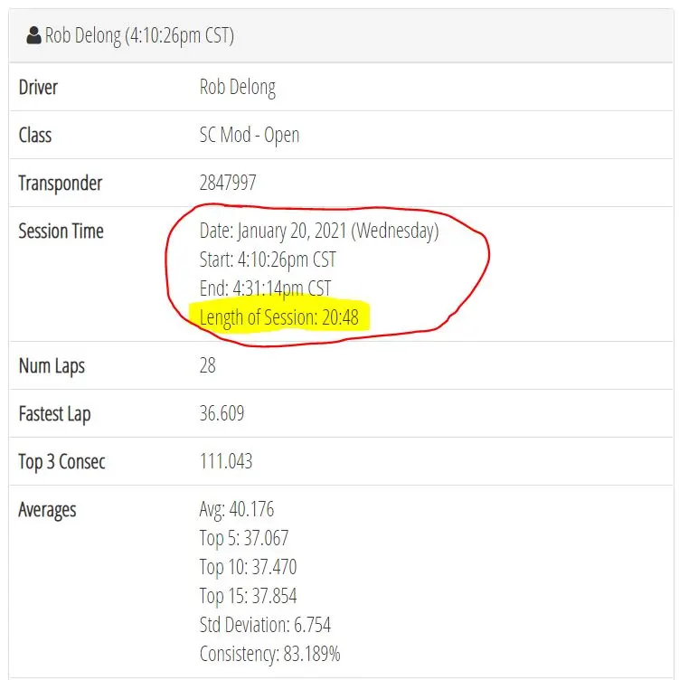

I ran 1 practice session which lasted nearly 21 minutes before I hit LVC, then I checked the motor temp which read 142°F
Here's a link to the practice session, note that it was listed under my son's name because he's been racing the truck for the past 3 months:
https://trc.liverc.com/practice/?p=view_session&id=8182598
Now keep in mind that I had 4 short breaks where I had to make some tuning changes to the radio settings, so if you take my overall average of 40 sec/lap into the 28 laps that I completed that works out to 18.7 min pure run time at 100% hard driving which is still pretty darn impressive!

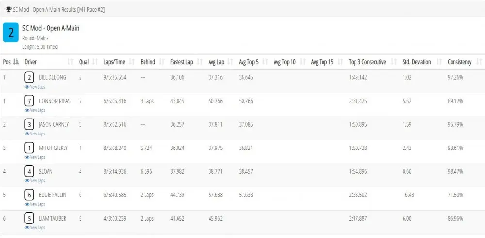

Unfortunately my son couldn't race last night, so I decided to race the truck myself and got Q2 on the grid and was able to settle down in the main without any wrecks to take the win. Both the 2nd and 3rd place drivers had a faster fast lap than me, but it came down to consistency to take the win, ignore the entry for Connor as he was running 2WD Buggy mixed in with our group:
https://trc.liverc.com/results/?p=view_race_result&id=2794583
No doubt I was getting faster every battery pack, but I was also running into some snap over steer issues when going off power from the straights into sharp corners, so I've got some setup changes to make tomorrow to address that issue. Hopefully I can knock a few more tenths off my fast lap before Saturday where I will get to race the truck again and should have an updated setup sheet to include the recent changes I've made.

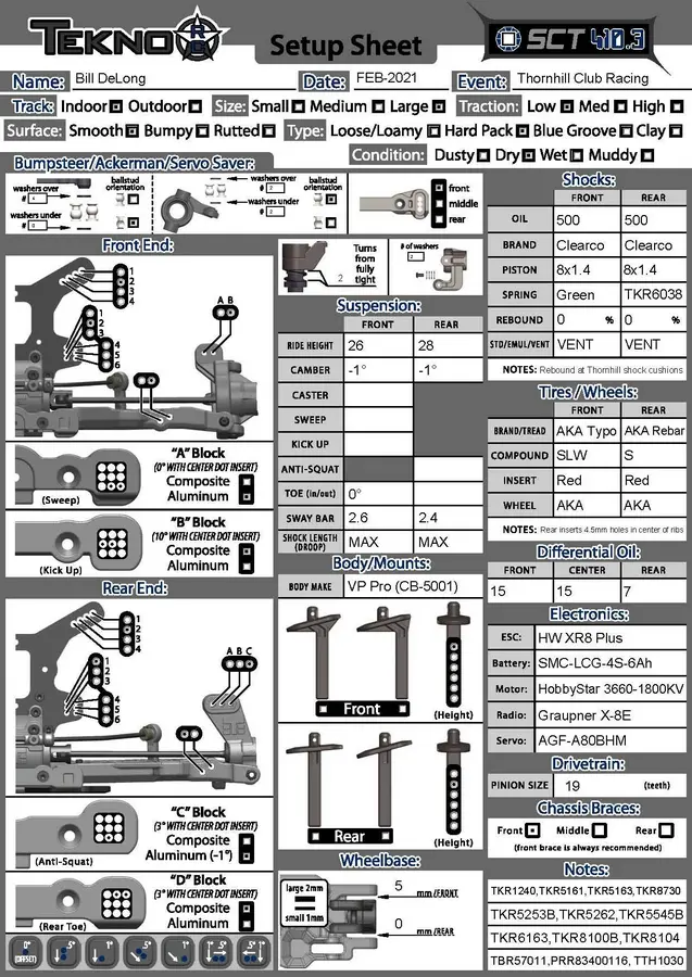

Hey Bill, I am following your setup sheet for 'summer' that you linked to. For the rear end you are using 2C for the rear camber link setup. Did you use the stock camber link or lengthened it more then 25.5mm as indicated in instructions?
I definitely changed the length of the exposed turnbuckle, but that was based on the ride height and camber settings, I didn't measure the distance with a caliper. That 25.5mm is just a ballpark anyway, folks will need to adjust the turnbuckles on a setup board when the build is complete.

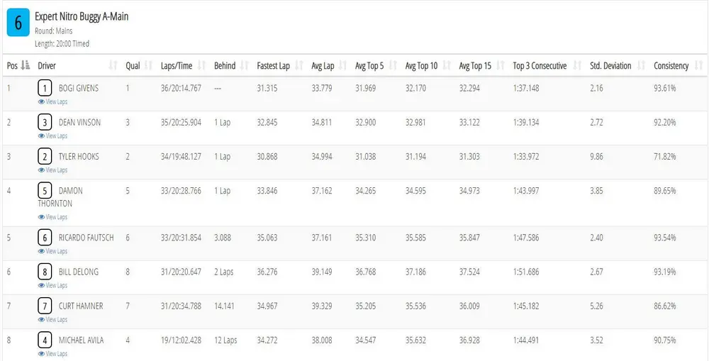

I just realized that I never posted my results from a 20 min main that I raced last year mixed in with nitro buggy to help make a full heat and my SCT made the whole 20 min on a single charge. Only catch was I reduced the throttle EPA to 85% which was fine for me to clear all the large triples and I was smooth on the acceleration and was very gentle on the braking to conserve power, my only goal was to finish a 20 min main, which was a success!
