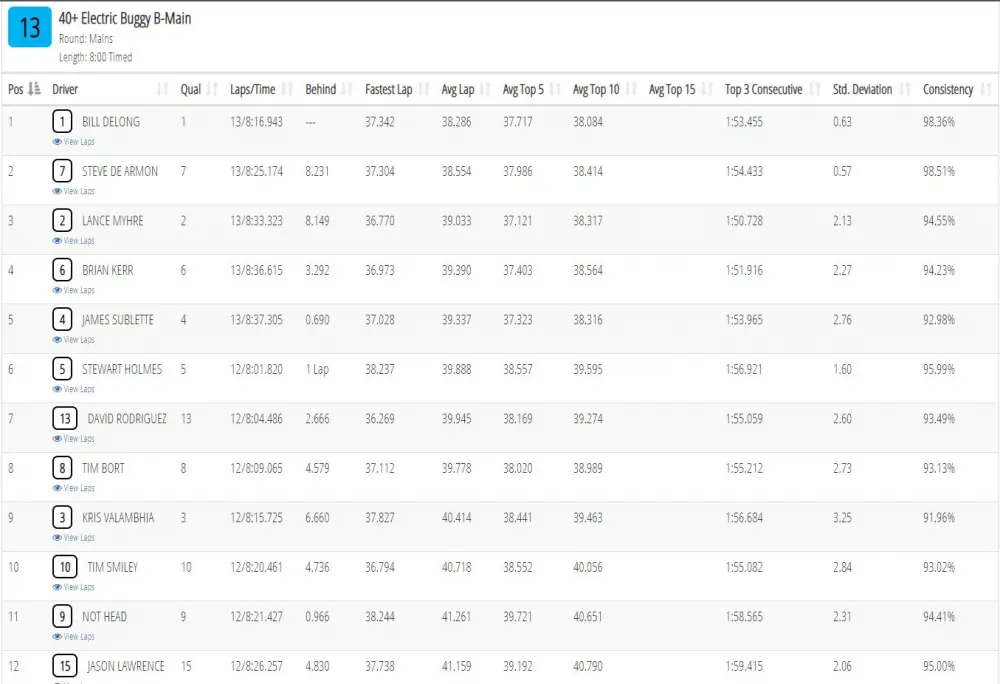

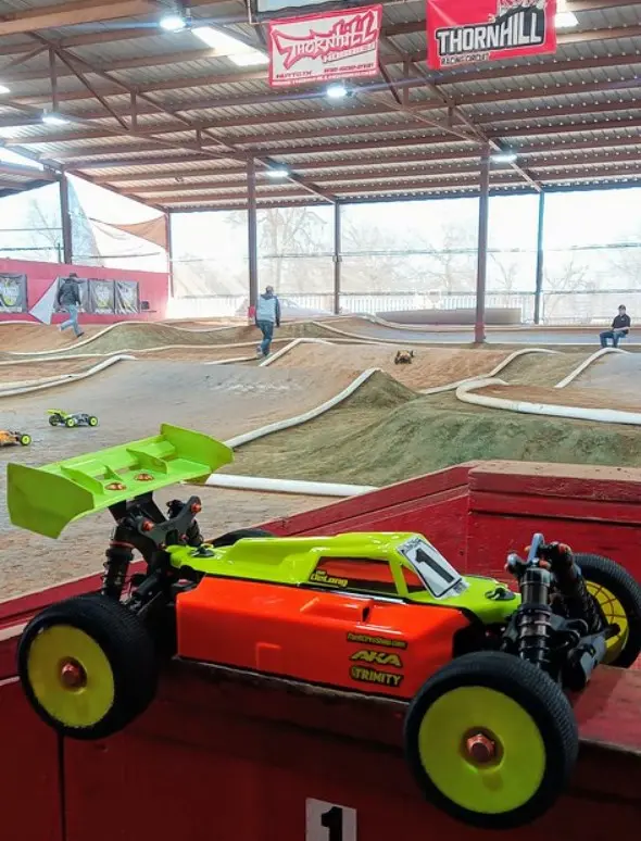

I had a great time this past weekend at Thornhill Racing Circuit for "The Dirt Lonestar Challenge" with a total of 388 entries which set a new attendance record for the track!
I ran the same eBuggy in both Open and 40+ divisions with 45/39 entries in each division respectively. I would finish 16th overall in Open and 10th overall in 40+
The high point of the event for me was winning the B Main in 40+ to earn a bump spot into the A Main. I was far from the fastest driver in the B group, but it was consistency that was key for me!

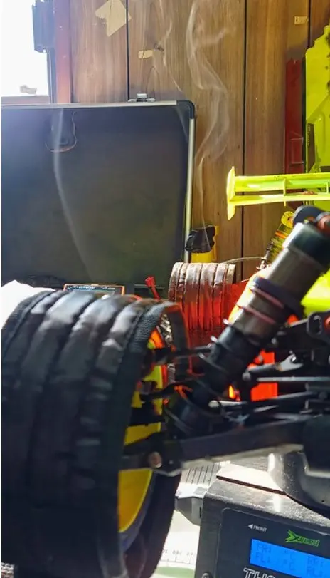

I did some experimenting with using my tire warmers to "bake" in some sauce into my AKA SSLW tires and that really seemed to make a noticeable improvement with traction.
I'm so used to having a watered track surface, it was a completely different style of driving surface which reminded me a lot of what I experienced at the RC RIOT race in KC last Fall.

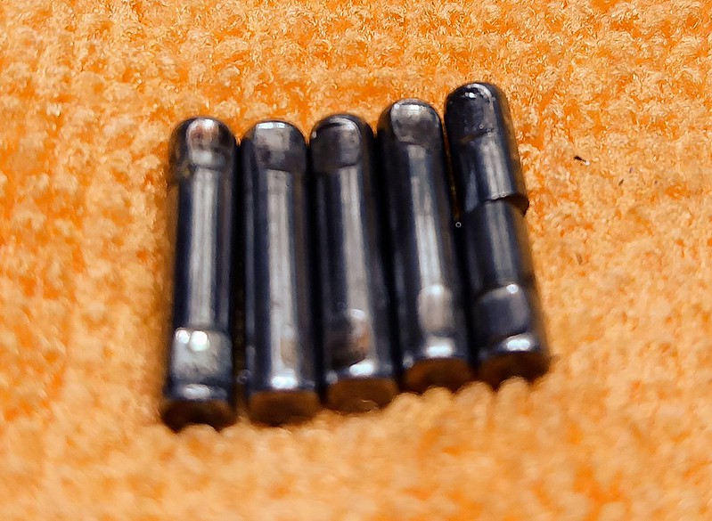

The last time I replaced the pins was about 4 months ago ( 16 race days) and I'm very pleased with the wear on the 6MIK pins:
Notice that one of the pins snapped when I was replacing it which tells me these are exceptionally hardened:
https://dialedhobbies.com/accessori.../6mik-dogbone-shaft-pins-3-x-11-5mm-11-detail

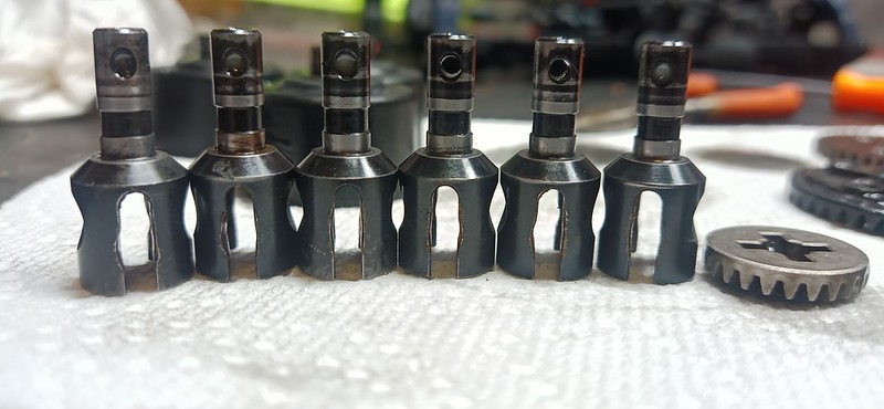

These are all original out drives which have seen a total of 35 race days per my race log and are just now starting to show signs of wear, if I had to guess, they might get another 10+ race days before they may need to be replaced, needless to say I am VERY impressed with the wear lifespan of these parts!

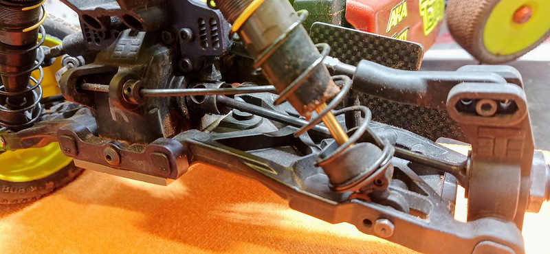

1) While I appreciate the larger diffs with the 2.0 design, I found it difficult to remove the sun gears with a pick, sometimes taking as much as 2-3 minutes to pick out just one gear while holding the diff case at odd angles, sometimes praying for the gear to come out.
2) While I never broke a single spindle, it would be nice for these to be made out of aluminum, I found it necessary to replace the spindles every 6+ race days as excessive slop would form around the king pins.
3) King pins would tend to crack around the flared end which is used as a guard to prevent dirt from getting into the bearings on the c-hub carrier... if you want to protect these bearings, then plan to replace these king pins every 2-3 race days. Perhaps a replaceable spacer/washer could be used instead of integrating the dirt shield into the same piece? Idea being that a washer could be made of a softer metal and will bend instead of crack.
4) Battery tray is too low for my preference and is likely to cause damage to the batteries with large jumps. It would be nice to have an option with a full height tray with carbon strap so that the battery can't shift/crack or get damaged as easily. Over the course of 6 months, I damaged 2 batteries with internal wiring issues and I've seen the same issue happen to others running the 2.0 at the track in my area regardless of the brand of battery used among 5+ brands of batteries.
