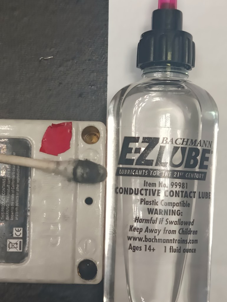

After 19 logged race days with this chassis, I started running into electrical problems where the wiring to the 5mm bullets on the battery posts would become un-soldered during a race. The excess heat would cause the in-line connects to melt the plastic of the battery case making it unsafe to continue using the same battery:
The cost to replace the battery was going to be around $160+ after shipping so I decided to go a different route and have installed the following electronics for just under $120 shipped total:
Although I probably could've fixed the issue by replacing the worn 5mm bullets with a fresh set, I really didn't like the idea of pushing too much current through on 2S and decided that 3S would be more efficient to help reduce temps and more importantly, extend my run times. I have since ordered the following product which I am told should extend the life of my bullets so they won't tarnish which will prevent the excessive resistance like what was happening to me:
