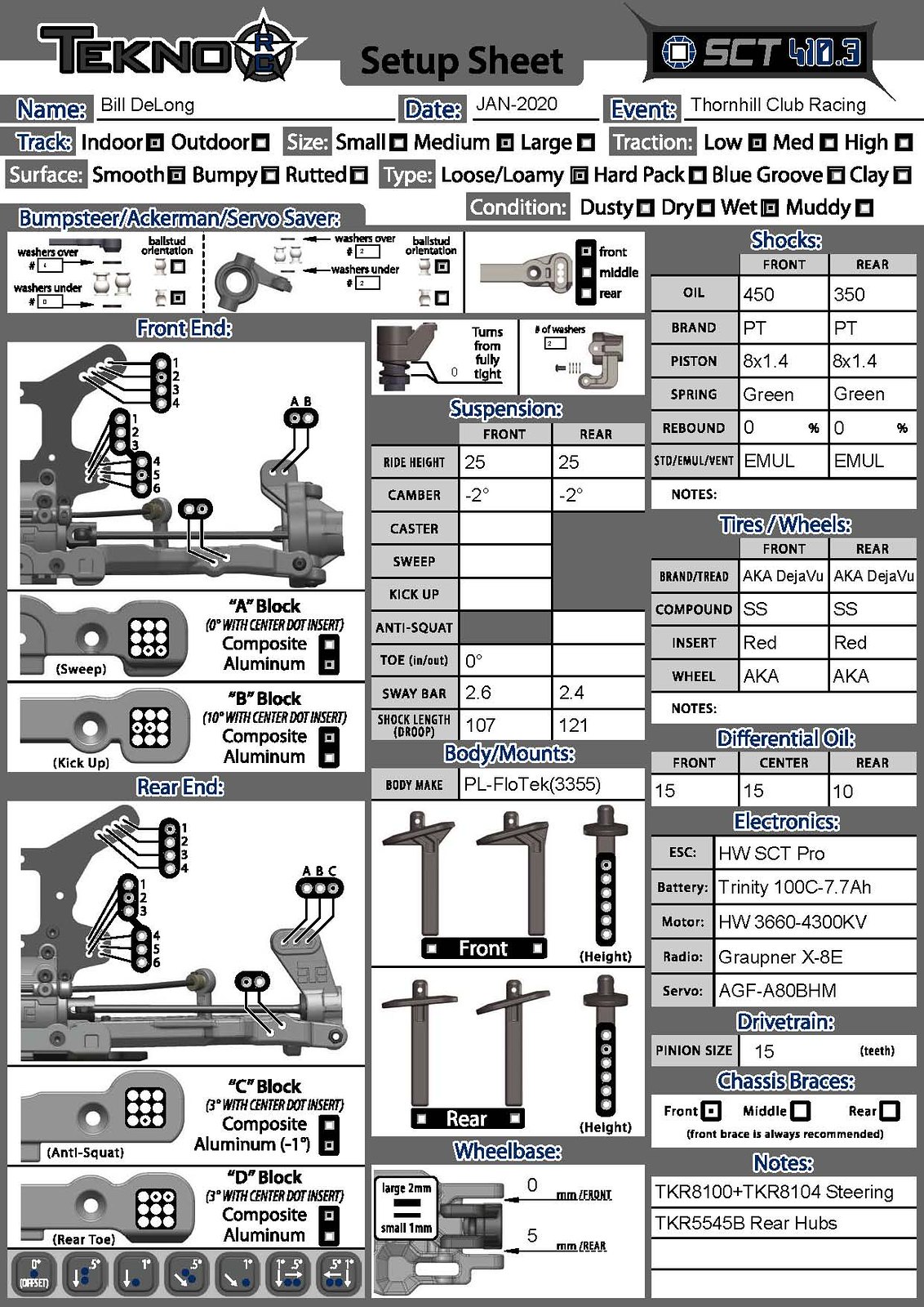

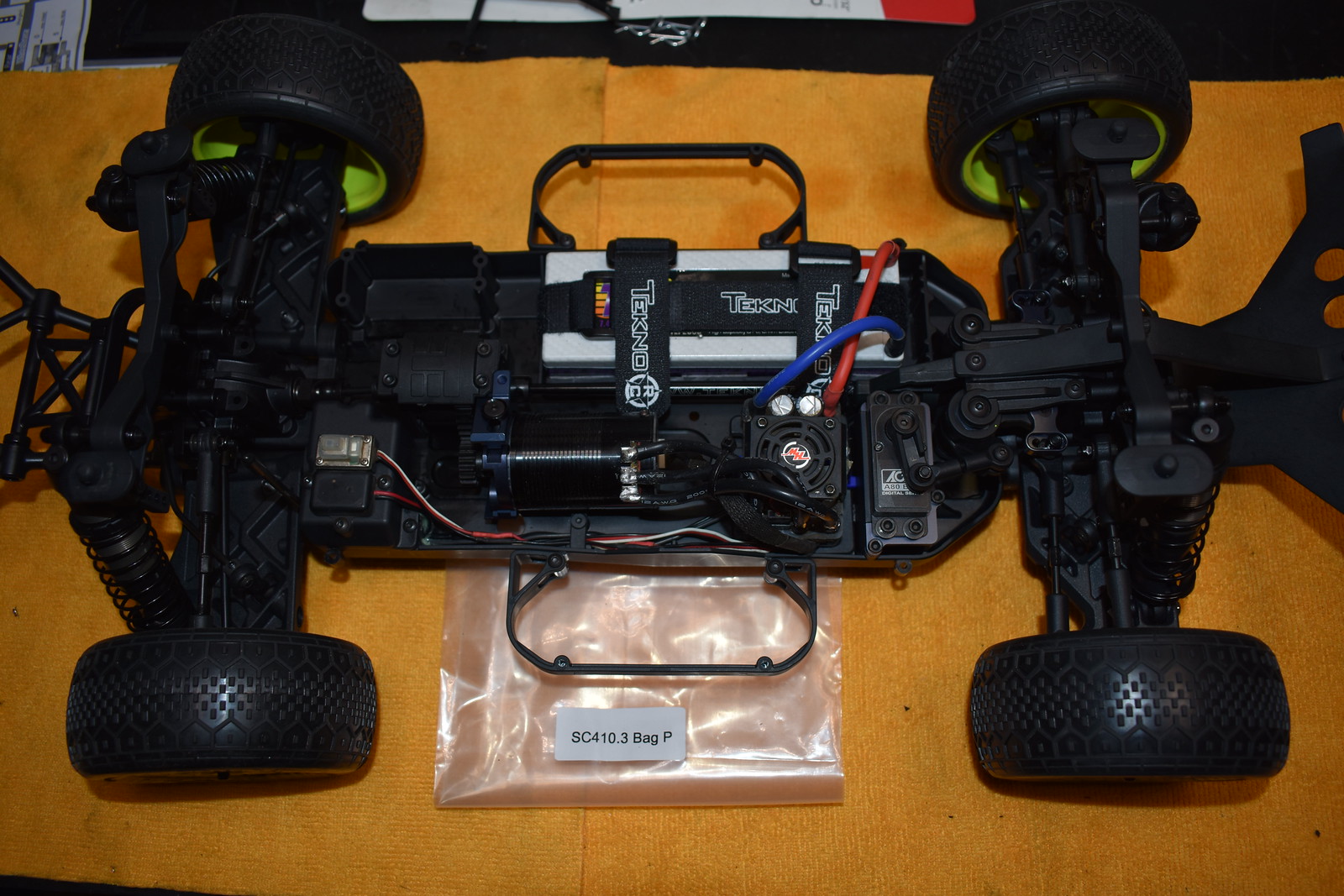

Build is complete, I plan to race this truck tomorrow night and try dial in the setup, so far this is my baseline starting point, fingers crossed that I'm in the right ballpark!
I have some upgrades marked on my setup that are on order, should have them installed next week!

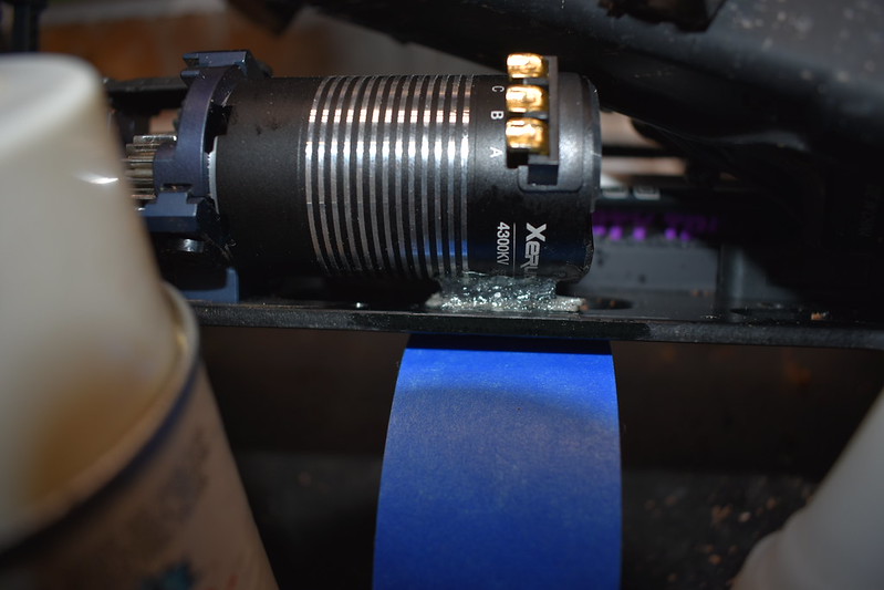

So my RMA from HobbyWing came in yesterday's mail, the case of the motor had cracked after years of use in my .1, so this time I've decided to add some support by using double sided tape and a 3mm block of kydex, then put an extra layer of CA glue just to make sure it stays put. Time will tell if this mod holds up :)

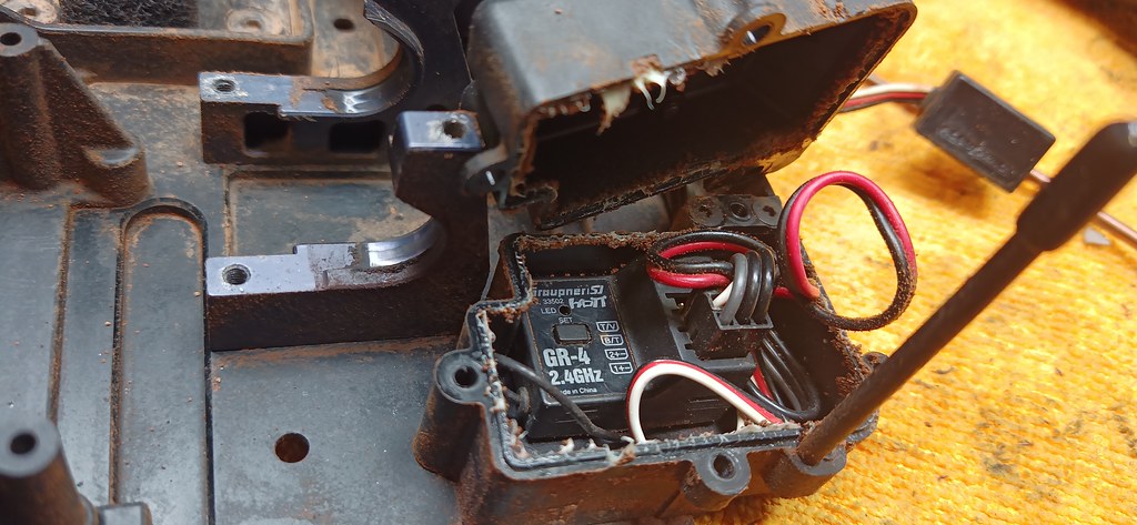

So I was curious to see how my "dust proof" radio box mod has been holding up and cracked open the grease seals to learn that the Rx is nice and clean after 12+ race days, time to apply some fresh grease on the seals of the case :)

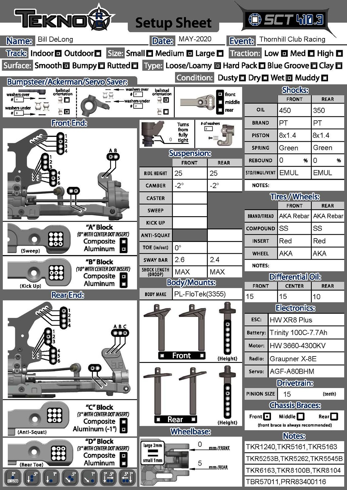

I've updated my setup sheet (OP also updated) with a few minor tweaks, full list of upgrades in the notes, tire change, max droop and I just swapped out the ESC, playing the shuffle game so I can put the SCT grade ESC in my MiniTruggy and put the XR8 Plus in this truck which is complete overkill, but I was running into overheating issues with the XR10 ESC in my MiniTruggy :(

Hi Looping67. I did not have to shortness the turnbuckles to get the ackerman plate to fit, however I did notice the threads are not visible on the turnbuckles when the steering is at 0 degree toe-in. I did not feel them bottom out when shortening them to 0 degrees. I haven't tried any toe-out, though. I have attached a picture of the plate and the turnbuckles.
