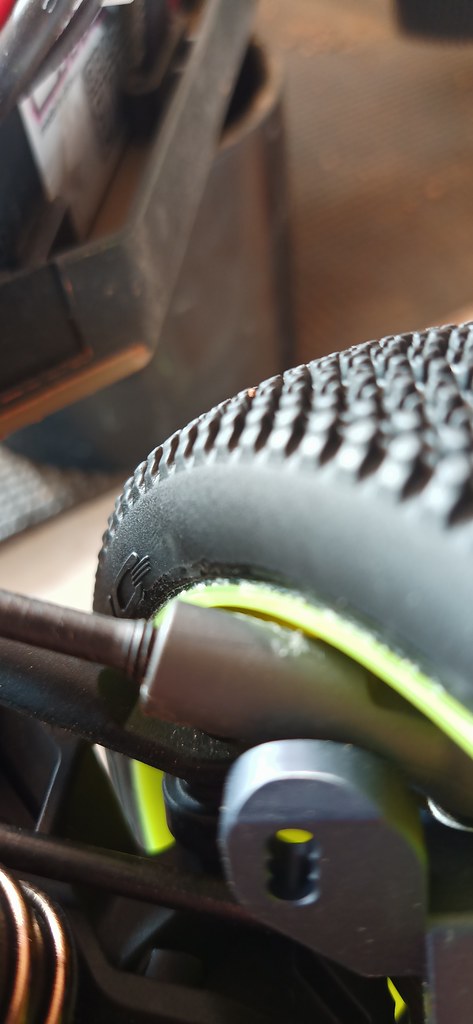

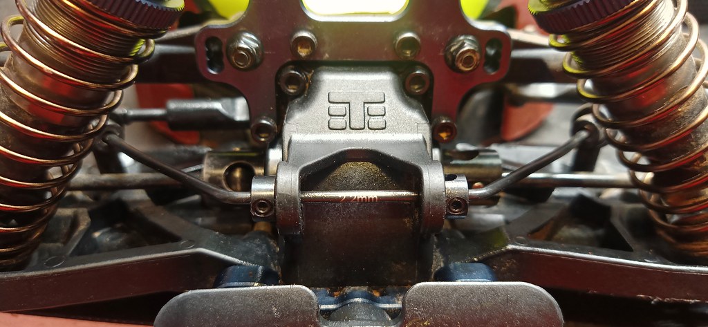

So I've upgraded to V2 mod of the long link camber kit from Team Thornhill and happy to report that the front links get proper clearance after a full day of racing with full lock on the steering (with steering stop screws removed) just barely a scratch on the ball ends with front droop set to 117mm:
I'm not used to driving a car that can turn on a dime like this, while still feeling stable and smooth, I'm really loving this setup, thanks TEKNO and thanks Team Thornhill, feels good to be back in 1/8 again

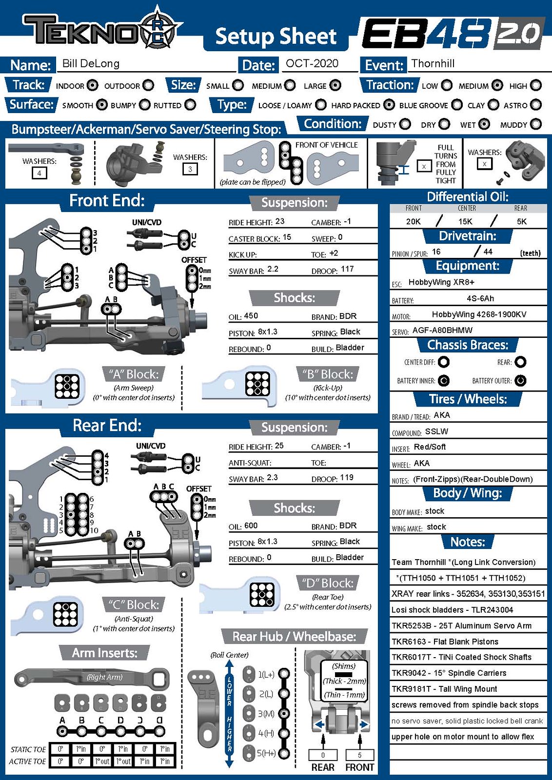

I've made a few tweaks to Chris Allison's setup, and this is working very well for me right now:

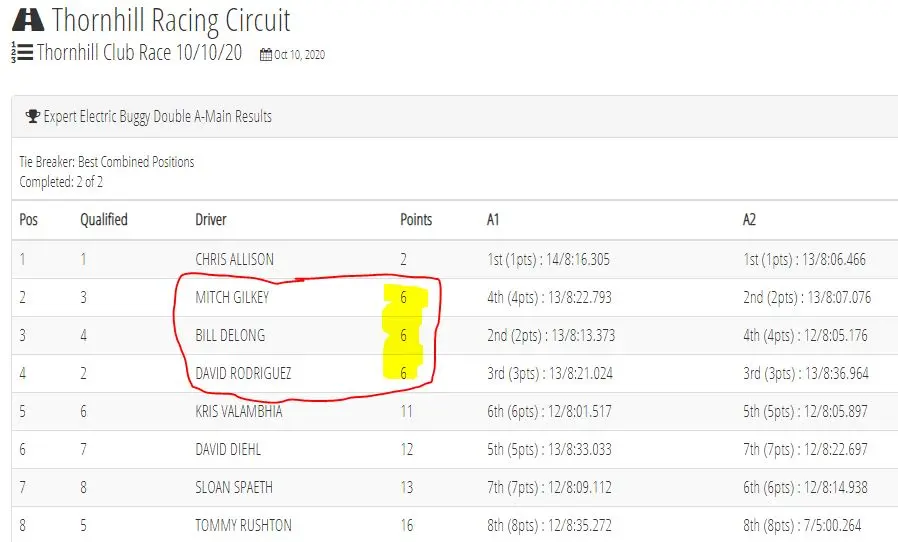

I'm far from the fastest driver in my area, but I managed to get into a 3 way tie with a couple fast drivers yesterday, hopefully I can keep getting faster as I make more adjustments to the setup :)
My combined average consistency across all 3 quals yesterday came out to 98.99%, this car is dialed!
https://trc.liverc.com/results/?p=view_race_result&id=2644062
All 3 cars are TEKNO, and almost identical setups on each car as well with very minor tweaks to suit each driver's preference.

The setup on the rear of your car is very interesting. With such a soft spring and the hub moved all the way to the rear, you've taken a lot of the support out of the rear. It looks like you've added support back in with a lot more antisquat and a much higher roll center at the C and D blocks.
Do you only race at Thornhill? That is a fairly unique track so I'm wondering if your setup will translate to other tracks or not.

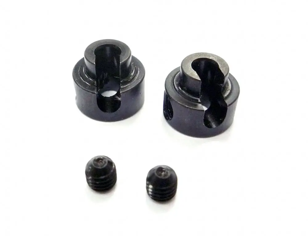

My Serpent order arrived over the weekend and I just finished installing the upgrade. Huge difference where the plastic spacers could easily be twisted by hand no matter how hard I tightened the set screws, after using thread lock on the aluminum spacers I can't get them to budge. Here is a BEFORE pic of the problem where the screws would tend to "pop" out of alignment:
AFTER:
*** UPDATE
After 1 full race day I am happy to report that the set screws remained properly aligned :)
*** UPDATE #2
3 full race days and the set screws still haven't budged!

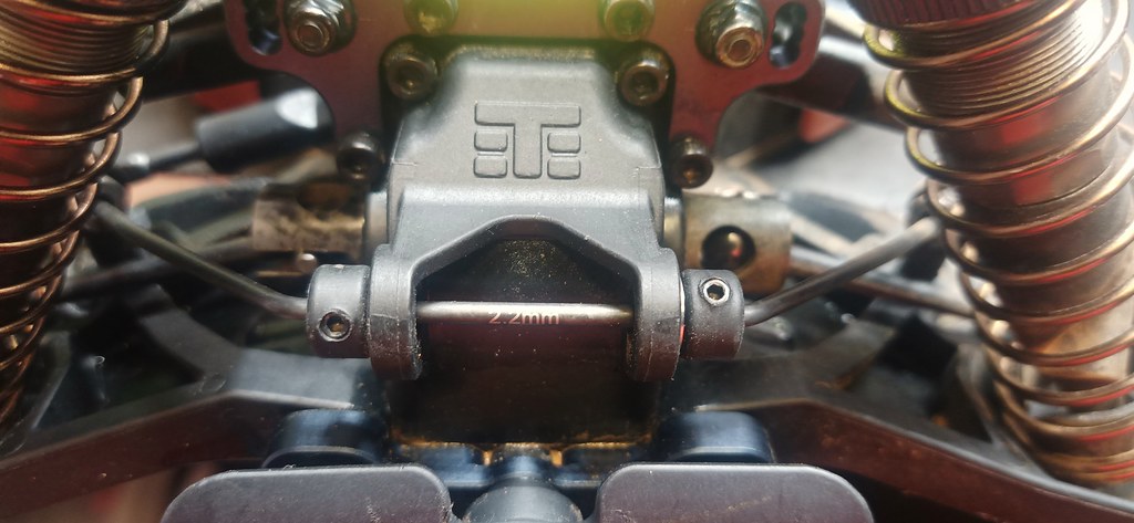

Yes, they "limit" the shock travel so that the body of the shock cartridge is squished into the rubber before the chassis bottoms out. It will put some extra stress on the shock tower and pill inserts, but the trade off is reducing "chassis slap" which can be a HUGE difference in improving performance as well as saving your ESC from damage, too many hard chassis slaps can kill an ESC :(

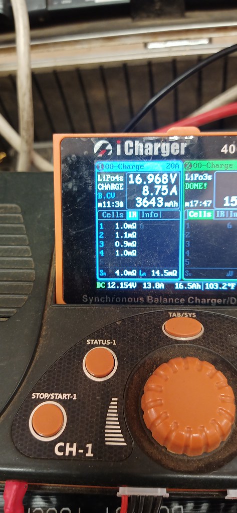

Also happy to report that the SMC battery is still showing low IR after 40+ cycles
