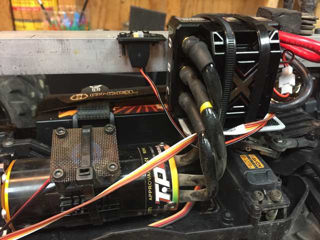

Currently running tp power 92mm long can 1600kv motor(its 16....something, I forget...think it’s listed as 1630)
Mamba Monster X esc
Savox 1270 servo
Esc mounted on chassis brace to make room for the motor.
Chassis brace also is a body support/mount that greatly extends the life of bodies.
Running 4s, 5s and 6s depending on location and mood:)
I don't think your motor is big enough :eek:
The way I drive I still get these big motors pretty hot. I was really cooking standard size motors.

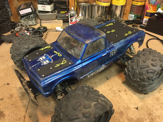

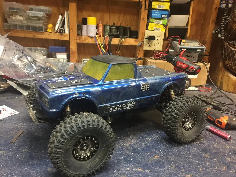

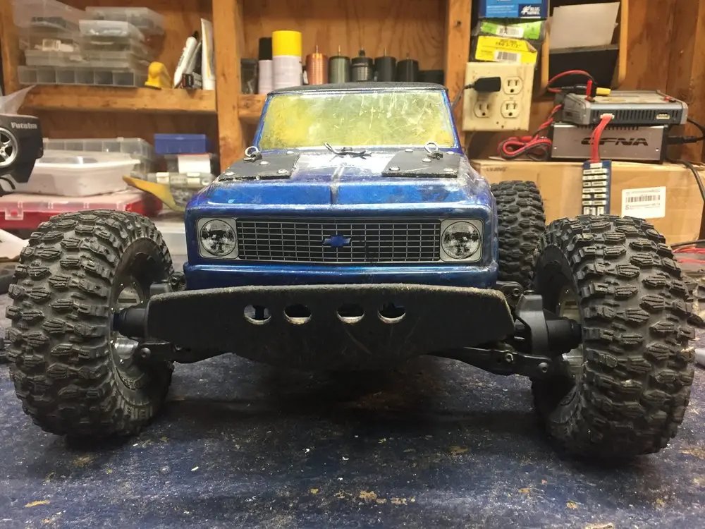

Which do you prefer?
I really like both. I’m always swapping....I also have approximately yen other sets of tires that I can run on this truck...and my many other 1/8 scales. I’m a certified rc tire addict.

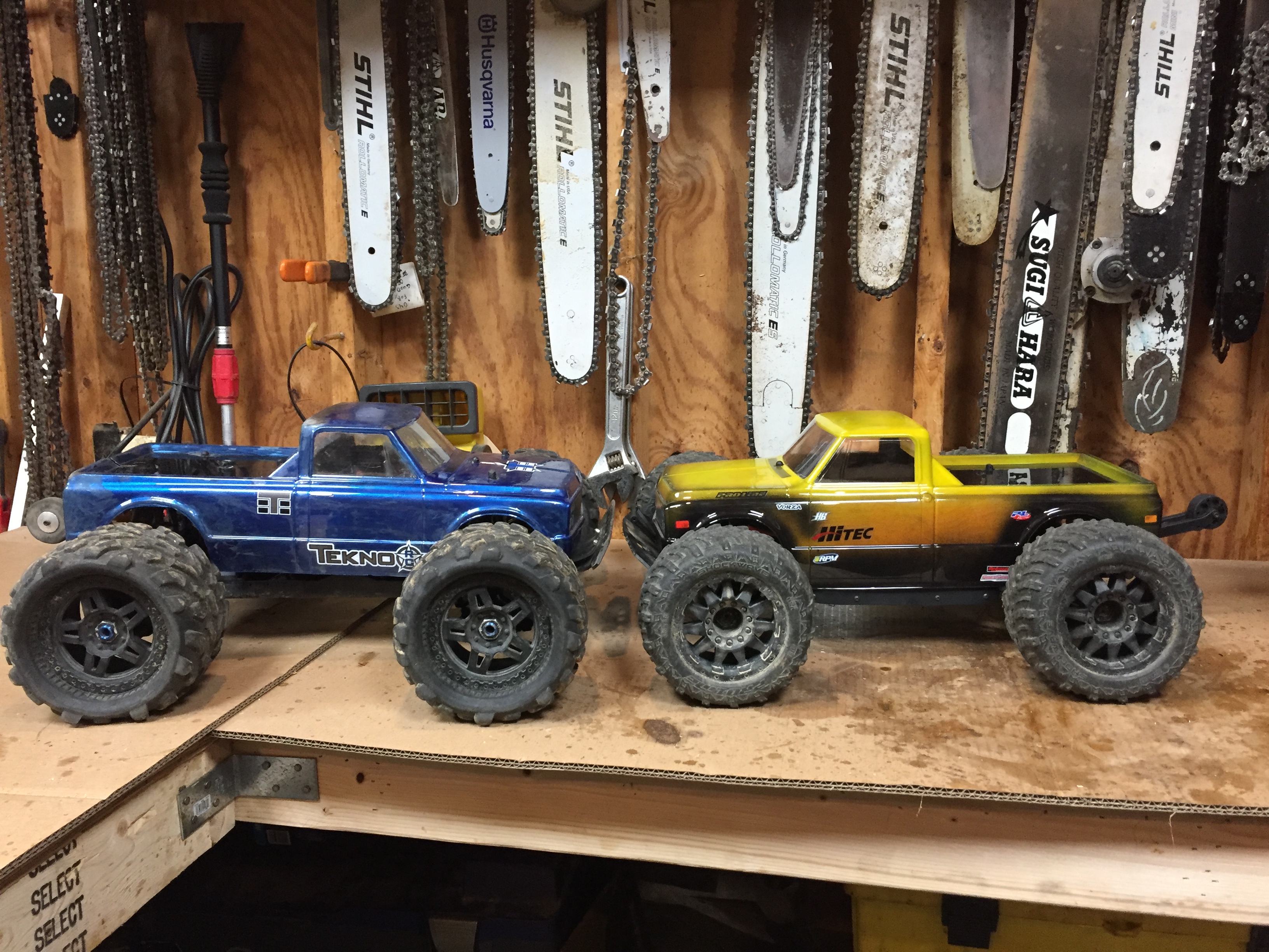

Here’s my MT410 compared to my Vorza monster build. They are almost exactly the same dimensions.

What pinion do you use to overheat that motor ?
I have a 15 tooth pinion on all of Teknos. If I’m driving like a nut job I can get these big motors up to 160 to 180 degrees in less than 10 minutes on 4s.

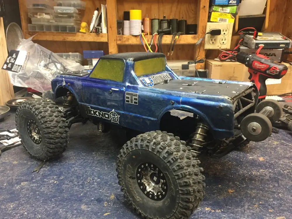

Narrowed the old MT with eb48.3 parts....a little more of a scale-ish truck now
