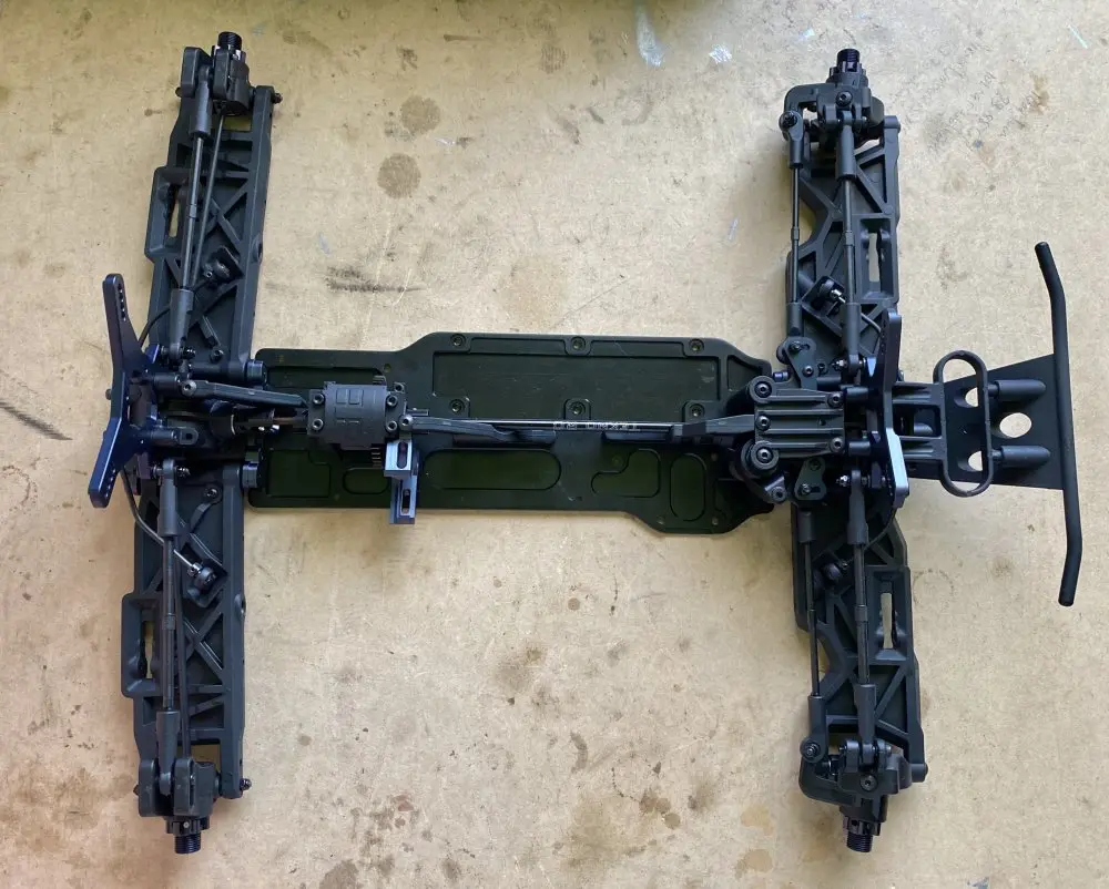

So here goes, my first Tekno build ever..!! ( apology's for my bad photos πŸ˜‰ )
I've learnt plenty on the Tekno Forums so far, lets just hope it helps me with this build..
Though I'd do a layout shot first, because hey no one has ever done that before have they 🀣.....

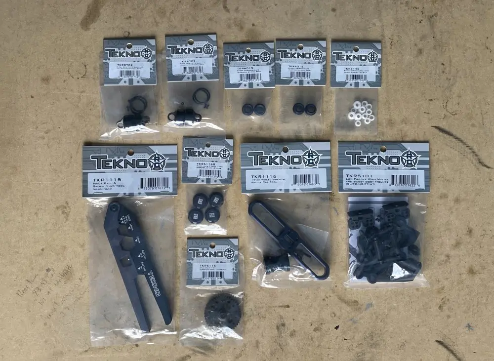

Couldn't help myself but when I ordered the truck I decided to get some upgrades straight away.. So in no particular order here they are, emulsion shock caps, alloy lower caps, delrin bushing, wheel nuts, steel spur, wing mount ( just incase πŸ˜‰ ) and finally the holy grail shock tool and wheel nut tool..πŸ€™πŸΌπŸ˜
The alloy spring platforms and servo horn were out of stock when I put my order in, and still are 😩 so I'll get them as soon as they're back in stock..
( I'm trying my hardest not to just order loads of M2C parts 🀣🀣 because I really want to run this thing stock for now..!! )

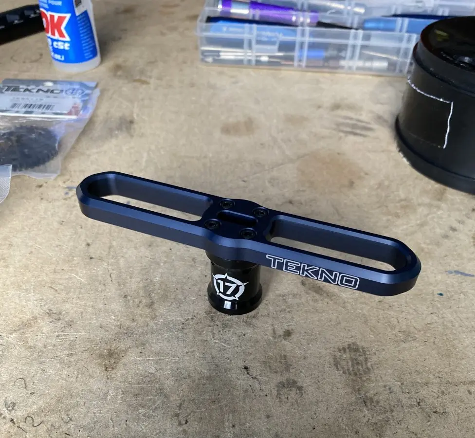

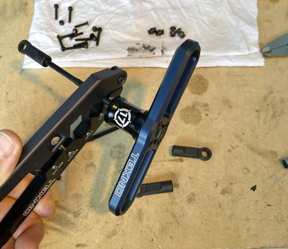

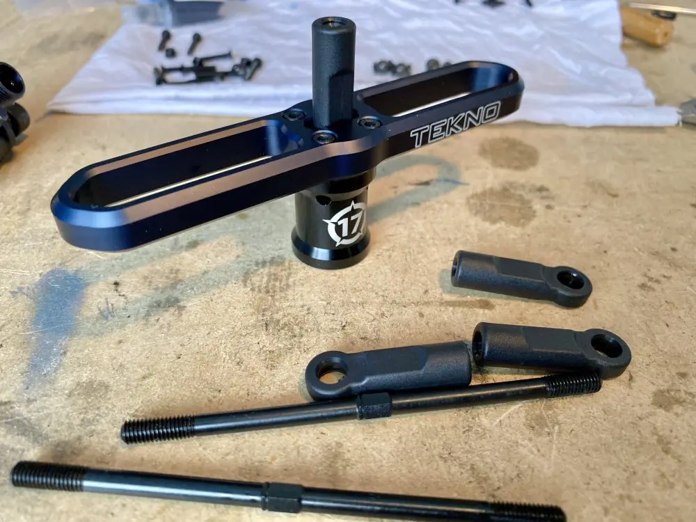

First part of the build, build the wheel nut tool..!!
This thing has so many uses it's crazyπŸ€ͺ
I've read plenty of posts on here since I joined and I've learned a few tips'n tricks reading @TBuggy builds so I think I'll be good to go from here onwards.😁

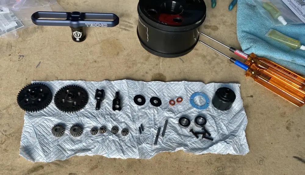

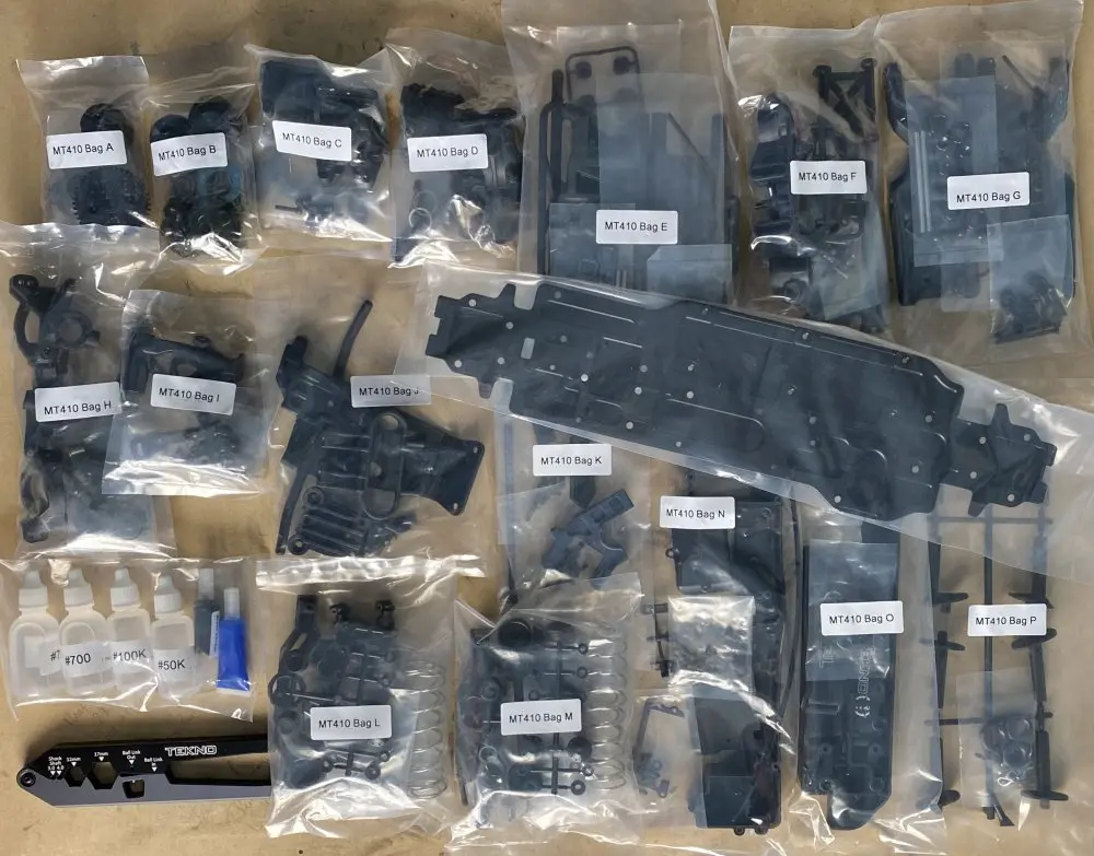

Everything laid out and ready to go...

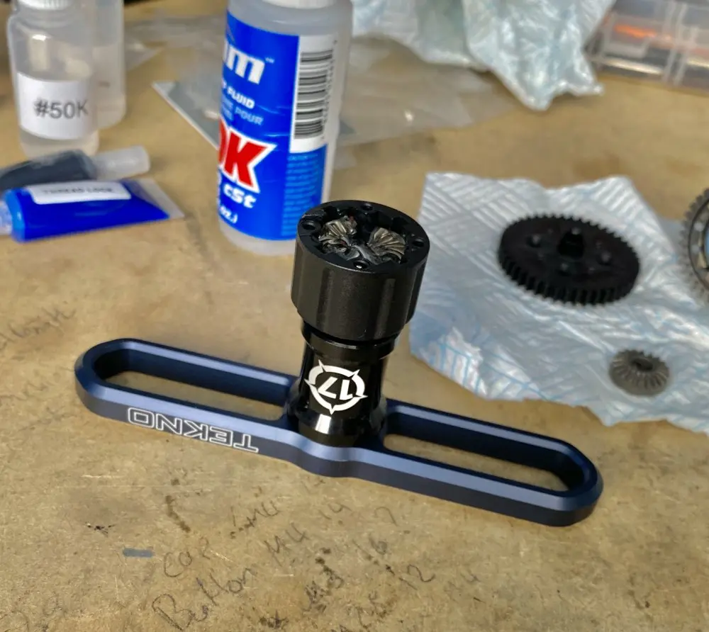

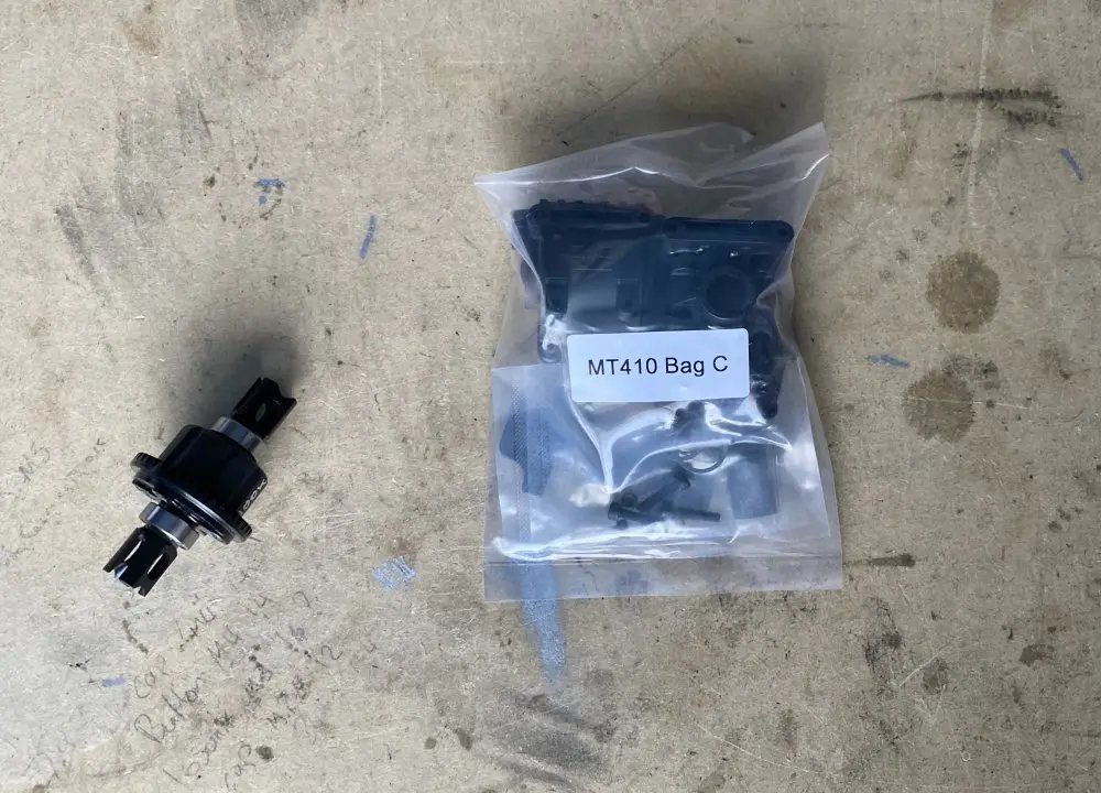

Center diff is the first part I'll be tackling, I'll use plenty of green slime on the o-rings and also on the outdrive shafts then I'm going to fill it with 500k,
I'm well impressed with how buttery smooth it is just assembled dry with no shims needed..πŸ‘πŸΌ
( not like a sloppy Arrma diff πŸ€£πŸ˜‰ ) you may notice in the background my upcycled shock stand made out of a redundant truggy wheel πŸ˜‰
So I've just learnt another use for the wheel nut tool..!! It's a diff stand πŸ€”....

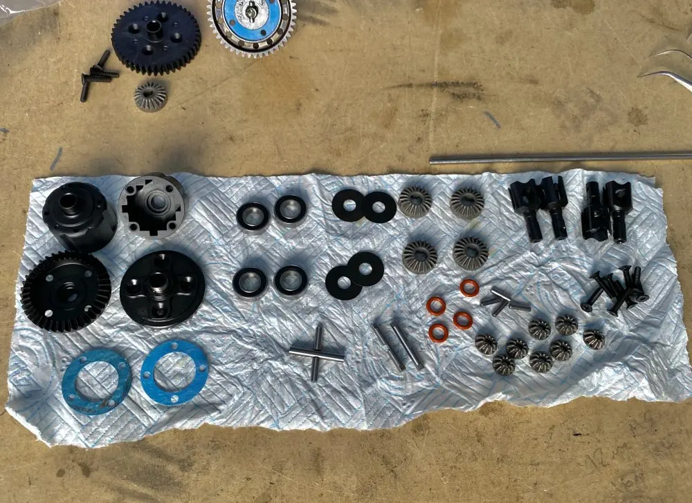

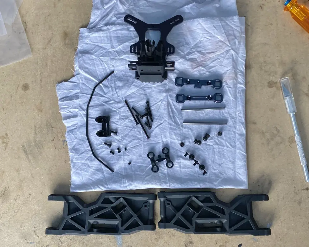

While the center diff sits in its new stand I'll start to build the other diffs, again I'm shocked how buttery smooth the diffs are compared to others I've built before..😁
All the parts for the front/rear diffs laid out ready to assemble, not much to say other than these two went together just like the first.
Buttery smooth and no shims required..πŸ‘πŸΌπŸ˜

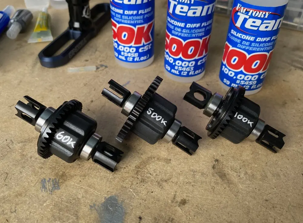

And here they are all built up with the oil weights written on the diffs, so...
a: I know which end of the truck they go in... 😁
b: I know the weights for future reference...πŸ‘πŸΌ

Out of curiosity, why did you decide to use the Associated oils rather than whats included in the package?

Any particular reason for the heavy shock oil in the middle?
It's what I'm used to, top tip.. never mix oils (brands) as the weights from one brand aren't necessarily the same as another..πŸ‘πŸΌ
To stop the front tyres front ballooning under heavy acceleration..πŸ˜‰

Let me know how that diff oil setup feels. I’m at 100k front / 200k center / 50K rear

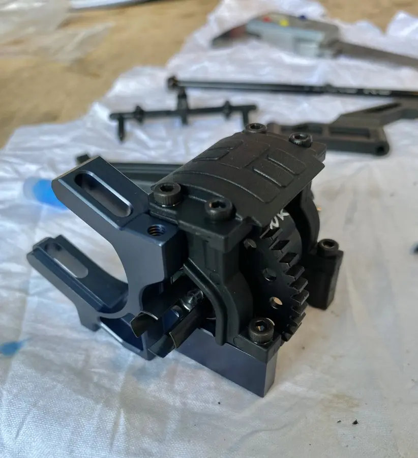

Part 2 πŸ˜‰....

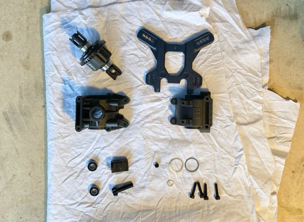

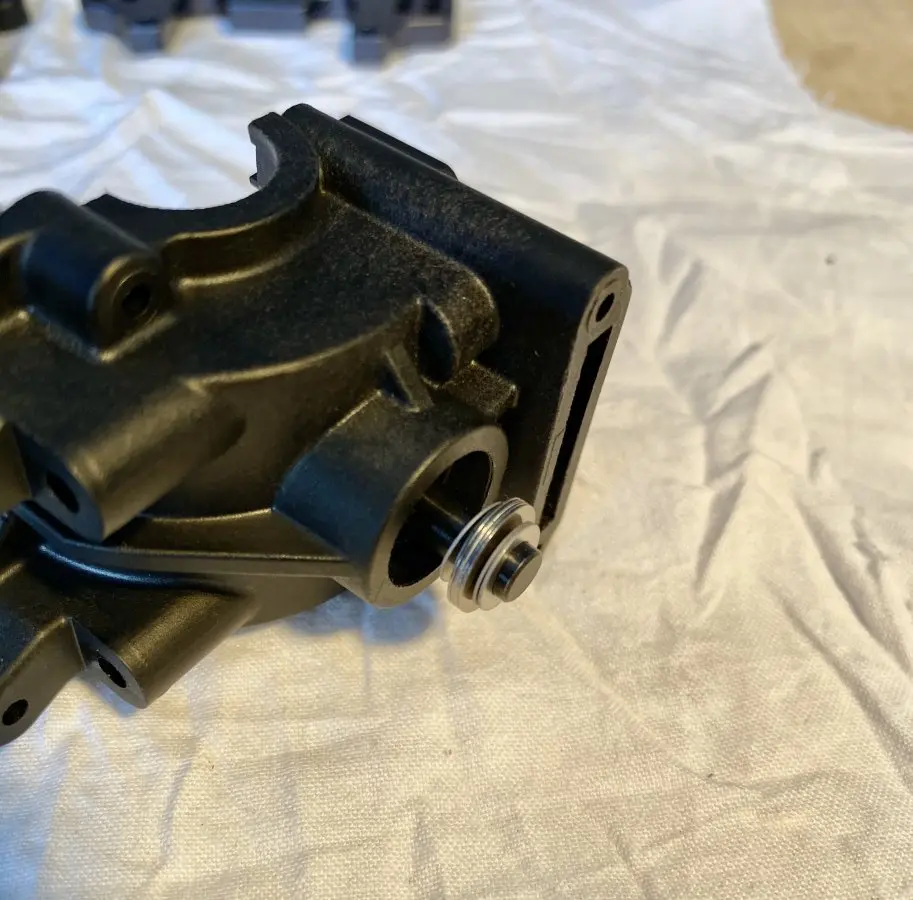

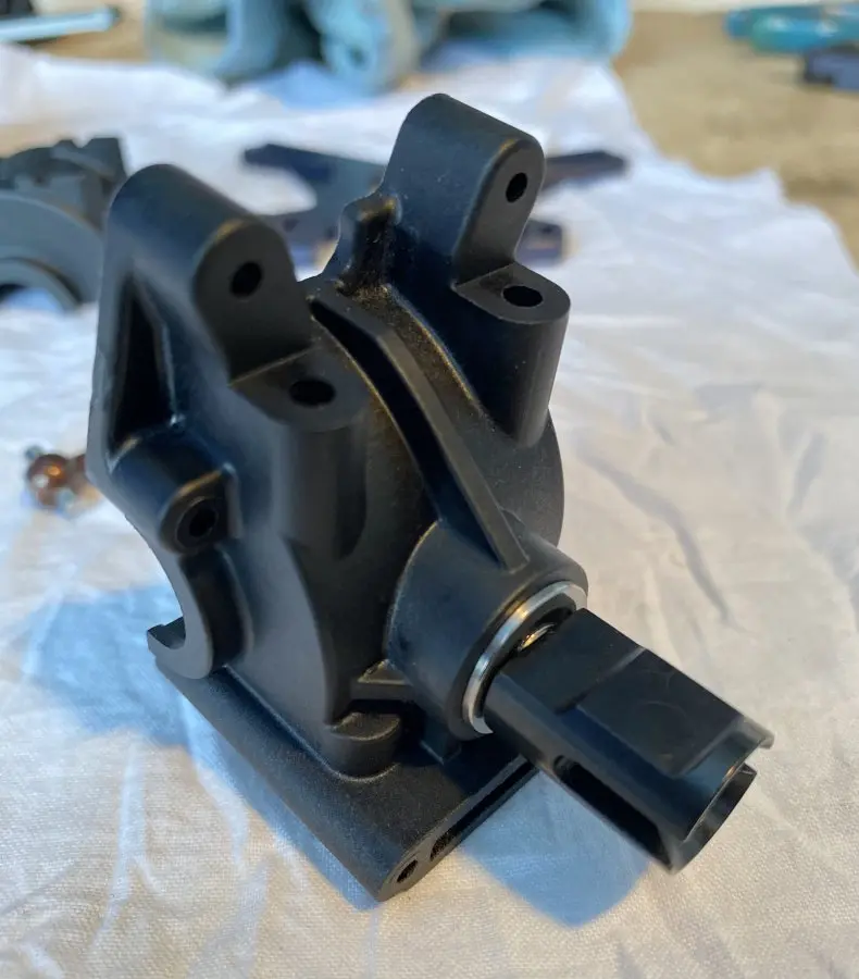

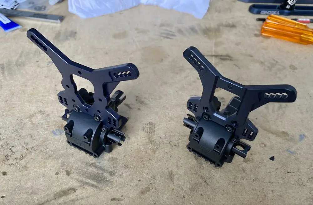

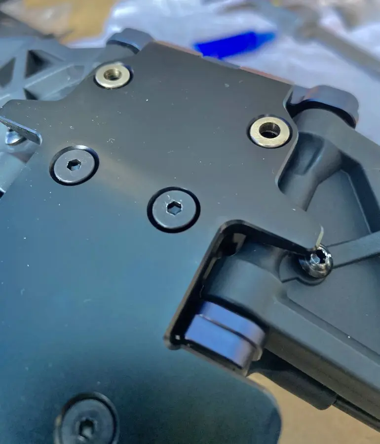

Onto the diff housings F/R, Just the front housing here.. ( forgot some of the pictures πŸ€ͺ )
I'm still really impressed with the fit and finish of this kit..πŸ€™πŸΌ
Front housing goes together just as the manual says, no mods..😁

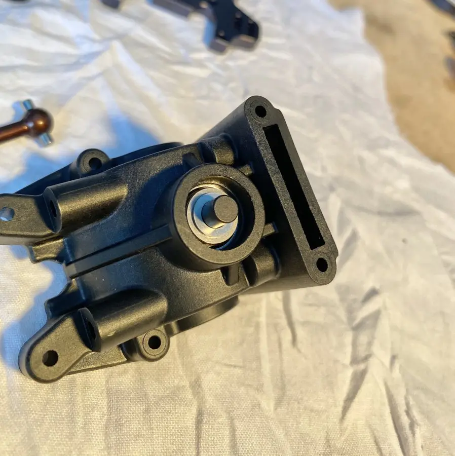

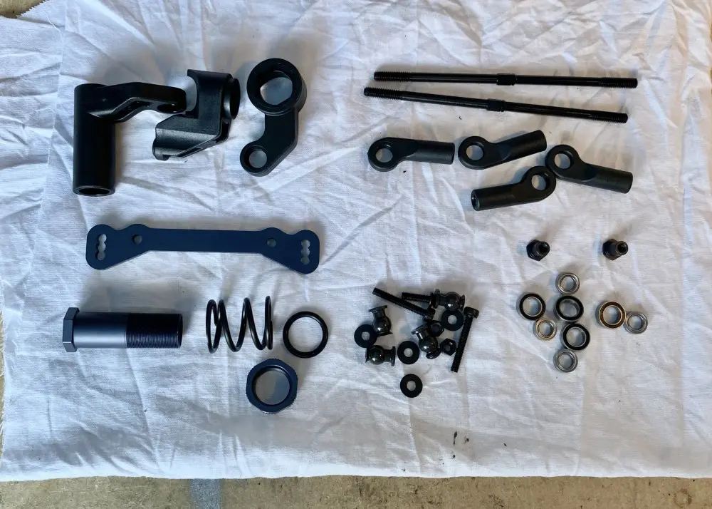

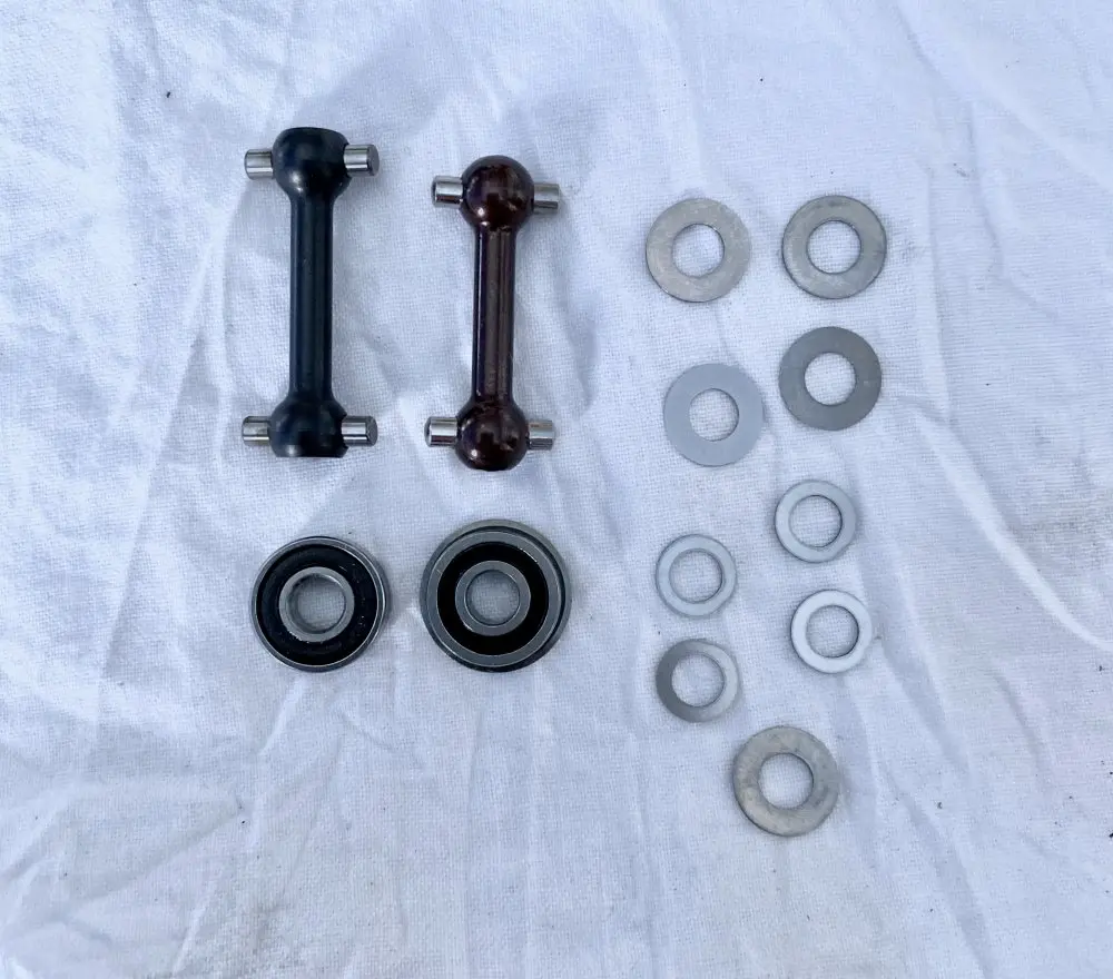

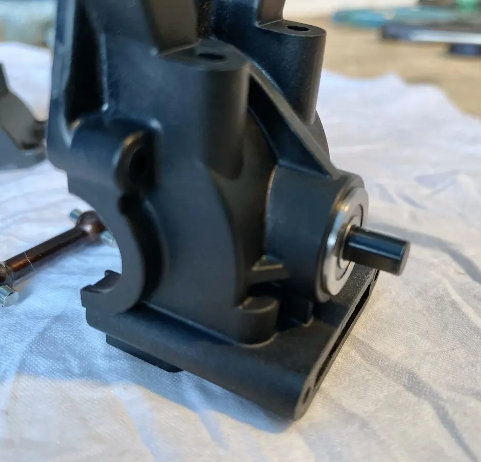

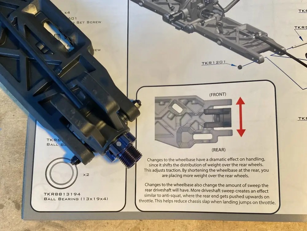

I had read online from numerous different sources that the rear diff bearing can get punched into the diff case causing major damage to the pinion and crown, so I thought I would research what parts were needed to stop such an issue..
Below are the parts I used to convert the rear diff housing to be "bombproof" as they say, it consists of a shorter rear drive shaft, bearing with a flange and 2.45mm of spacers or shims.
( I need to file the ends flat on the dogbone, but that will come later πŸ‘πŸΌ )
Here is the standard bearing and dogbone on the left vs the upgrade parts on the right.πŸ‘πŸΌ

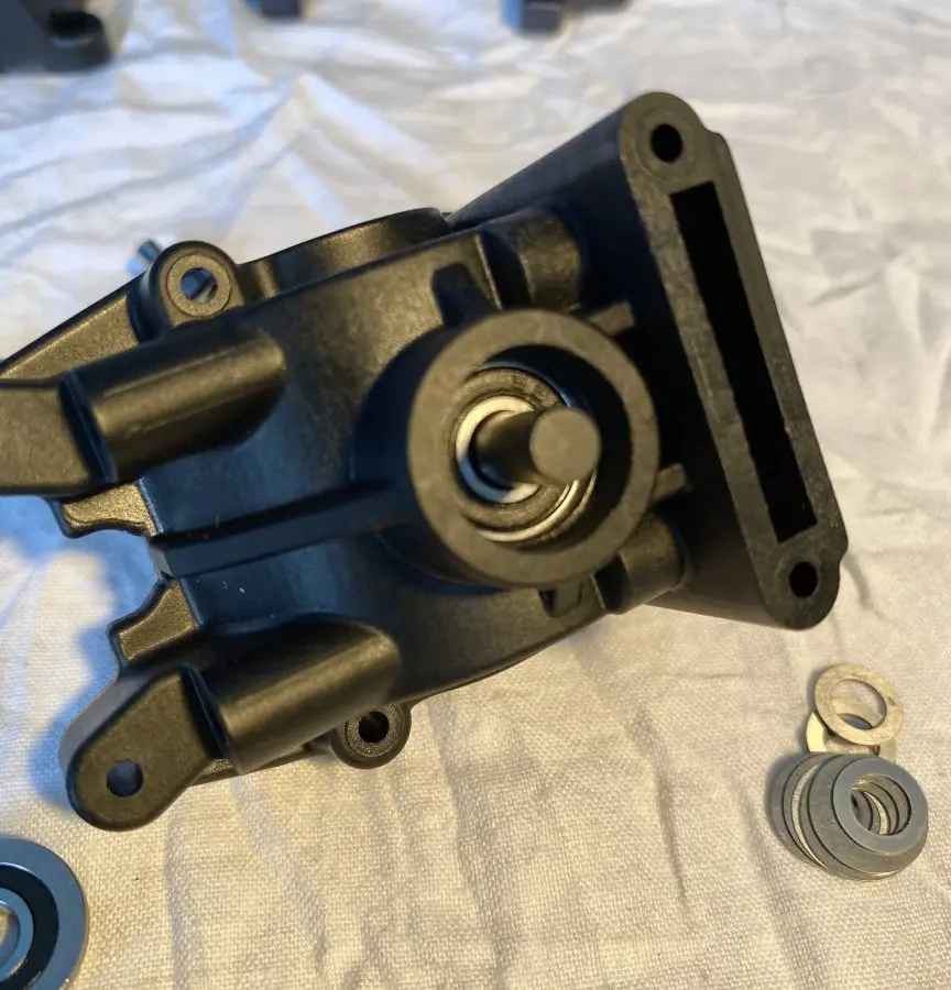

Some install pics of how/where the shims go..😁
And all finally completely built up...πŸ‘πŸΌ

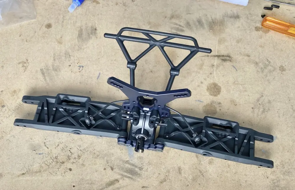

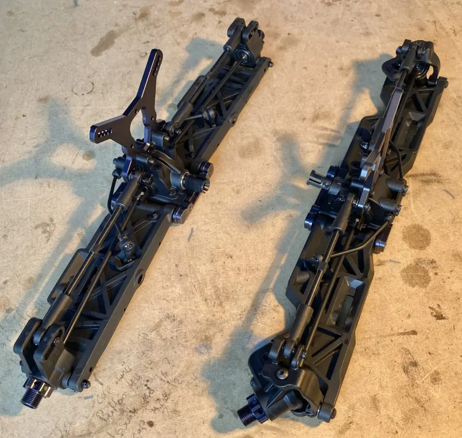

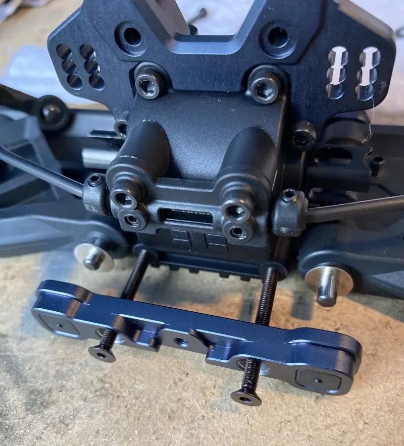

Next onto assembling the rear end together...

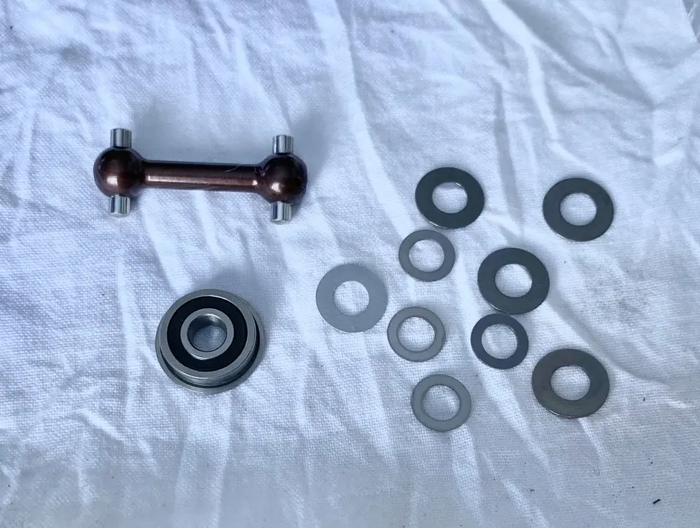

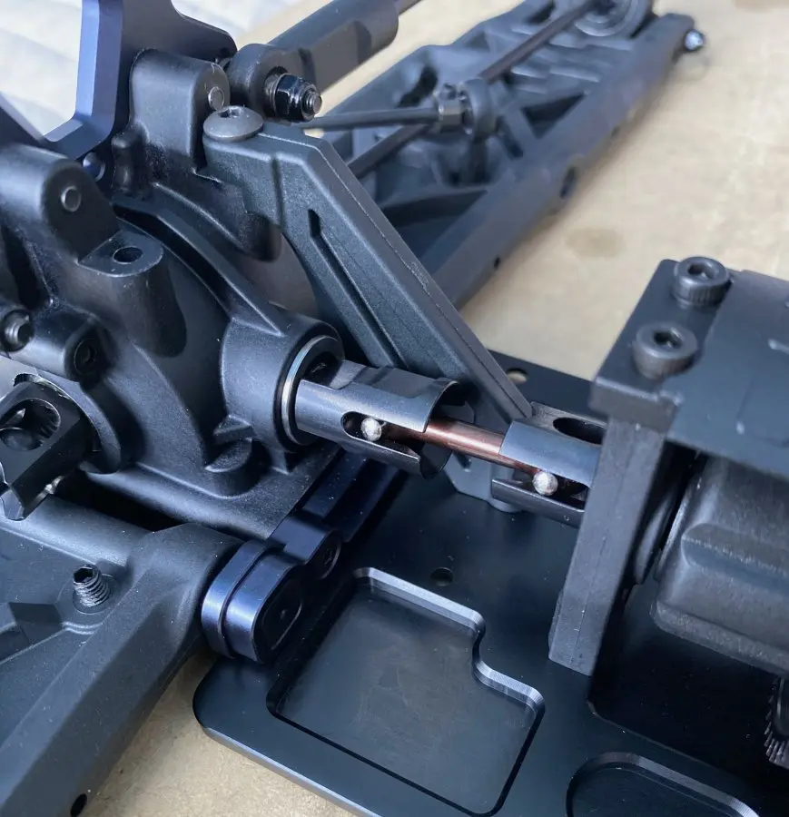

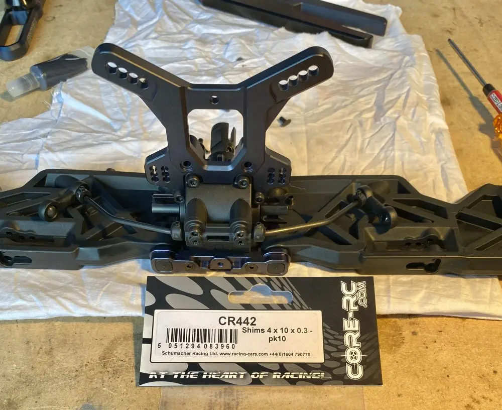

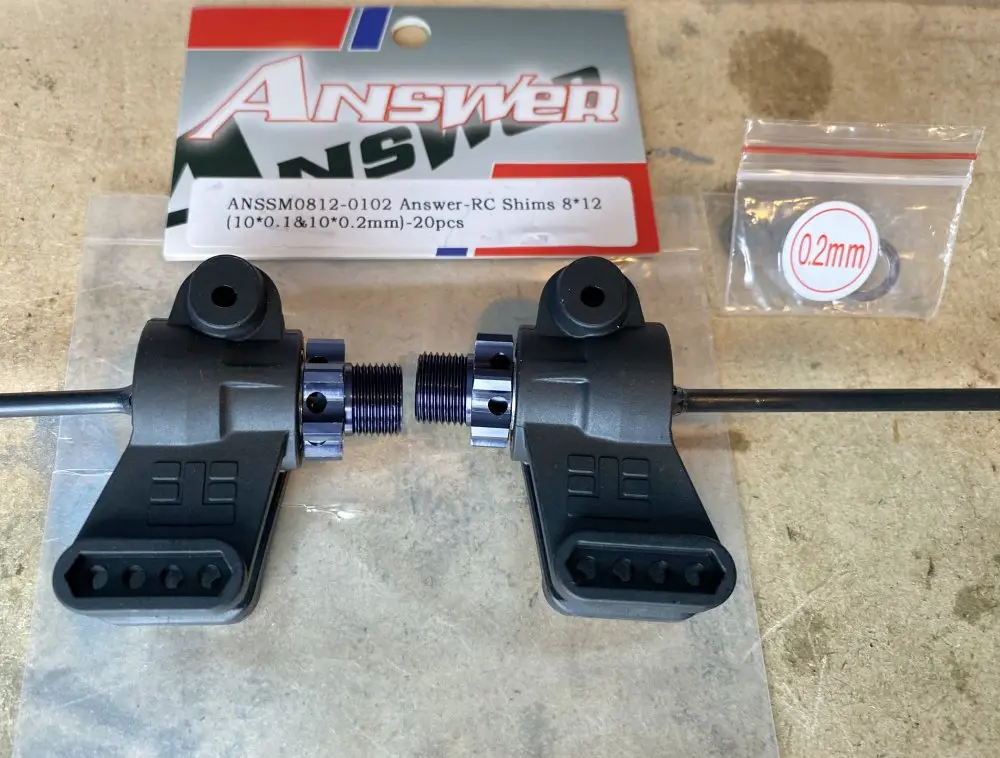

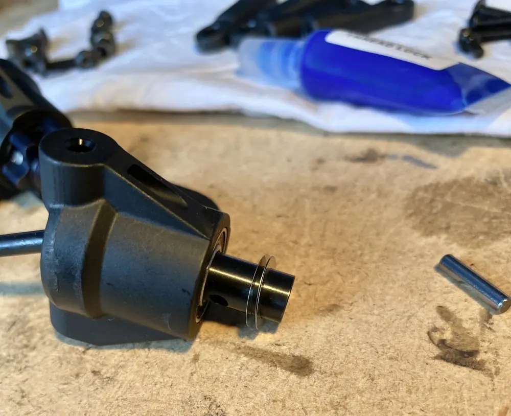

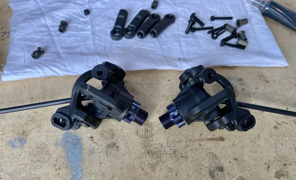

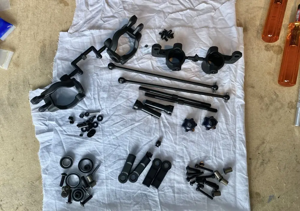

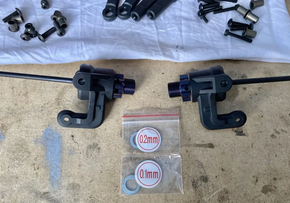

Started on the driveshafts and when I assembled them into the hubs, they needed shims at the hex end as the slop was quite bad.. my first sad moment so far 😩😩
I had to use 2x 0.2mm shims on either side.
That's more shims than I used on my current Arrma's..πŸ€ͺ but it's not all bad though as the hubs are better quality overall..😁
Here are the shims used..πŸ‘πŸΌ

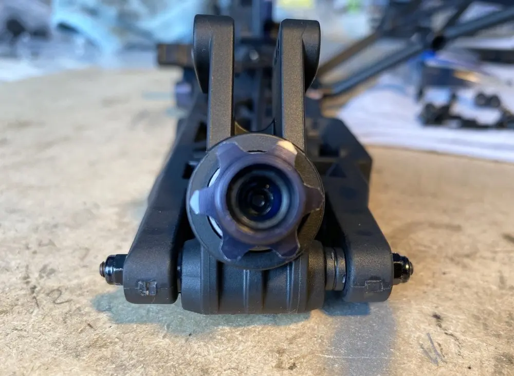

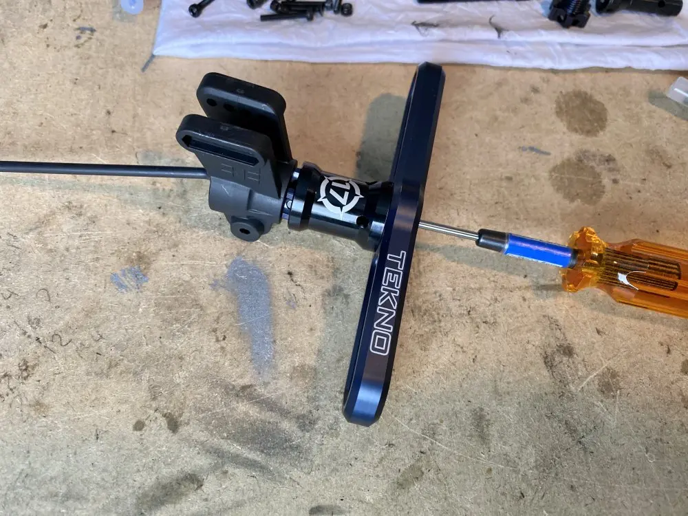

I found yet another use for the wheel nut tool..πŸ€™πŸΌπŸ˜ holding the axle hex whilst tightening the inner grub screw.. ( My bad, I forgot to clean the grub screws so I need to remove them and re-loctite them later.... Cheers @TBuggy for the headsup πŸ‘πŸΌ )

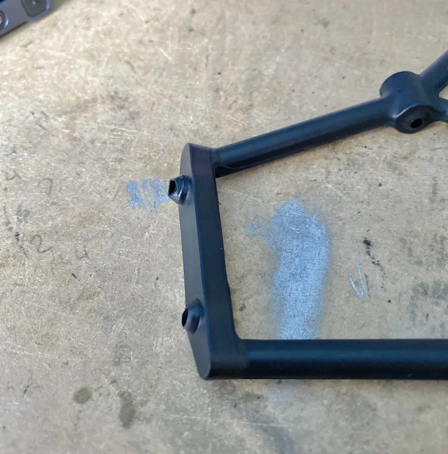

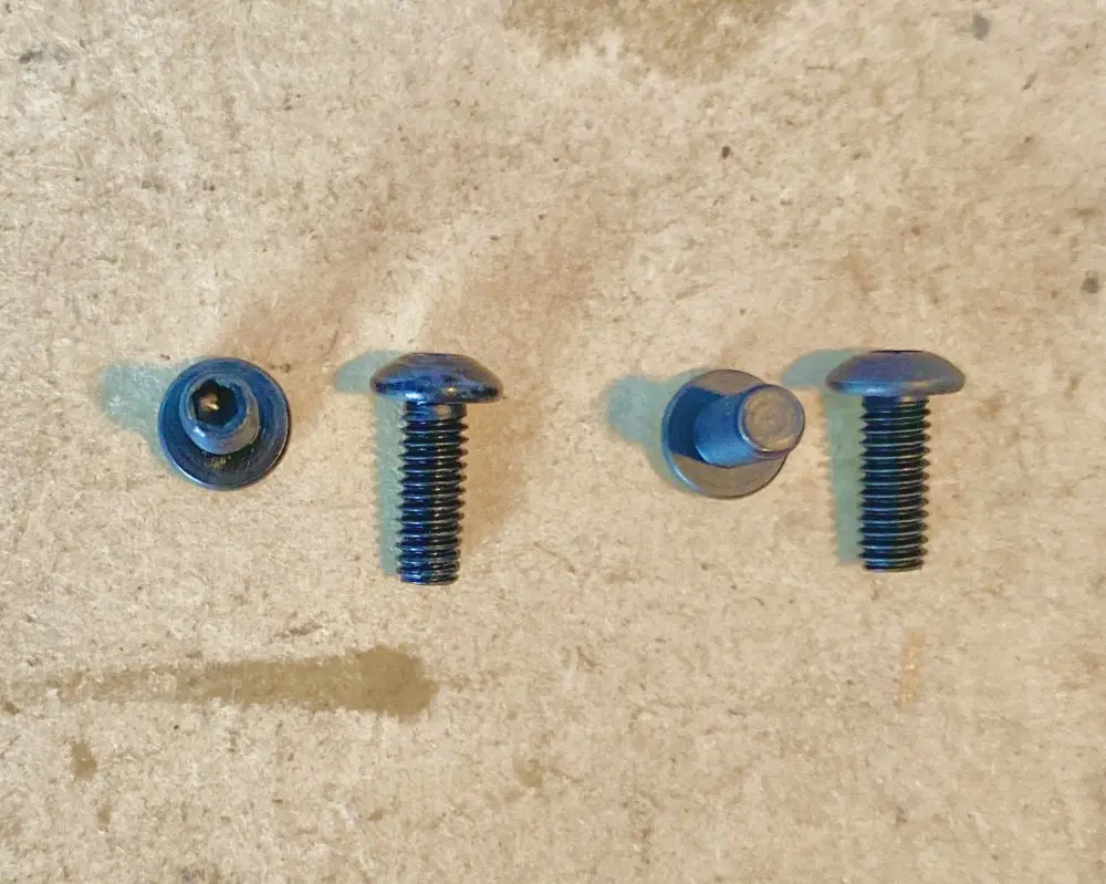

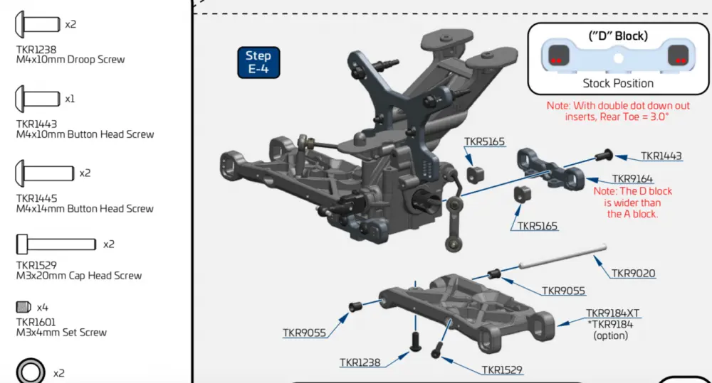

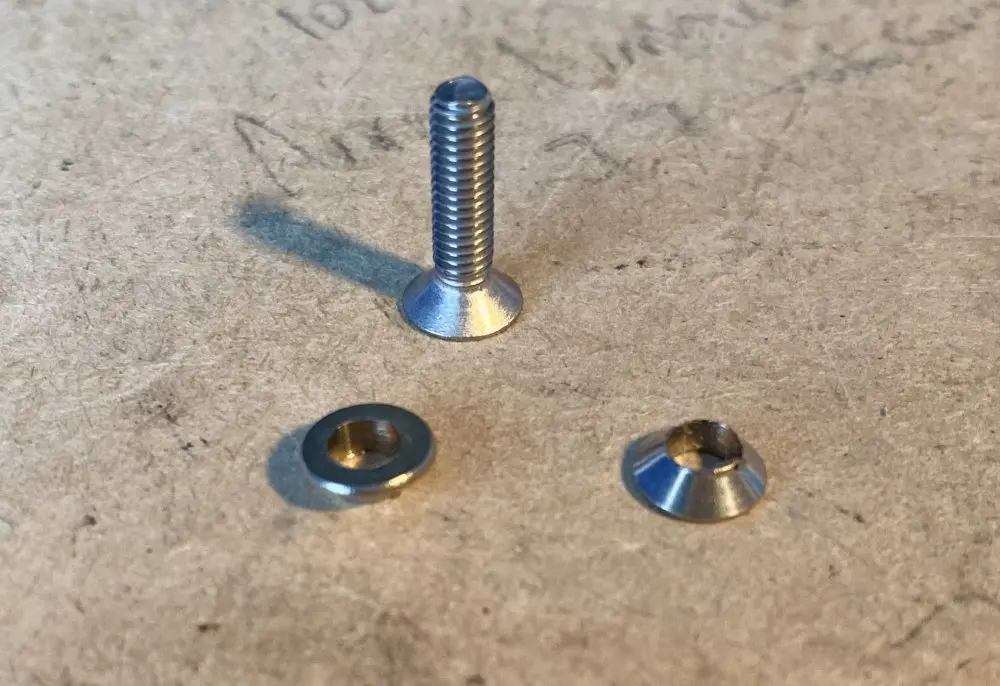

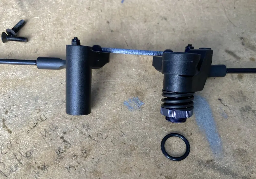

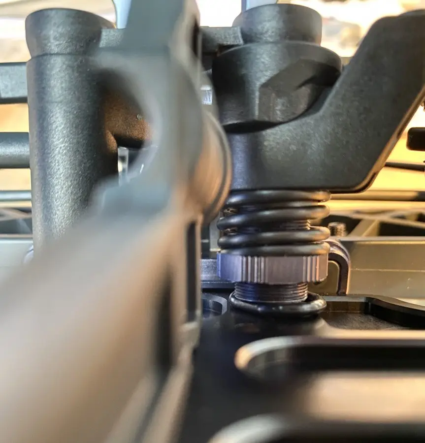

Quick and easy mod to the droop screws, the Tekno ones screw in from the top with just the sharp bolt bottom digging into the chassis so I decided to use some more Arrma parts.πŸ€ͺ

I know this truck was designed from the parts bin as they say, I think I'm correct in saying the rear bumper is from the SCT but in my opinion it just ruined the build.
I'm really disappointed with the design of the rear bumper and I'm sure they could have come up with something better..!! ( Rant over πŸ˜‰ )
The screws just pulled through it as I tightened it up enough to close up the diff housing, so the bumper has just gone to the RC junk pile before the truck has even turned a wheel..😩😩
Don't have any rear bumpers on any of my other trucks or buggy's so not a deal breaker just a shame that the part is pretty πŸ’©πŸ’© .....
View attachment 4500 View attachment 4501
View attachment 4505 View attachment 4506 View attachment 4507 View attachment 4508 View attachment 4509
If you look at the picture below you'll see that the Arrma screw has a hex in both ends, so I've screwed them in from below the arms therefore the button sits on the chassis.
( I hope it works out, I'll find out later πŸ€” )
Jackpot..πŸŽ‰πŸ€ͺ another use for the wheel nut tool... it holds ball ends..!!
No more sore hands for me ever again..😁
Assembling turnbuckles has never been so easy..πŸ€ͺπŸ€™πŸΌ

Question time..?? πŸ€”
Below you can see the hub carrier spacing, just wondered what setting others had used..??

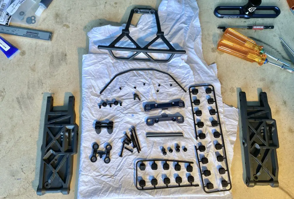

I never understood why Tekno skimps on that droop screw for the MT410. All of their other 1/8 models have the proper droop screws that go in from the bottom and can be adjusted from the top.

Wow, that's really strange that they don't add those droop screws to the MT410 but do with all the others..πŸ€”
I like those Arrma screws - haven't come across that before! Great idea though!
Awesome top on the wheel wrench and ball ends - never knew that! Will keep it in mind for my build!

Time for the front end.
Again everything fits together so nicely, fit and finish are superb..πŸ‘πŸΌ
I found there was some slop on the front arms, front to back play..😩 It was easily sorted with some 0.3mm shims..!!
There is nowhere near as much slop on this car vs my Arrma's but it is still there in some places..😩
Shims 4x10x0.3mm are what I used, only one per side..πŸ‘πŸΌ slop now totally gone.
Hex hubs again needed shims left was 0.3mm, right 0.4mm ( 8x12mm )
Also this time I remembered to clean off the factory oil from the grub screws before adding loctite..😁 ( thanks again @TBuggy for the heads up πŸ‘πŸΌ )
Completed front c hub with drive shafts and hex hubs, all went together perfectly..πŸ‘πŸΌ
Finally the completed front/rear suspensions ready to be mounted on chassis..
Everything feels so light compared to my Arrma's..πŸ˜‰
Onto the servo saver, this gave me a bit of head scratching..πŸ€”
I'll explain more a bit further down the page..!!
So here is the servo saver built up as per the instructions, spring tightened up fully then backed off 3 complete turns..πŸ€” to me though it seems extremely tight..!!
I also fitted that O-ring on the bottom, but it doesn't do anything that I can tell..πŸ€ͺ
My O-ring isn't tight, in fact it's so loose as you can see in the pic it just falls off the bottom of the servo saver..😩 it even states in the instructions to lube if it's a tight fit..🀣
Can someone please explain what that O-ring is supposed to do..??
Another mod I always do is to use these small homemade conical spacers, they go in the chassis and stop bumpers and skid plates from having the screws pull through them..πŸ€™πŸΌ
( anyone that has used T-bone bumpers knows what I'm talking about..πŸ˜‰ )
As you can see below, they are just made out of stainless steel M4 bolts that you just drill the heads off with a 4mm drill..πŸ‘πŸΌ
These are super cheap to make and will make your bumpers/skids last so much longer..πŸ‘πŸΌπŸ˜
Onto the diff holder / motor mount, I'm a bit torn on this one as one part of me thinks it's a really good motor mount but the diff holder seems a bit half assed to me..πŸ€”
Personally though I think a v4 Arrma diff holder is a better design..πŸ˜‰
In saying that though, there is no side to side play whatsoever with the Tekno one..!!
I'll just have to see how it goes..πŸ‘πŸΌ I'm quite happy to be proved wrong..
Is the 7075 option part worth the extra money..?? please let me know..
As you can see below here is the flanged bearing and shortened drive shaft for the "bombproof diff case mod" πŸ˜‰.. lets just see how that's goes in the future..πŸ‘πŸΌ
All bolted up and ready for the next stage.. No issues fitting it all together, I noticed it is quite flexible in its current state..πŸ€” is this good or bad I'm truly not sure quite yet, only time will tell..πŸ˜‰

Flex is good for control when conditions are rough. But if you are into doing flips and such then you may want to sacrifice better handling for durability by adding stiffer braces.
That o-ring needs to be seated inside the groove of that collar. It keeps the collar put so it doesn't back off while running.
You will need to take the steering assembly back off to fix that. Make sure to add some grease to the o-ring so you can adjust it without tearing it.
It's the same situation as the collars on the shocks.
Good catch. I got some sore hands from putting that nut on with the spring there.
Bearing in mind the O-Ring is there to stop the collar from backing off etc, wouldn't putting grease on the o-ring make it more prone to slipping?
I know its mentioned in the manual too, but was just wondering whether its counter productive in the long run?
The grease helps when spinning the nut smoother when threading the nut to tighten the spring. It is pretty hard to spin this but with the spring pressure.
When you have it in place where it goes, you will understand the need for the grease. I have installed them without grease and the threads tear the o-rings up in the process. It is plenty tight to hold things in place when grease is appplied.
