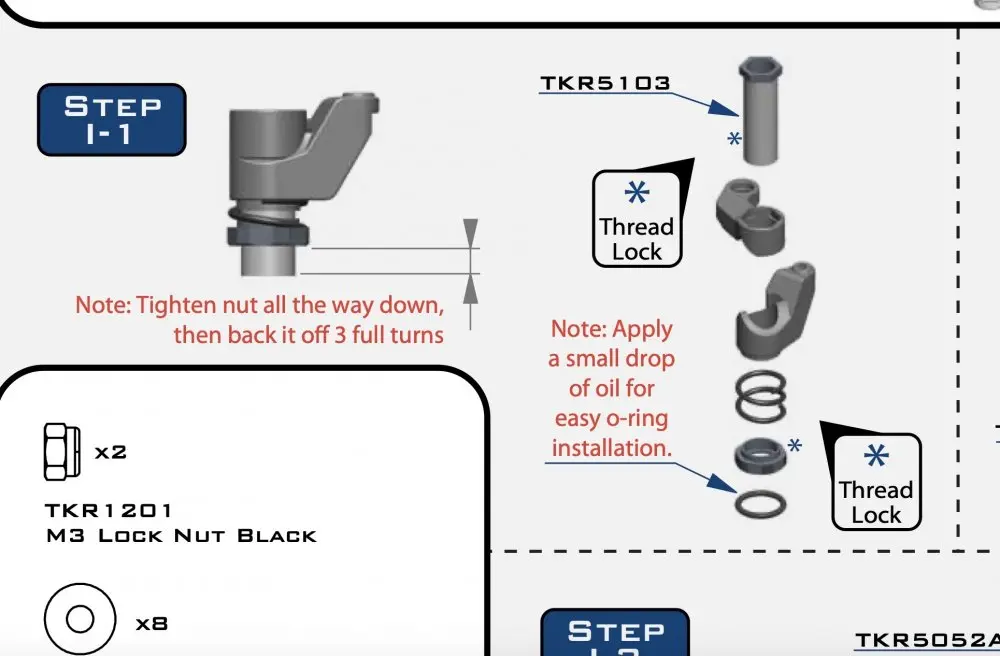

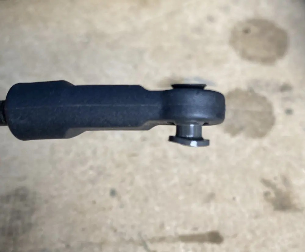

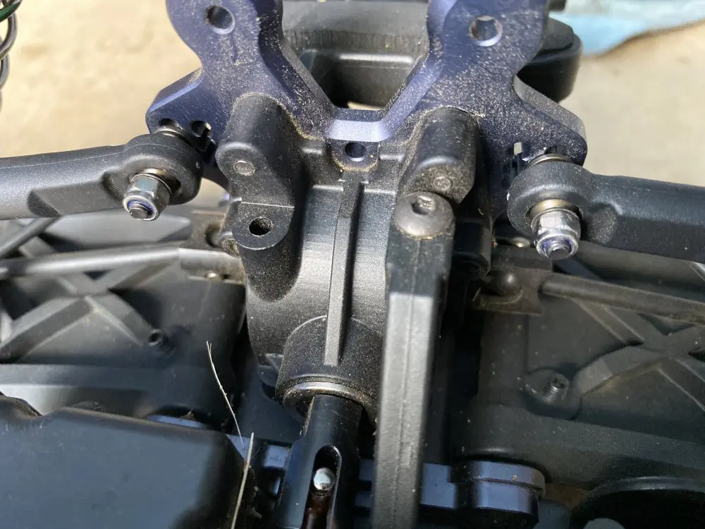

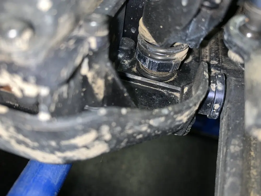

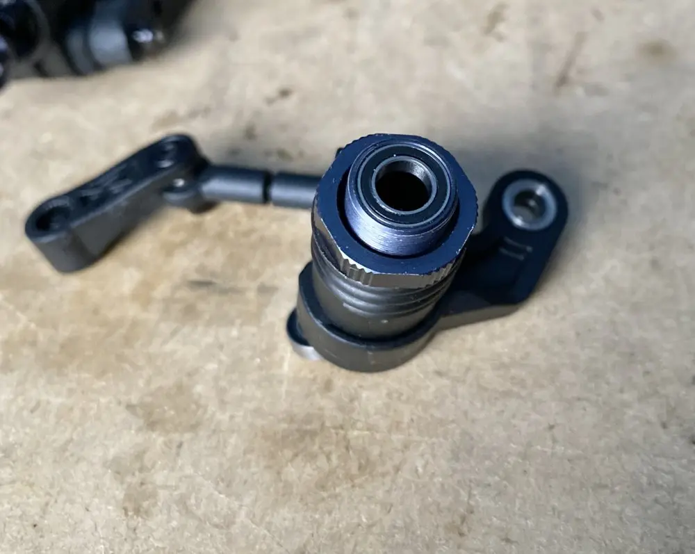

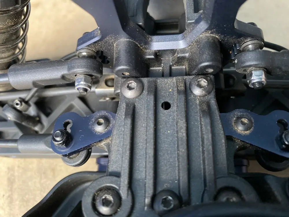

That o-ring needs to be seated inside the groove of that collar. It keeps the collar put so it doesn't back off while running.
You will need to take the steering assembly back off to fix that. Make sure to add some grease to the o-ring so you can adjust it without tearing it.
It's the same situation as the collars on the shocks.
Thanks @TBuggy , Now I understand where that o-ring goes ??
The manual was really good up till now, but it really doesn't clearly show where that o-ring goes..?
Also, as the pic below shows, why would you need to fit an o-ring to stop the collar moving when it clearly shows put loctite on the threaded shaft..?
I'll tear it down tomorrow and make it right..??

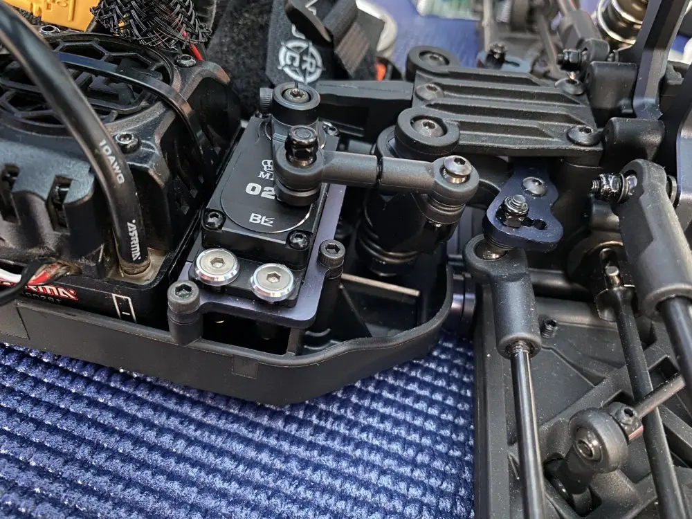

Having completed mine a few days ago and already stripping the plastic servo horn, I'm skeptical about the "back if off 3 full turns" in the manual here. I think w/ the plastic horn, you need to back it off 5-6 turns and live with a little more steering slop.
As others here suggested, I ordered the metal horn which will work fine w/ the above servo saver adjustment, but I was floored that the plastic one died after only three 3S test runs in the grass (and over a small ramp) in my back yard.
TL;DR; - if you plan on using the included servo horn, back off the servo saver more than the 3 suggested turns! :)

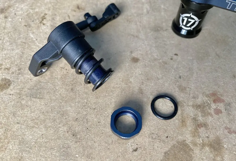

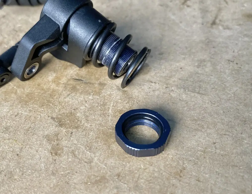

2nd try, this time with correct assembly of the servo saver..??
Backed off the spring 4 turns this time and didn't put any new loctite on the thread..
Using the Tekno wheel nut tool it's so simple to install the nut, I did put some lube on the
O-ring as advised to stop it from tearing..??
I'm still waiting on my metal servo horn..!! will use the stock plastic one for now..?

Wow after a whole year I just found out I put the O-ring in the wrong spot lol. Never had any issues with it, I did use the Loctite like they said and it has not backed out. I did wonder what it was there for but I guess I was so into the fun of the build that I just kept going.

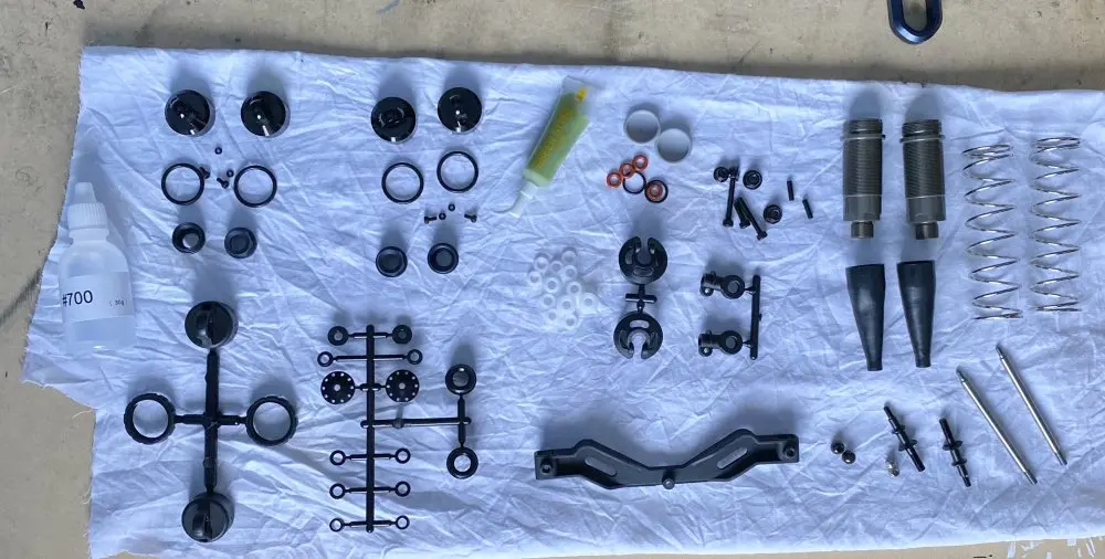

Shocks were the next job, I used the stock 700cst oil but added a few upgrades to the shocks as I couldn't help myself ?
Not many pic's as I'm sure you've all seen shocks before ?
All went together perfectly, I used plenty of green slime on all the o-rings and associated parts..? best shocks I've ever built hands down..??

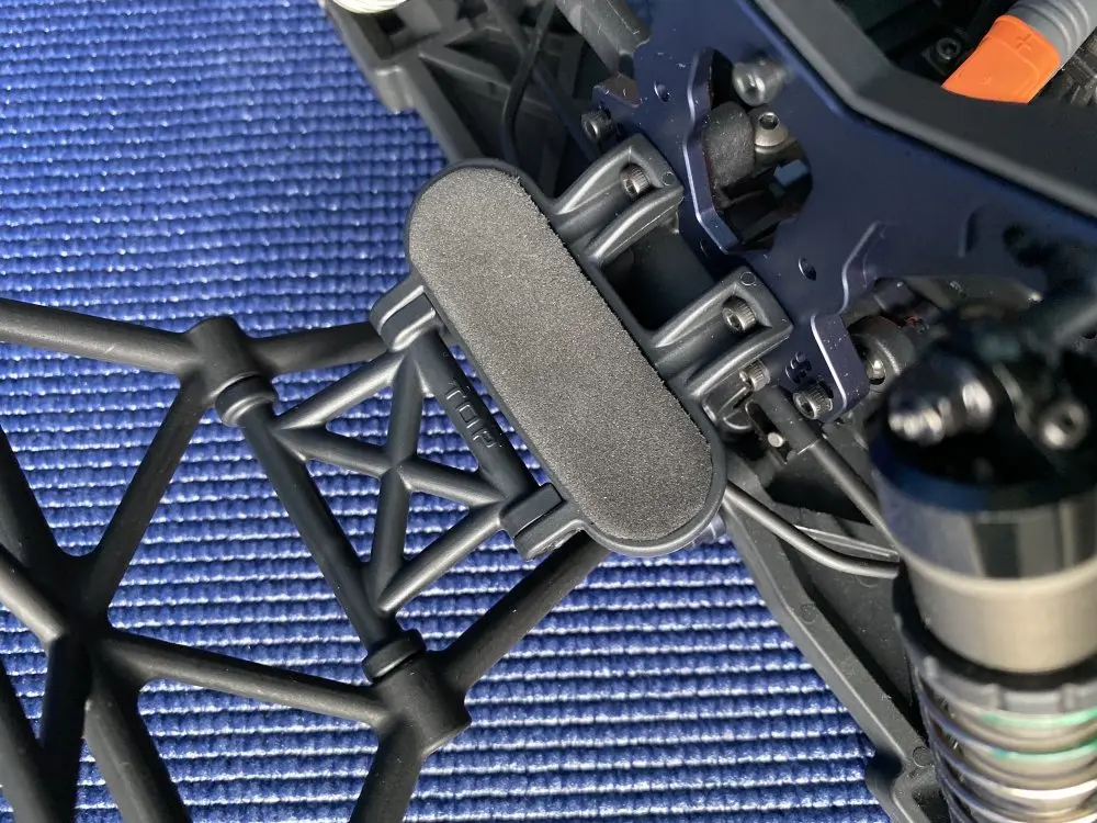

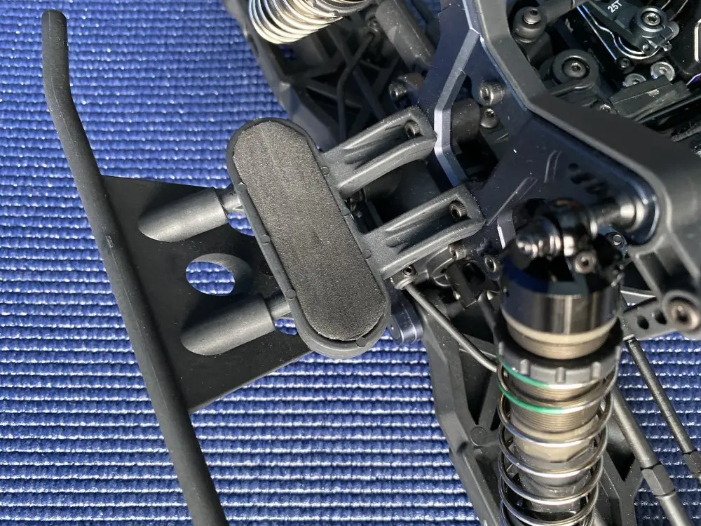

Quick bumper upgrade that I got told about, add hardish foam into the holes in the top part as it stops the bumper from breaking..? I'll soon let you know if it works.

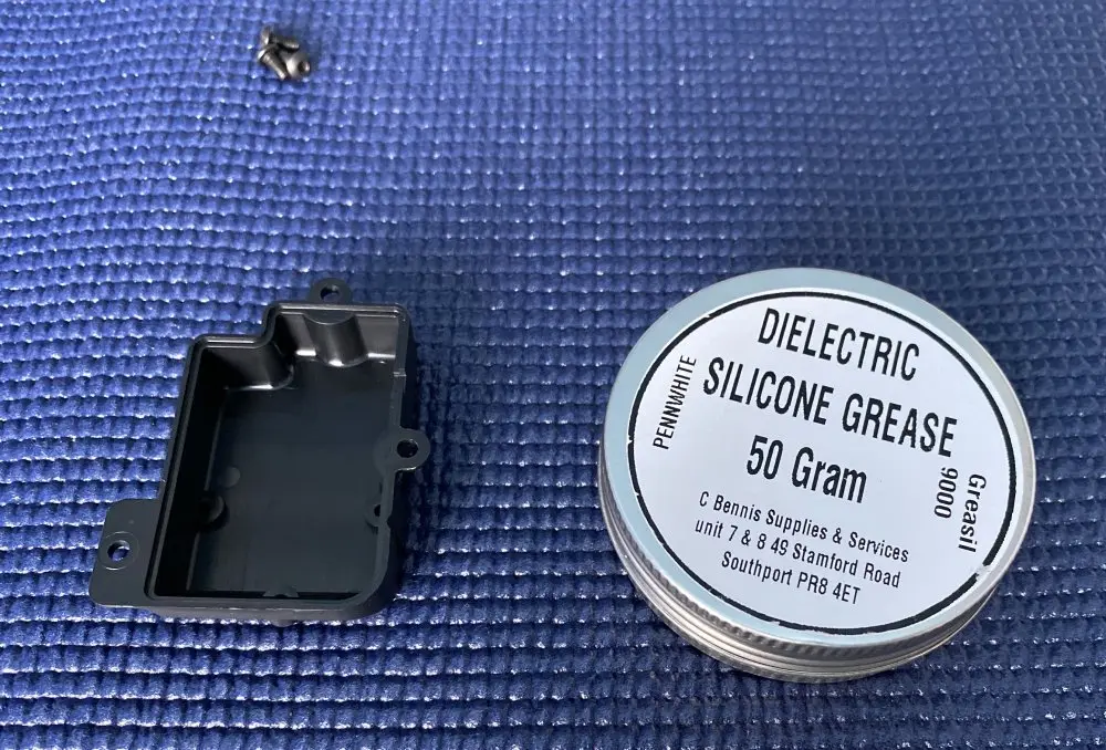

Little trick to seal the RX box is I use this stuff below, it has mega water proofing qualities.??
can be used to waterproof all sorts of electronics amongst other things...

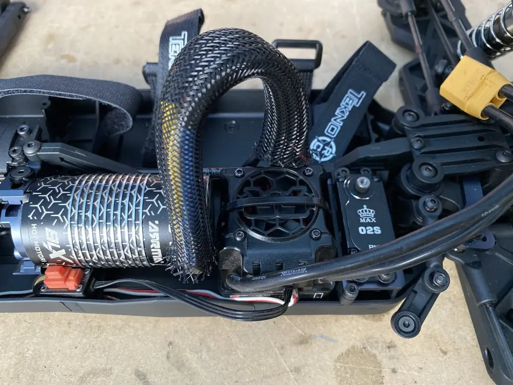

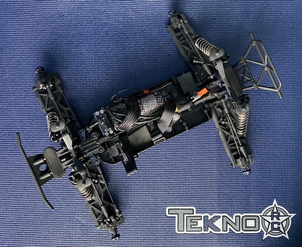

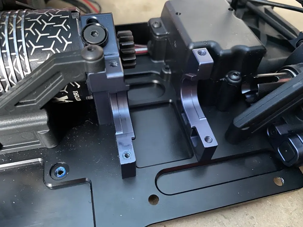

Last but not least are the electronics etc, so in the end I've gone with a spare Arrma setup as I had it lying around, went with 15T Tekno pinion with Arrma Copperhead 2 tyres also treated myself to a new servo too..? 6s here I come..!!
My other choices that I have for electronics are a HW Max8 esc also a couple of long can Rocket motors, but I've been looking at a 1550kv TPpower motor..?
Tyre choices are the Copperheads, Backflip LP's and Badlands I'll try them all and see what I like best..!!
If this thing isn't an absolute animal I will be very pi55ed..???

I have moved the servo arm to the inner hole since these pic's were taken.

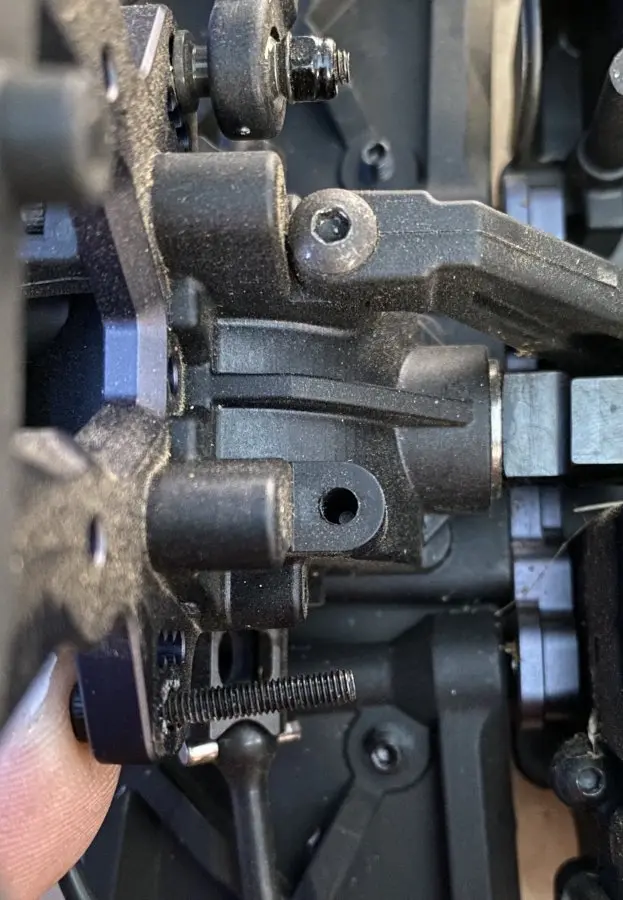

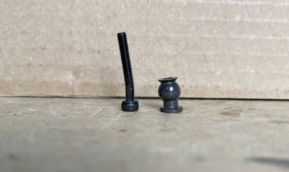

So what had happened was the locknut had worked loose allowing the turnbuckle to move up and down, back and forth..!!?
The damaged was the bolt and ball, lucky I had some spare balls to hand from when I modded my Infraction..
I've never bent my balls before..????

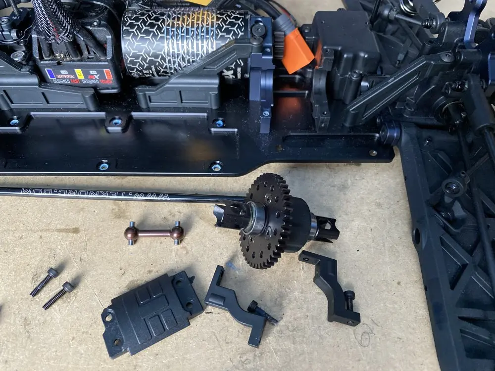

When I got home I took the truck apart because I wanted to check the rest of the locknuts, to my surprise I was able to completely screw the locknuts on by hand just with my fingers..!! so the locknuts weren't actually locking, easy fix though as I have some better M3 locknuts fitted now that I can't just screw on by hand..?
I checked the other locknuts on the shock standoffs and they were loose also, they were fixed with a small amount of loctite as I don't have any M4 locknuts with flanges..??
I'm going to replace all the Tekno locknuts soon..!!
( shame on you Tekno for supplying ? nuts )

I cant believe all those locknuts backed out on you!? is their a particular brand of aftermarket ones you use or are any aftermarket nut better then the tekno? i will be definitely investing in new locknuts.
Luckily I had some stainless steel ones in my tool box, just have a look on Ebay/amazon for M3 Nyloc nuts.
I do believe I must of had a duff batch, because everything else Tekno was/is amazing ?

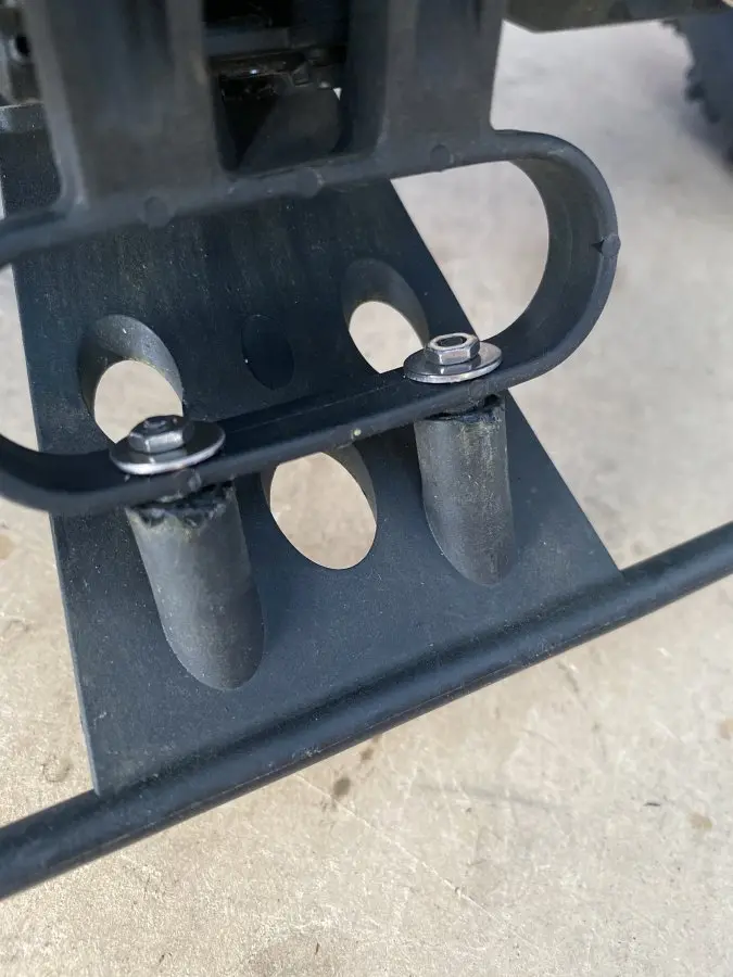

Broke my bumper, lost my foam..?
Fixed my bumper..?
Need new foam and have to remember to glue it in this time..!!
