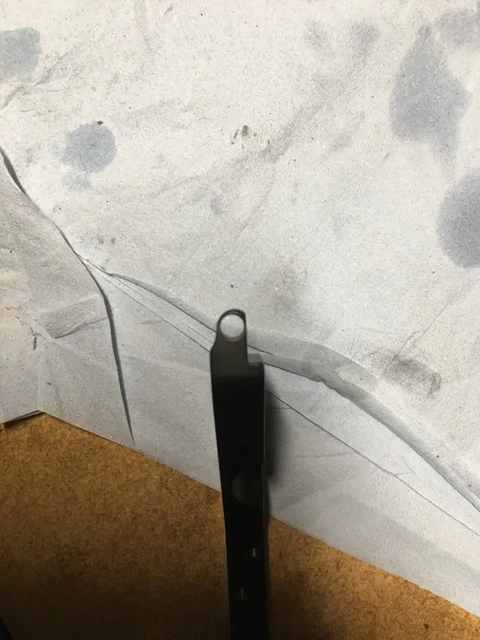

Any of you guys had a problem with the M2C centre brace? On another Tekno forum one guy’s M2C brace broke at that thin point, I’ve just had a look at mine and it is really thin!! I’m a bit dubious about putting it on now?? Your thoughts?
Yes, mine broke right there where it attaches to the center diff. Also ran into another guy on a Facebook group who's also broke in the same spot. Lucky for me Amain is refunding me the money. I have also been in contact with m2c about the issue, they will be redesigning this part to somehow strengthen it up. I had an idea but didnt tell them as its prob not very good lol. Instead of the brace stopping at that one screw, extend the whole thing so that it becomes the center diff top plate.
I returned mine due to the weird fit., and it wouldn't fit under my steering plate for some reason. i think it needs a revision personally. i thought about cutting it in half so I'd have a front and rear like the stock braces and then could wrestle with it easier but decided to go back to the factory braces which fit perfectly of course... maybe in the future if i break a front plastic brace i'll pick up another m2c and cut it in half and use just the front.
What a great idea my friend! I got my money back from m2c I had trouble fitting it! it just wouldn’t fit both ends without serious effort to locate both end bolts, but as for cutting in half is a great idea and will do that! Thanks mate!

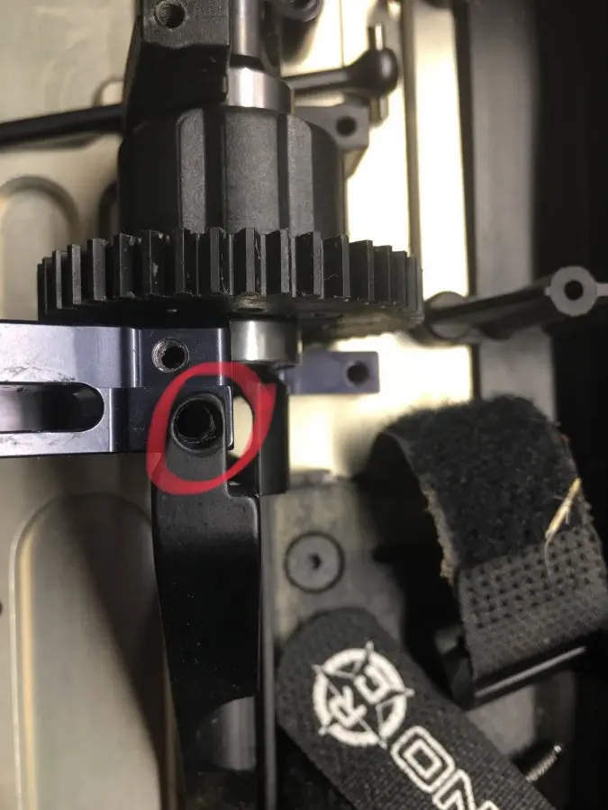

I posted this issue I ran into on my DB48 build thread. It’s unlikely everyone is interested in building a DB so I’m going to post it here too, in hopes to bring more attention to it.
After I just received my m2c parts, people posted that there is a week spot on the chassis brace. I believe m2c said they will replace that which is nice.

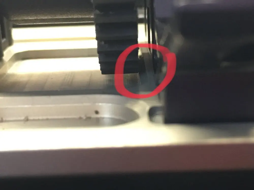

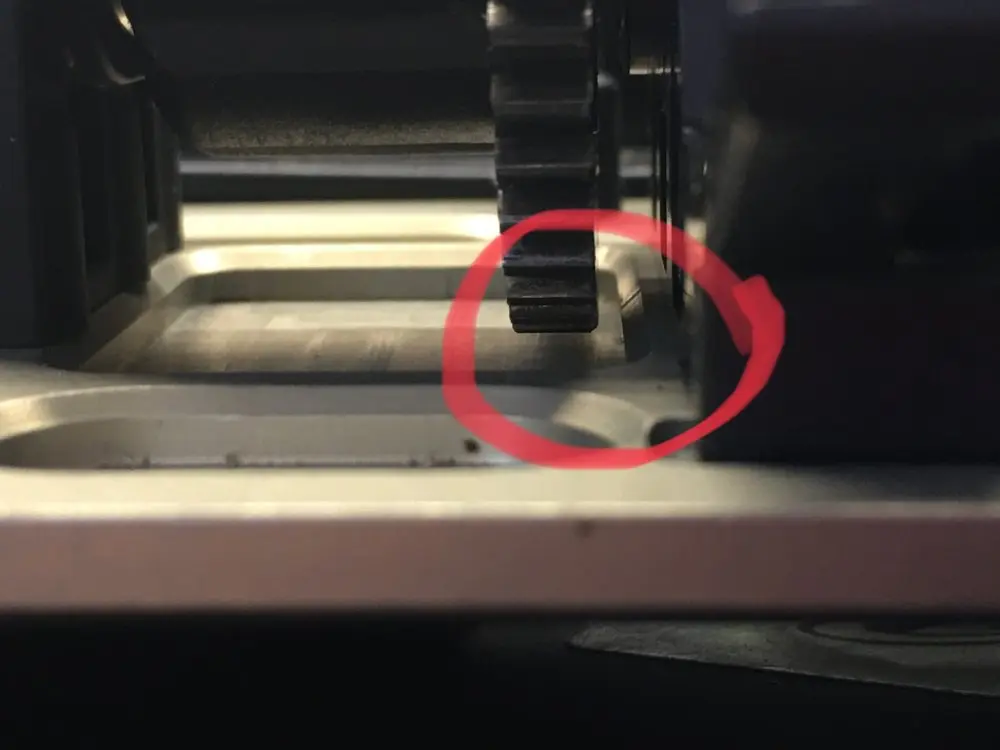

Here is another issue that I just figured out. During my build I noticed the center diff would rub somewhere I couldn’t see. I spent a few hours and just couldn’t figure it out. Took things apart, put them back together, tightened, loosened... I finally gave up thinking it’s a warped spur. I took the center diff from my MT and dropped it in my DB and It fixed the problem. Everything rotated smoothly. My MT diff spur is the lightened steel one. At this point I still thought the issue was the plastic one not being straight.
Today I was on amain ordering a new rotor for my tekin motor and I noticed there was a new review on the m2c chassis. It was a 1 star review which I found interesting since I haven’t seen anything bad about the chassis. It mentions how his spur gear rubbed on his chassis and he had to round down his spur to make it work. I of course jumped over to mine to see if that’s the issue. It sure is.
This is the steel spur and you can see that the thinner diameter allows plenty of clearance from the chassis.
This is the stock spur. It rubs more than the picture shows because, the plastic spur has a small wobble due to the fact they can’t mold the plastic one to perfection.
this is the m2c Et48 chassis
Interesting. I have the m2c chassis as well and am using the stock composite spur (for now). I dont seem to have any rub on the spur/chassis but if I push the spur/diff towards the dip in the chassis it gets mighty close. Perhaps m2c went off the assumption that anyone using m2c chassis will be using metal spurs?
edit...a small shime will fix this. I am not sure of the size, think about the front/rear diffs, the shim that goes to the outside of the bearing.
After I just received my m2c parts, people posted that there is a week spot on the chassis brace. I believe m2c said they will replace that which is nice.View attachment 716
This is the steel spur and you can see that the thinner diameter allows plenty of clearance from the chassis.View attachment 717
This is the stock spur. It rubs more than the picture shows because, the plastic spur has a small wobble due to the fact they can’t mold the plastic one to perfection.View attachment 718this is the m2c Et48 chassis
A little late chiming in here, but I had issues getting my spur gear to not rub on my ET48.3. The solution was to tighten my spur gear on my differential even more. I had to crank it down until the diff couldn't move freely, then loosen it back off bout 1/8 of a turn. And then it was moving freely AND the spur could move without rubbing on the inside. I don't recall mine rubbing in that spot though. It was rubbing somewhere though.
