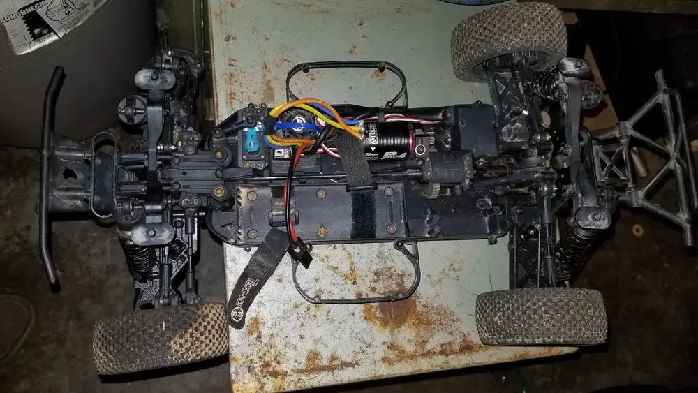

Howdy Gang!
I finally joined the Tekno family, with a well used SCT410. I got this truck real cheap, and it will be kind of a restoration, as much as anything. I am not sure if it is a .1 or a .3 It did come with a Tekin Pro4 motor, a HW "JustStock" ESC (Will that tiny ESC run that Pro4?), a servo (off brand, but supposed to be great?), and a box of used tires (mixed SCT and Truggy) for $200. No body, one corner is missing the hex/pin/cvd pin, and there is a bit of surfice rust on lots of screws, and most of the outdrives/dogbones. Front right arm (same one missing the hex) has a bad creak and is binding a bit. 2 shocks leaking, and no shock boots. And a broke front bumper. So yeah, this will be a project. :)

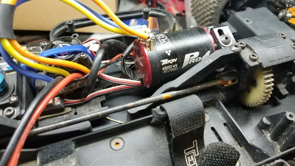

  • ESC - will this JustStock ESC be able to survive powering a Pro4 4800 motor? I worry about this. Maybe ESC swap.
  • Motor - Maybe throw my BLX185 combo in there and run on 4s?

No that Justock can only handle up to a 13.5T motor, I would install a HobbyWing XR8 SCT Pro or V3.1
Your car looks like a .1 if I had to guess, easy way to tell is look at the pill inserts, if they are oval shaped then it's a .1 if they are square shaped then it's a .3

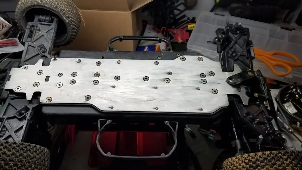

I had a few minutes to start tearing into it. Still have not downloaded a manual, need to.
First - pulled the (3) tires. Each had a washer between the wheel and the hex - is that normal for Tekno? Also found one rounded hex. Speaking of the wheel hexes - they were plastic. That supprised me, I figured on metal hexs. No big deal here, as I had already planned on buying a set of the Tekno locking aluminum hexes.
Also I wanted to pull the electronics out. I started in on the motor - I'd not used a Tekno sliding motor mount. Got the screw out of the top, but the motor would not budge. Great, I though, the mount is corroded and locked up. I pulled the 7 screws on the bottom of the chassis to remove the whole motor/diff/forward brace, and find another screw on the bottom of the slider? Got that one out, and the motor moves free - felt like I had dodged a bullet. LOL Yeah, I gotta get that manual downloaded.

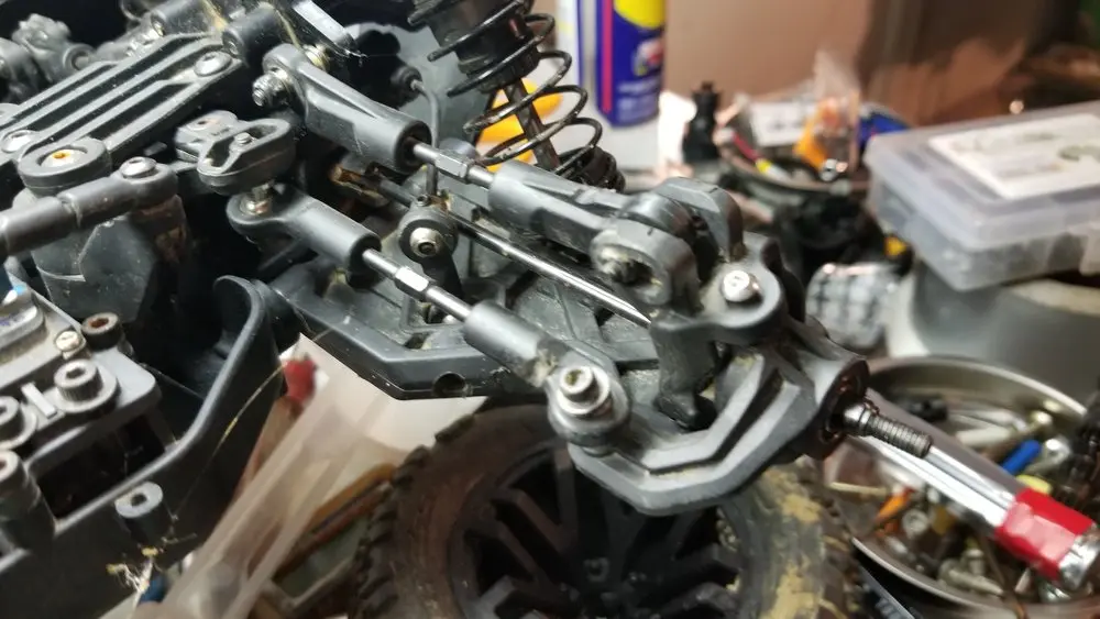

Got another small window to play with the car. Found out the creaky / binding suspension was because of a screw that was too tight. I backed off both of these screws about a half a turn from tight, and it is all smooth now. Is this right? Should I be able to tighten these screws down, or is this a adjust as needed screw?
That’s interesting. Should be fine. It was probably screwed down so tight it was binding. Might throw some grease between the bushing and plastic. That might help too.
