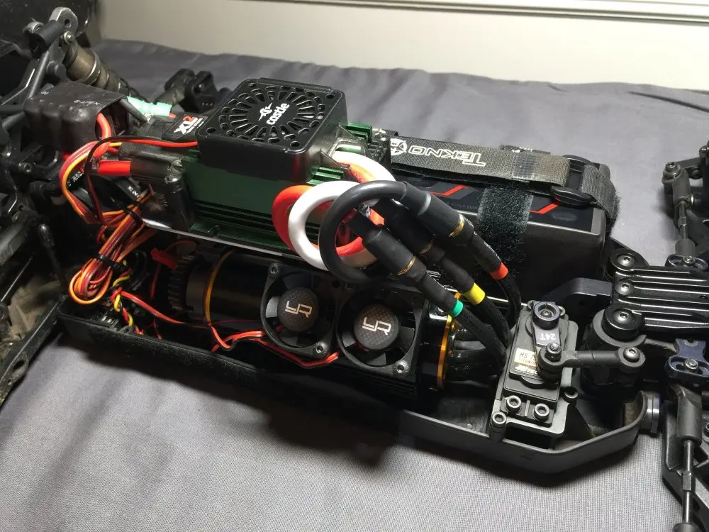

Here is my configuration:
I have the custom plate, max6 and i'll receive next week my new motor, a leopard 4092 1300kv. I hope it won't run too hot

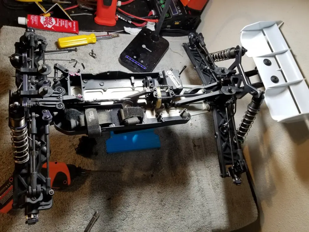

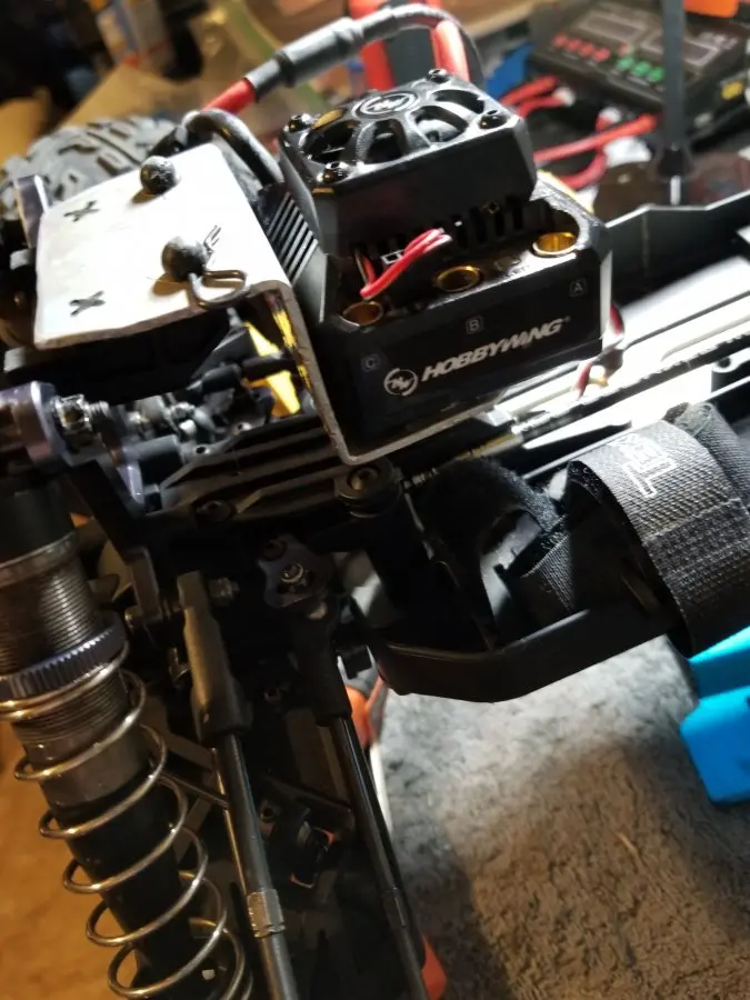

My et48.3 has arrived! I am overwhelmed and want to dive in but don't know where to begin lol. Think I'll let the nerves settle before I get on it. Going to need to solve the ESC thing for sure.
The homemade ESC mount it come with, works but not ideal.

That esc mount looks like something Chainsaw or I would do... as for where to start, tear it down one section at a time and go thru it...I just got my et48.3 the other day I am currently tearing it down and cleaning the bearings and looking for worn damaged parts, your et48 looks to be in a little better condition than mine, next I will drain the fluids out of the diffs and change with fluids I normally use for Monster / basher Truggies but I am in the same boat as you and will need to purchase the steel c.d spur gear, Good Luck and look forward to your build as it sounds like it will be pretty close too my build :)
Almost rethinking and may take the Mamba M X out of the Kraton and use it instead of the Max6. Then I'll be able to but it on the other side of the motor (sideways) and relocate the receiver box somewhere. I like that custom mount that sits the esc over the motor, but I live in Texas and it gets HOT here. Heck I say gets but it is already hot here in May. Good luck to you as well, this morning I was thinking I'll be running this thing by the weekend, now I see thats not going to happen lol.

I like that plate, only concern would be the heat like you mentioned. What about heatsink with fan, would a YeahRacing fan fit on the motor somehow?
Well my motor overheat but it's also because it's 2000kv. For the moment i can't fit a fan but maybe i could with a longer motor by putting it in the back. Or maybe by cutting a bit of the plastic side. I don't know, i hope i won't be needing a fan with my 1300kv a 16T pinion
You can use the Yeah Racing heat sink but you have to space the plate up higher. This is my buggy I’m currently working on.
What spacer didi you used? How higher is it now?
I had to use a 25mm spacer in order to clear the Graphene battery. Which is larger than most batteries, not just in height but the width.
