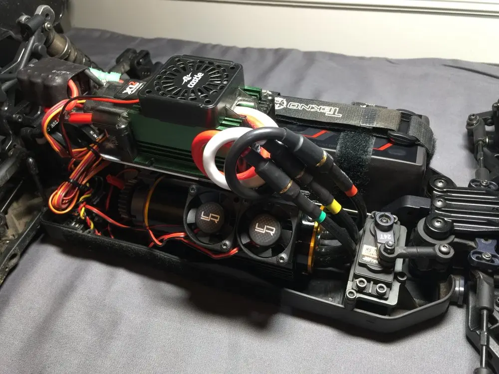

I had to use a 25mm spacer in order to clear the Graphene battery. Which is larger than most batteries, not just in height but the width.
Michael Meyer is working on a design with taller spacers so it will have room for Castle 1515 sized motors, and yeah racing sized fans.

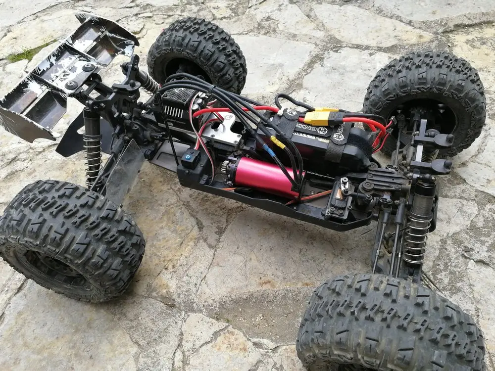

You can use the Yeah Racing heat sink but you have to space the plate up higher. This is my buggy I’m currently working on.

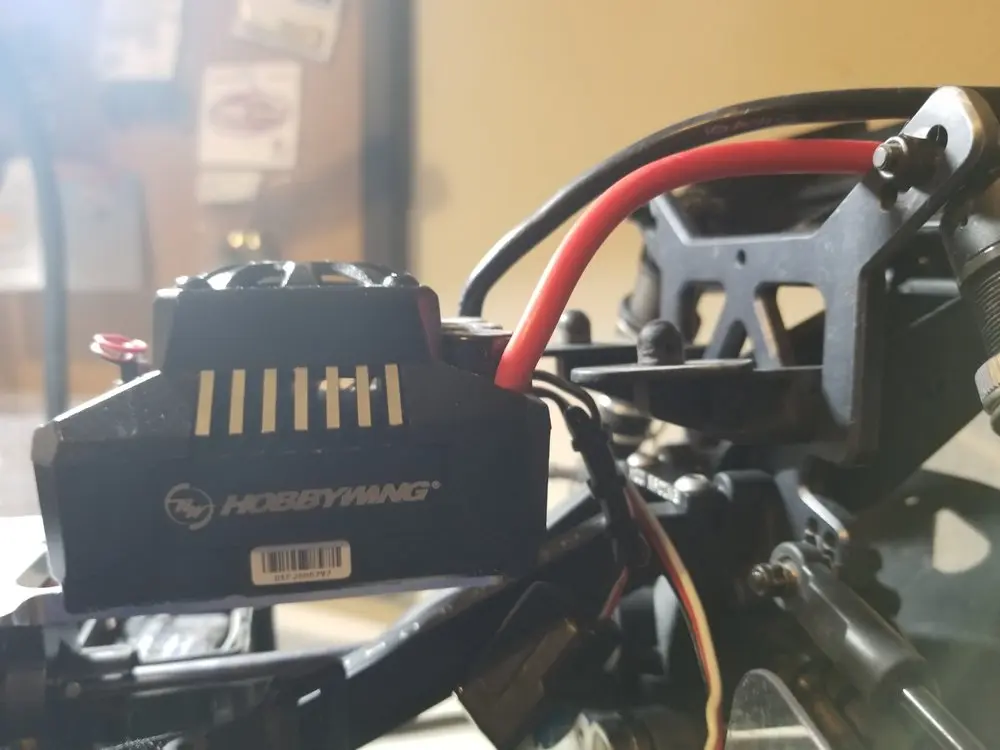

I got my plate from Michael Meyer today and am struggling on what I can even do with it. My plan was to just turn it so the esc is in the back, over the brace. This will put the esc higher than the body mounts though. Seems to be the same situation no matter what way I try and turn this thing, the body will not be able to sit on the posts due to the esc hitting it. I was looking at your "slow truggy" and noticed you have relocated the receiver box and paced the esc in its old place. This is is a great solution, and very practical only I like the waterproof ability. Not that I go mashing in puddles, but every now and then I'll hit one.
#firstworldproblems lol
edit...another thought I have is to just turn the plate towards the rear and go ahead and cut a hole just big enough for the esc fan to pop up through.

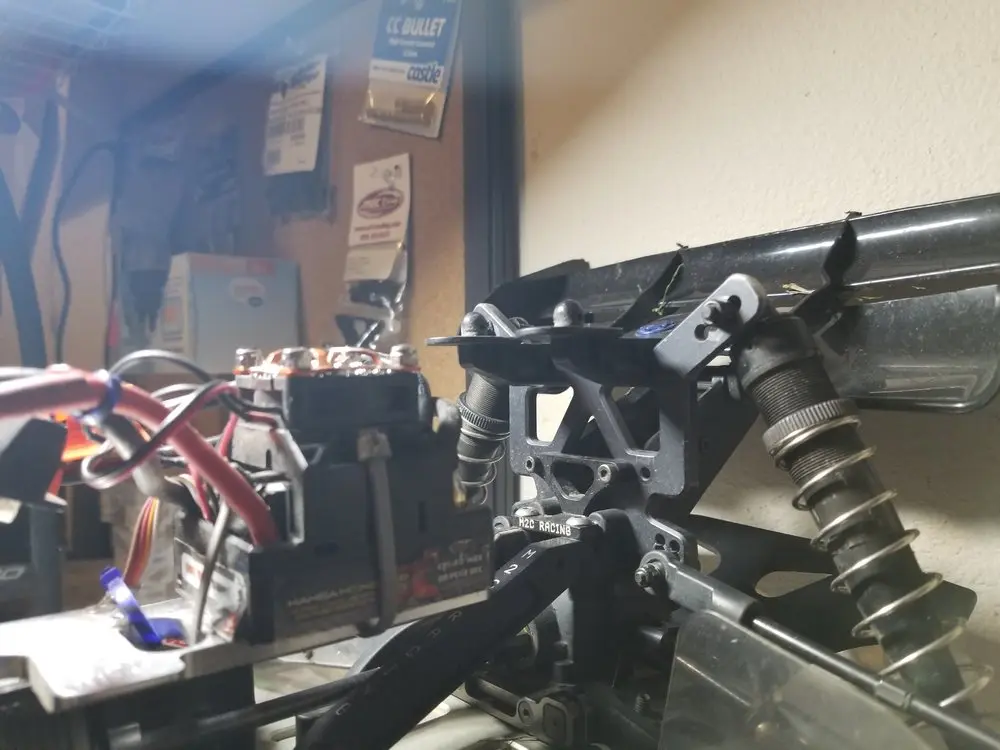

Here is a pic of the spacing. This is Max6, really like to use the MMX but it is even taller than the Hobbywing. If over the battery doesn't work out I may just cut a hole to allow the fan to pop up through the body and deal with finding another body style down the road.

I'm using the custom ESC plate on my buggy which has a cage and unlimited height. I'm using a different battery and changed to 10mm spacers. I haven't tried using the plate on my truggy so I'm not sure what the best solution is, other than using a larger MT body.

Look at my pic above, it's exactly what i've done and it work great. Plus if you land upside down, the wing protect your body. So go ahead and slap an mt body, it'll look much better

Instead of using the one existing hole and post I went ahead and drilled new holes in the tower. This gives me just enough room for the MMX ESC and bigger fan. I'm still using the LedFinger Assassin ET body but will move to a MT body when this one craps out. Thanks for the idea (y)
