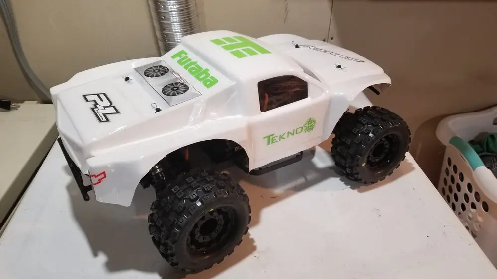

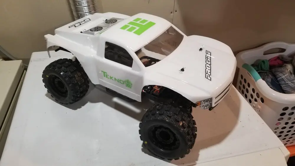

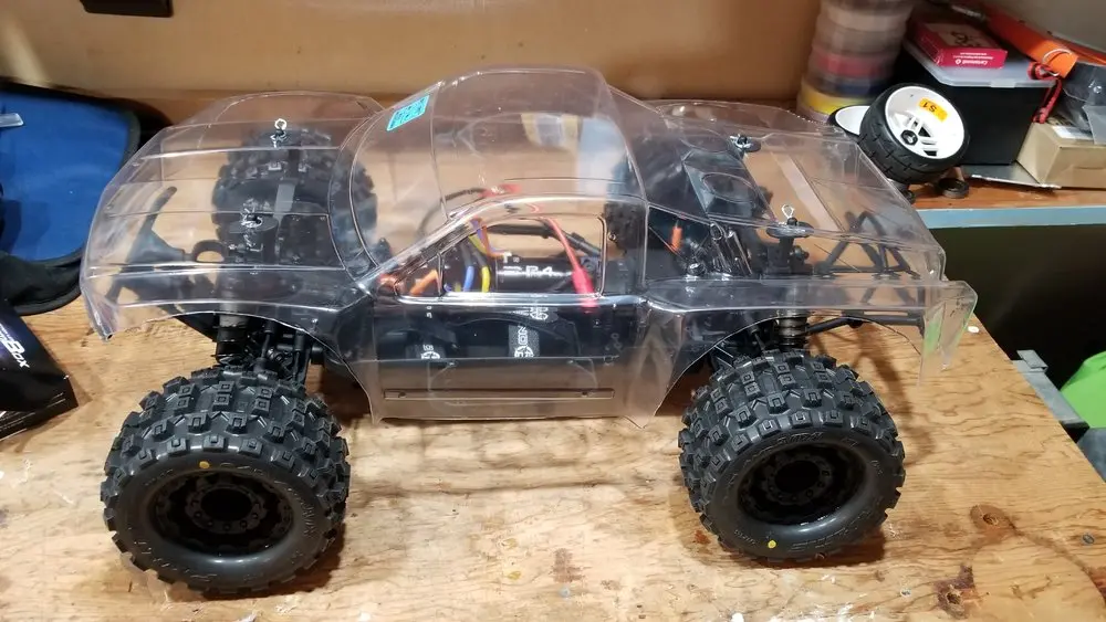

I have cut the body roughly and still have to dremel and smooth the edges and the figure out what I want to do with painting, but the car itself is done and ready to jump some hills. I had to excessively cut the wheel wells for the tires, and may still have rubbing when running, so next time I will probably try a different kind of body but I am kind of liking the look of it.
Kind of curious why you'd go with MT tires when you already have an MT410...? I thought about running an SCT body but I did that in the past with a truggy and I didn't like how much of the fenders I had to hack up to clear the tires. it's nice how the SCT tires/wheels tuck under but you do lose a lot of bash-ability running tires that small...
Building one of these with the 2.8 wheels & tires is like having a more durable version of the Pro-Line MT. Whole different driving experience than the MT410, granted you could put the 17mm hex version of those on the MT410, but the narrow width makes it more true to 1/10 scale.
I just kind of wanted to do something unique and what I was feeling at the time. I'm not a huge fan of traditional short course trucks and don't like how the tires stick in under the body and throw dirt and everything into the chassis. This one also isn't set up to be nearly as much of a stunt truck as my MT410 is. Also, I already have a 2wd Slash and an Arrma Senton so I didn't want to have three "standard" short course trucks.
The Proline MT 4x4 was actually the look I was going after with it. I really like the looks of that truck and almost bought one but was worried about two things . One being long term part support, since Proline isn't really known for their vehicles and I also didn't like how much plastic there was for $400 kit. I guess it's really only a $300 kit since it comes with body, rims and tires, but still, I'm not a huge fan of a lot of plastic.

I took it out for a driveway and road test and it is actually a blast to drive and handles really well considering the tires on it.
I rolled it once and found out that Krylon Fusion does not work well for rc bodies as about 10% of the paint came off lol. I figured I would try it as i'm looking for something cheaper than $10 for 2 ounces that Tamiya spray paint is. I'm getting an airbrush setup within the next month so I will start practicing and trying that out.
The temp after a 2s was 135 for the motor and 95 for the esc so that is good. Now to do some proper bashing with it in the next week.
looks awesome! I just got done reading a post on Krylon Fusion and how it flakes badly. It looks mean! I love it. The tires a different but I think it looks awesome! Kind of like a stubby ST! :)
Yeah, I read an article like that too. Probably the same article but I figured I would give it a shot as the Tamiya paints get to be expensive for such a little amount. I've got a cheap $20 airbrush coming so then I should be done buying Tamiya spray paints.
Thanks! I like the way that it looks as well. It kind of reminds me of a lifted up half ton with big, wide mudders on it that are half in the wheel well and half out. Hopefully this weekend I can take it out and test it out.
