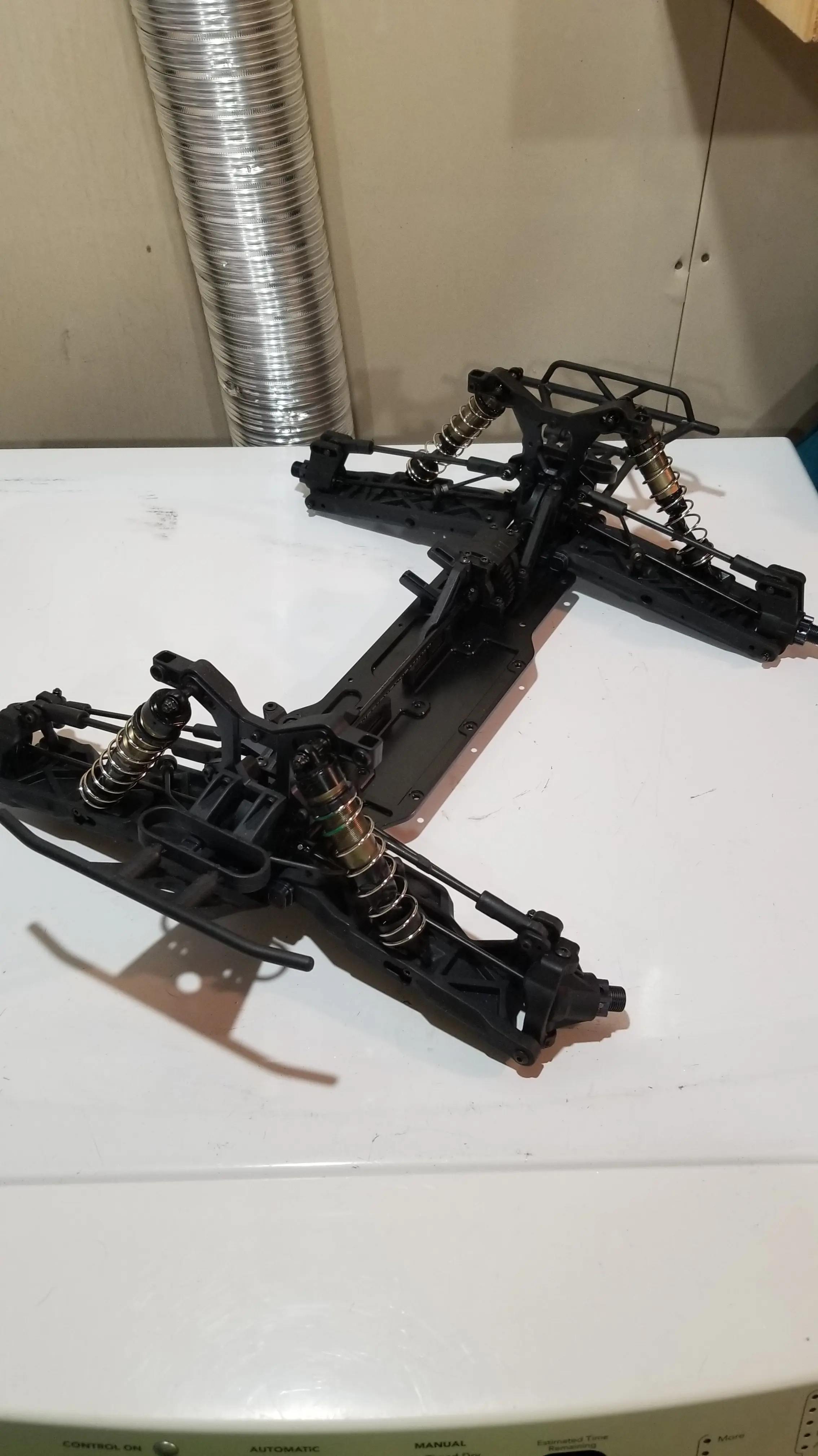

Alright. Here are pics for everybody. Here is my almost completed chassis.

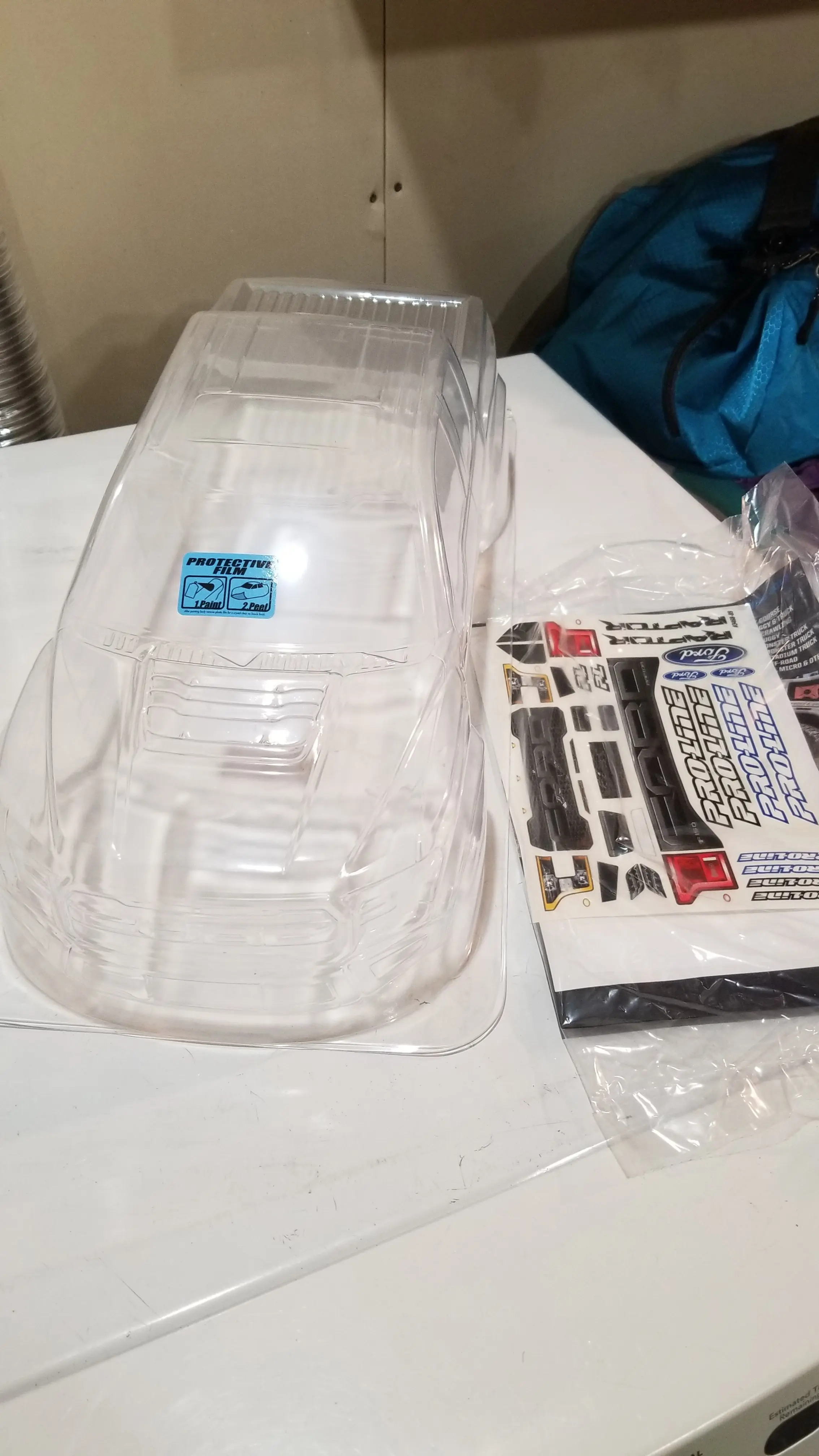

Here is the body that is going on it.

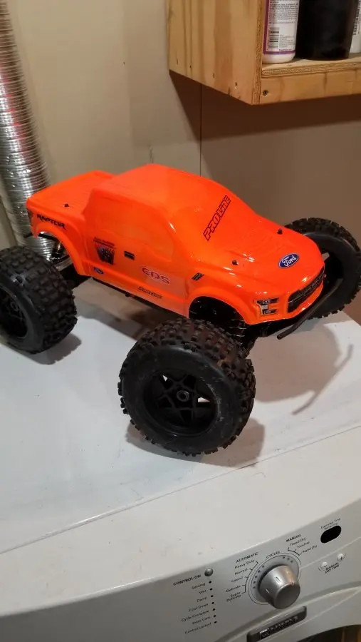

I finished up painting and applying decals to the body today. I also took it out driving without the body yesterday and today to make sure everything was working right and get trims set and everything.......rolled it doing a wheelie in reverse.....ground down the body posts and scraped the front shock tower and one shock cap :rolleyes:. I saw things going differently in my head.....LOL
