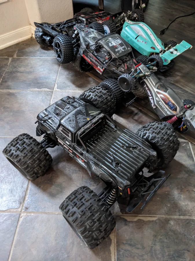

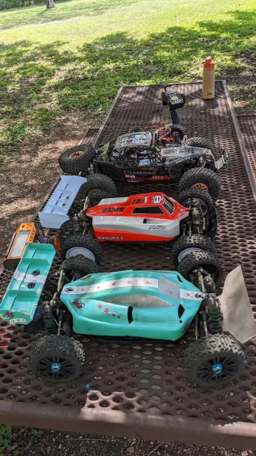

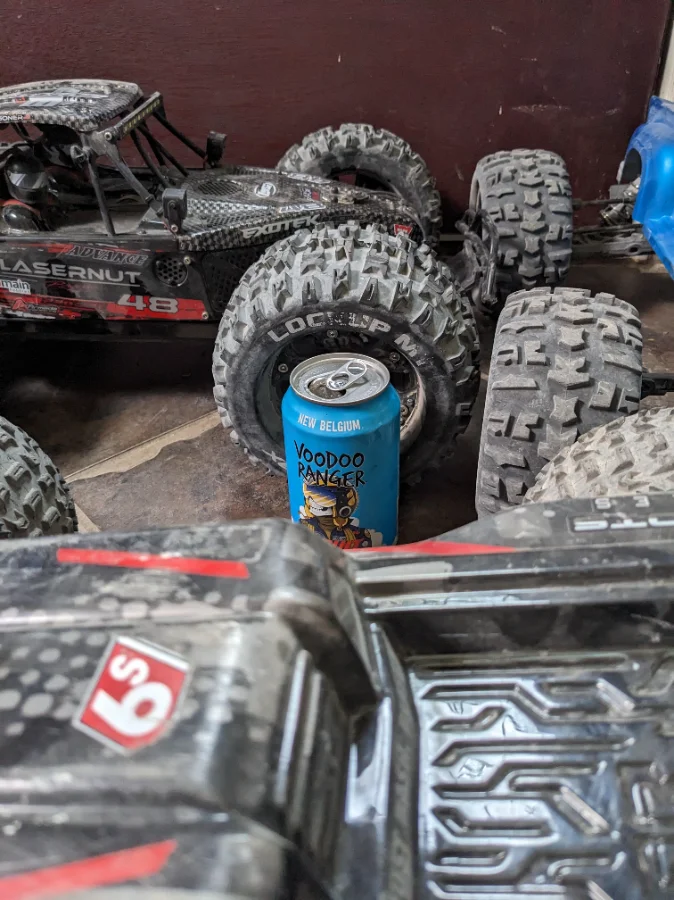

Good luck. I don't own these vehicles but i own a cousin, the Lasernut, which is a stretched db pro. It's my second worst RC purchase because it constantly breaks, steering rack falls apart and I've melted the wheels off twice because the bearings are undersized in the hubs. It's also the coolest looking RC i own and the hyrax tires on it are amazing. Post some pictures of your cars! Looks like half of my pictures won't upload...
Nice collection! My db pro is a box of parts at the moment.
I love the look of it too, and I could actually get it running again for around $200 of parts. However I recently rebuilt the diff from what I think were the last set of gears available after trawling every website that sold LOSI parts. So if I wear out/strip another one that’s it .
