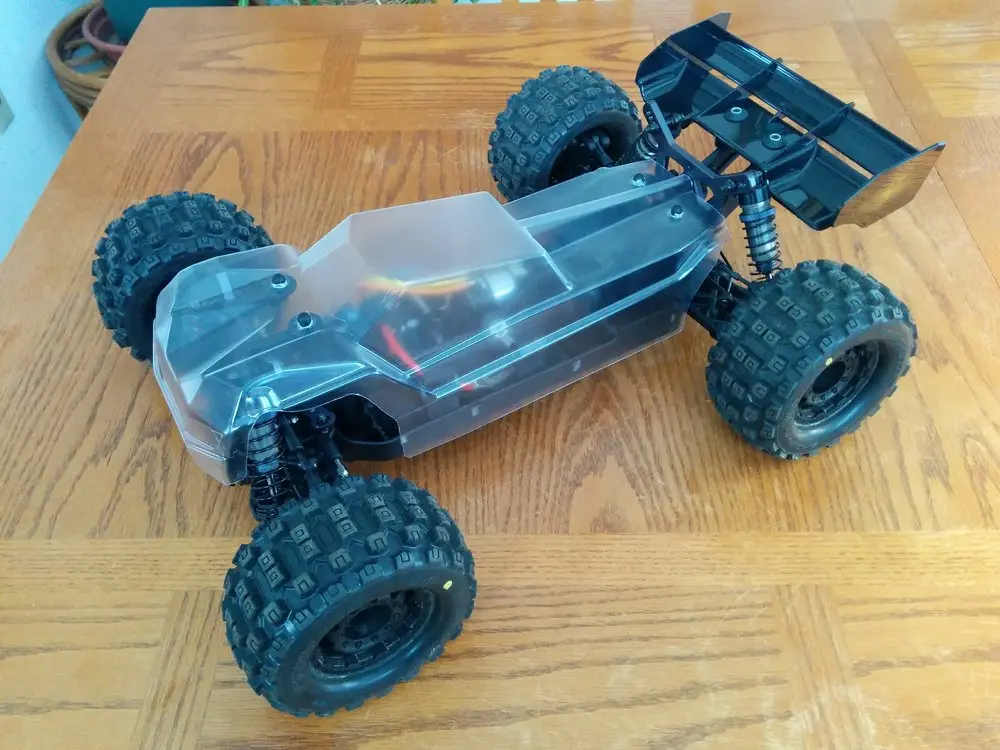

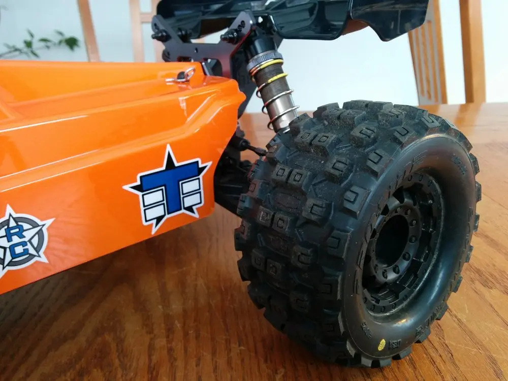

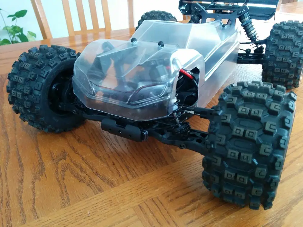

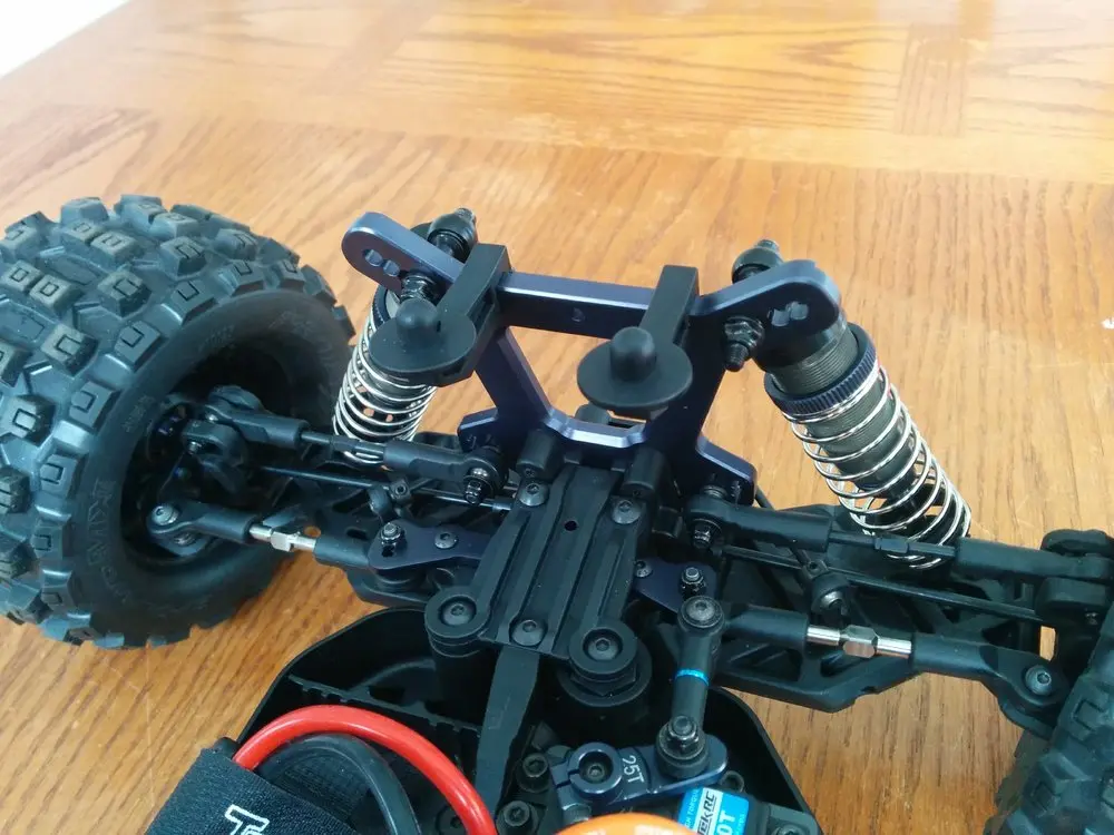

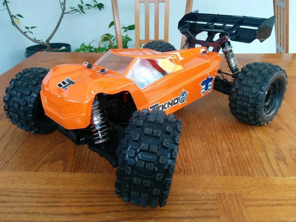

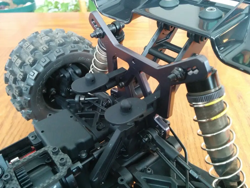

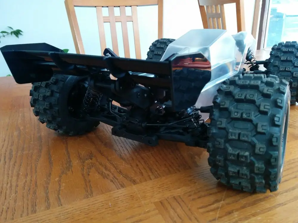

What I envisioned or wanted no one made. However, Tekno's good modular engineering allowed me to design EXACTLY what I wanted.
A shorter, more nimble truggy that could run on 2S for indoor tracks, ultimate suspension travel, protected shock towers. I wanted a rig that was comfortable on an indoor track, turning under 1/10 scale buggy's, but could hang with any 1/8th scale on massive jumps. A chassis that is too long and wide is stable, but has lazy handling characteristics...something just as good on smaller tracks and at home on larger ones.
"One rig to rule them all."

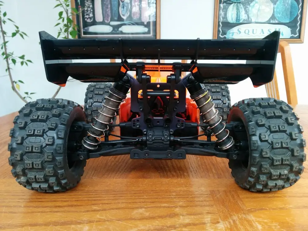

SCT410.3 base build
SCT410.3 arms

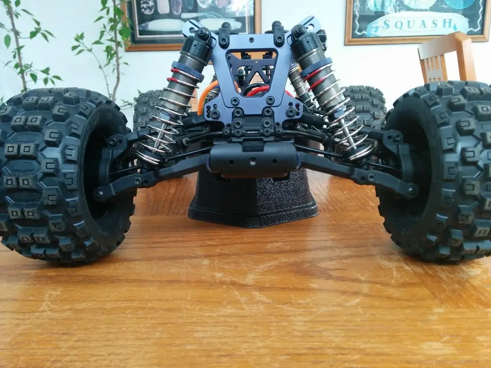

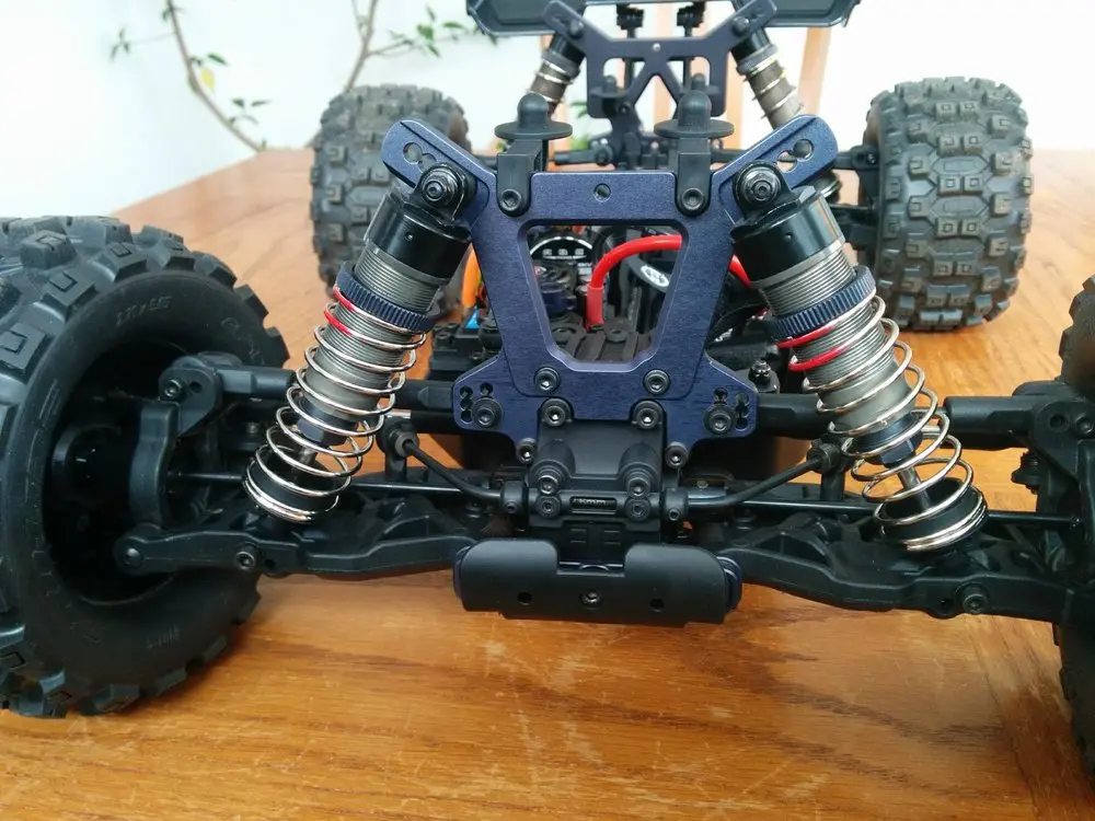

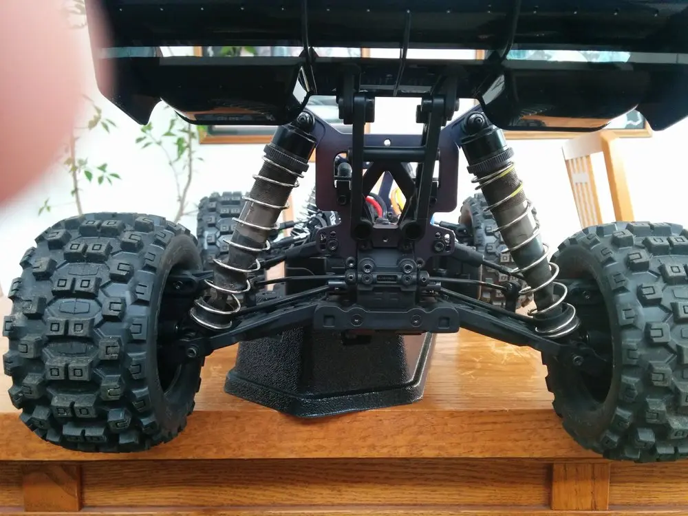

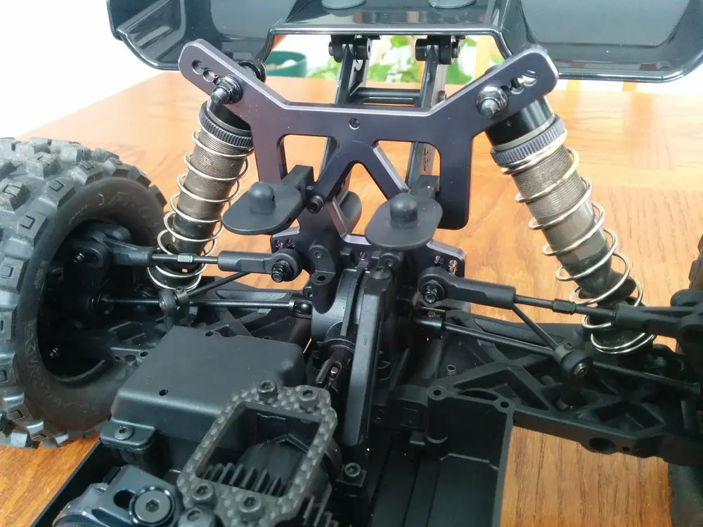

Truggy shock towers and shocks
Truggy body shortened 50mm
Truggy rear wing
17mm wheel fitment conversion.
Here's what I came up with...let me know what you think. It is a freaking beast and easy to do!
