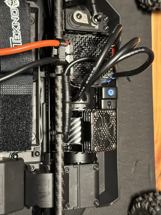

I don't think the 1515 length motor will fit with the Monster X esc. You will need to run either the 1512 motor with the Monster X or run the 1515 motor with the Mamba X.
Hi, I’m running a Hobbywing Max 8 G2 ESC with a 4278SD 2200kv motor in my SCT410 2.0. I’ll guess the space for motor and ESC will be the same on the new MT410 2.0 chassis. The Monster X with a 1515 2200kv has almost the same size so I think it should fit.
Hi, I’m running a Hobbywing Max 8 G2 ESC with a 4278SD 2200kv motor in my SCT410 2.0. I’ll guess the space for motor and ESC will be the same on the new MT410 2.0 chassis. The Monster X with a 1515 2200kv has almost the same size so I think it should fit. View attachment 9991
The space for the motor and esc is actually 6mm shorter on the MT versus the SC.
6mm? That seems quite modest. I would have thought the difference would be much larger. What is the difference in wheelbase? I was figuring something like 25-40mm.
We couldn't shorten the front more than that or we'd run out of room for the motor, esc, and battery. We shortened the rear behind the diff an additional 18mm. So the wheelbase is a total of 24mm shorter than the SC chassis.

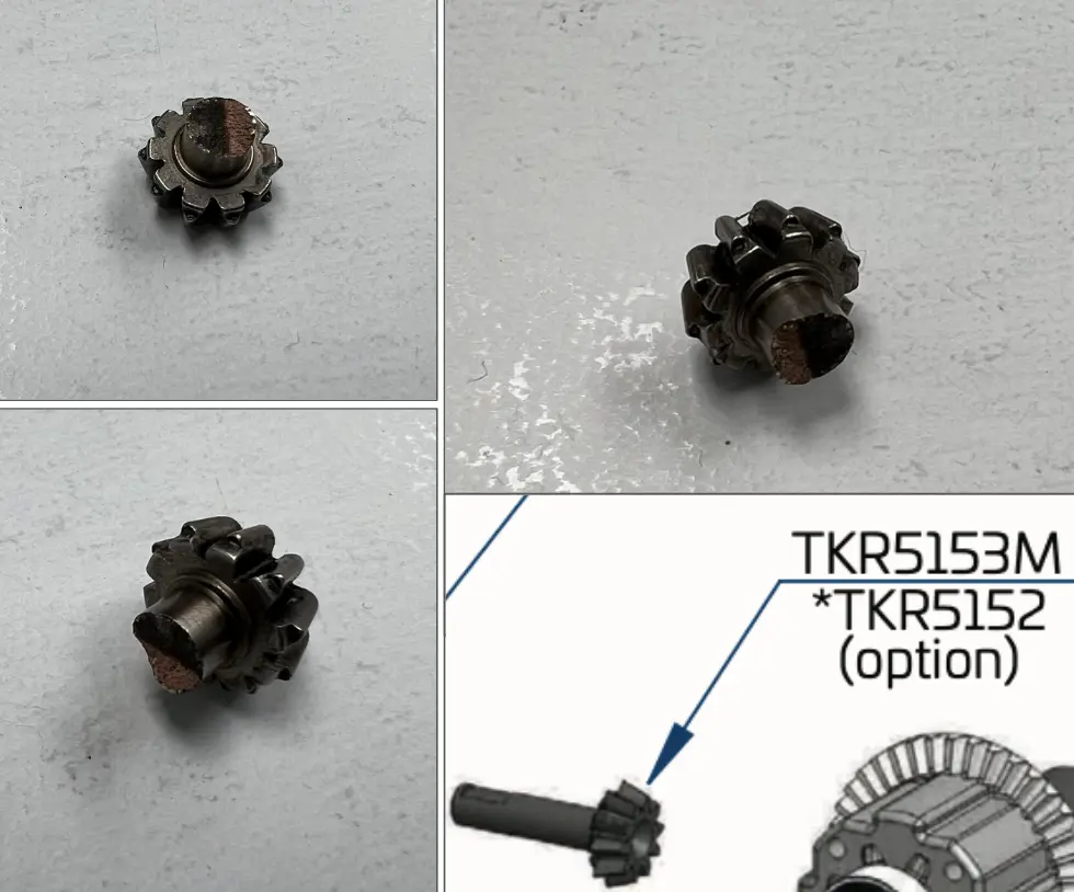

Got my MT410 2.0 built. As you would expect from Tekno, the build was fantastic. Everything from the quality of the *paper* in the manual (I spilled oil on it - no big deal wipe it up and it was never there) to how well the parts all go together.
The MT410 2.0 is a tank! Basically an 8th scale truck in 10th scale dimensions.
Driving: So far I've only had a 3-4 packs of shakedown runs on mostly flat grass and asphalt. Even so, it was just phenomenal. It can handle terrain like an MT but has the control and precision of a buggy on carpet. Very stable and predictable.
One problem so far. My rear diff pinion just broke. Not sure why or how. There's a center diff, and it happened on flat level ground. Even if you imagine the rear wheels were immobilized, all that stands between the motor and the front tires is a center diff with 100k oil. So somehow, the diff pinion shaft snapped before power routed to the front tires (AND, the rear tires were never immobilized).
Over the years I've had a few failures on my Tekno rigs which I thought were due to some user error (like, say, a gigantic jump and a terrible landing) but never had a part fail inexplicably like this. Pic of the damaged part is below (TKR5153M). I am exploring the option part (5152) which uses the word "hardened" a lot, so maybe it is stronger.
If anyone has thoughts on this, I'd love to hear them. Thanks!
I'm curious what motor and battery (2,3 or 4s) and size pinion you were running when this break occurred. Definitely interesting and I wonder if you email Tekno support (with the pictures) to get their thoughts if perhaps they have a batch of weak tkr5153m. I have a couple mt410 (the original) and occasionally you would hear of folks on the tekno mt410 basher group "exploding" the spider gears in the center diff. Never happened to me personally but always made me wonder if bad/weak batches of some parts made it into kits.
