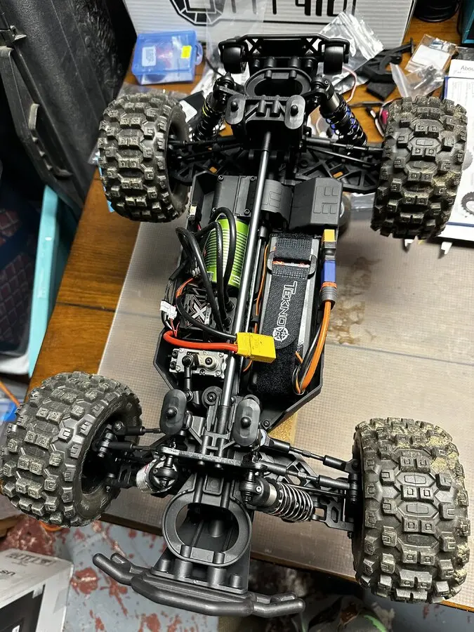

Do you have pics of the build, electronics, wheels, setup you can share?

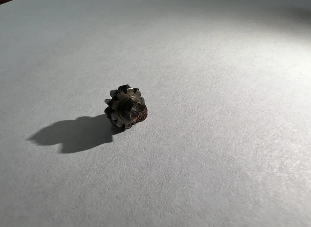

I'm curious what motor and battery (2,3 or 4s) and size pinion you were running when this break occurred. Definitely interesting and I wonder if you email Tekno support (with the pictures) to get their thoughts if perhaps they have a batch of weak tkr5153m. I have a couple mt410 (the original) and occasionally you would hear of folks on the tekno mt410 basher group "exploding" the spider gears in the center diff. Never happened to me personally but always made me wonder if bad/weak batches of some parts made it into kits.
Hobbywing 3665 3200kv, Max10 ESC, 13t pinion. Was doing shakedown runs with 2s, 3s primarily, and then for the heck of it tried a 4s pack for a few min.
I was mostly doing shakedown runs to get a feel for the truck, using the GPS to see what the speeds were, and monitoring motor temps. The breakage did happen with the 4s pack, but it was on flat ground while doing passes back and forth. I am struggling to understand how a 5mm thick metal post twisted apart when there was a center diff to take excess power to the front of the truck... it was basically 5mm metal post vs 100k-filled center diff.
No way a metal post should lose that fight.
I think it might be a bad part - there's that weird discoloration on the shaft (quite prominent in real life).
I might look into the option parts (marked as being "hardened") but that's over $100 just for a set of 4 gears (two diff pinions and two bevel gears).
Sure will post later. Back end of the truck is apart but I can take a few pics.

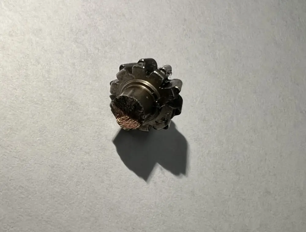

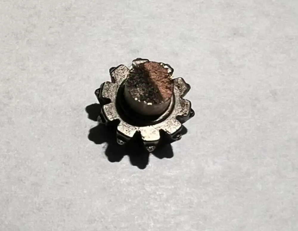

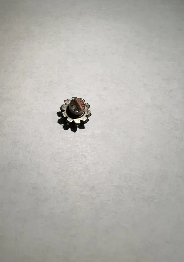

can you post a close up shot of just the pinion where the break happened? It's hard to see in this one with the shadows and picture size. You can frequently identify material failure by the texture, color, and patterns where breakage occurred. That would give you a good idea whether there was a faulty part or just from shear stress.
Here are some very big pics (sorry for blowing up the thread):

Definitely interesting. Due to the completely different color shading, with one looking like it's corroded, i would have to assume a faulty part. The darker side has the usual signs of stress fracture and tearing, but that means only about half of the pinion shaft was intact when it broke. I would definitely reach out to tekno with these pictures. Best of luck!
