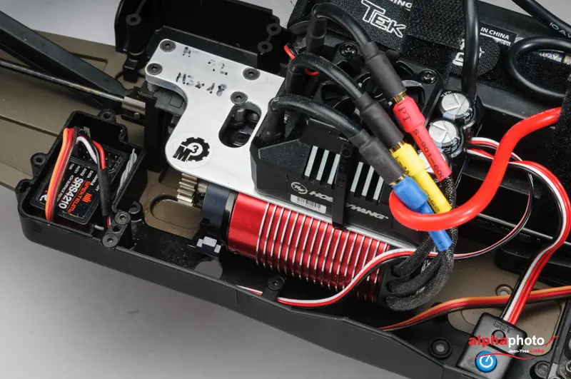

Does anyone know its it's possible to fit a hobbywing max 6 70x56x46 and a cordova 1440 40x104 in a et48.3 chassis?
I would think it would fit as long as you use an ESC plate like the one here.
Awesome, I found his face book page thanks! Germans have always made nice stuff.
