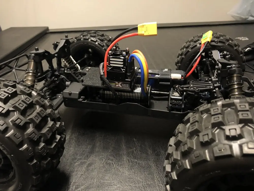

Mind if i ask which 4092 motor?
Rocket RC 1650kV. The things a monster on 4s with the larger tires. Rolling backflips, standing backflips, etc.. I had to limit the power using the castle aux feature to 80%. I can still get it really hot though with a 20t pinion.
Nice, i like the tires, which one are they?
And why did you mount the ESC that way?
It looks like it was probably the only option? Or is that also defaut for the kit?
I ask as i hadnt noticed that on any other MT410's.

Yeah i was getting the feeling that a heatsink without fan is going to be hard to find. I may just order something with a fan and see how it works, without the fan. It will depend on the temps im seeing once its moving.
Those are Badlands MX38 but they're the older style wheel, they're discontinued. I happened to get lucky and find a new set on eBay.
With such a long motor there's no more space for the ESC between the motor and servo so the ESC needs to be relocated. I opted to make my own mount and put it on top of the motor. It works really well so far.
