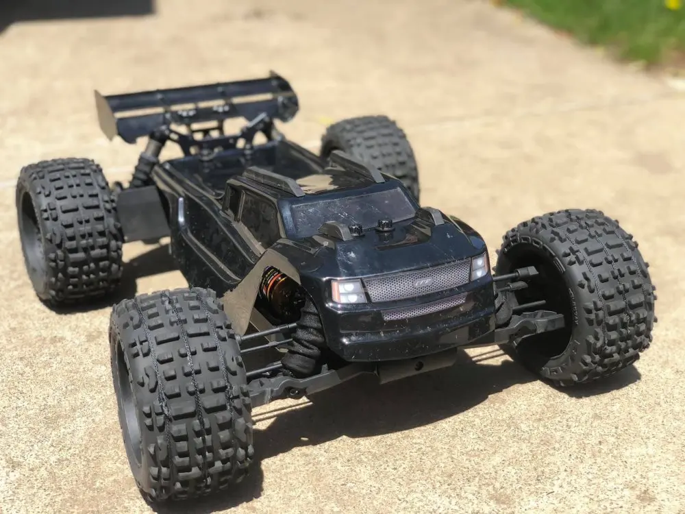

Here's my overpowered ET 2.0

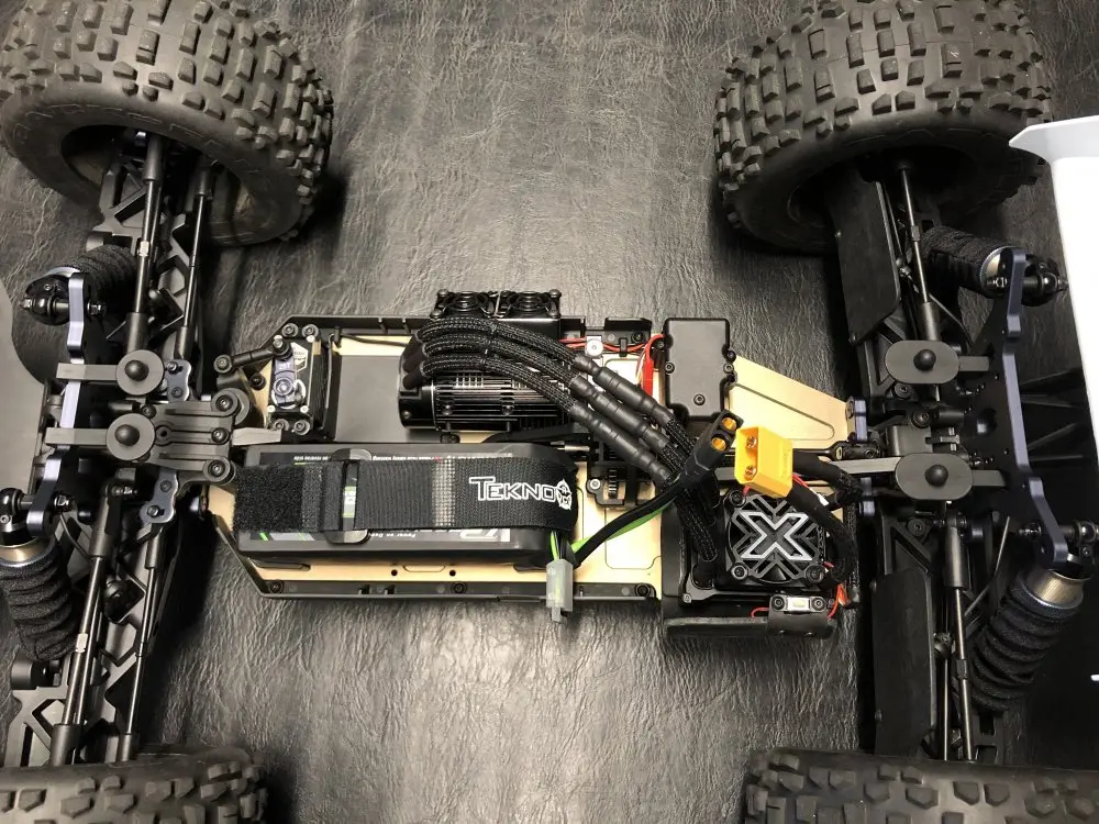

Castle MMX8s ESC. Repurposed 40mm server fan.

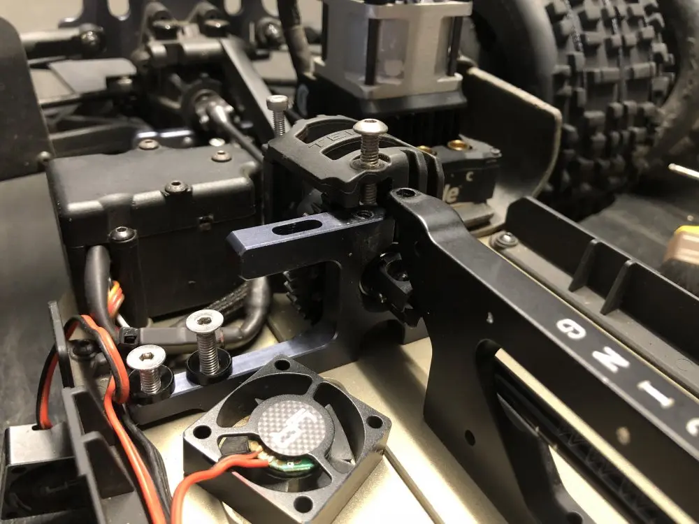

TPpower 4070 1520kV motor. 40x107mm dimensions. Purchased with the M3 threaded mount.
MKS HBL550 Servo. Tekno aluminum servo horn - requires a small M2.5 shim to clear the MKS servo.

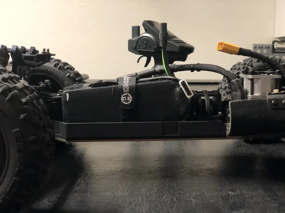

Turnigy Graphene 5000mAh 6s 75C LiPo.
Yeah Racing Dual Fan heatsink. Yeah Racing 30mm aluminum case fans. All of the fans, including the ESC fan, are powered by the receiver. Using a 3-1 JST lead and a JST to Futaba lead to plug into the receiver.
I like to use a silicone pad to conduct heat from the motor to the heatsink more efficiently.
This 12"x12" sheet of Nylon 6/6 was super useful. It's abrasion and impact resistant, looks like the same stuff that T-bone uses for their bumpers. I made front/rear bumpers, ESC mounting plate and a battery guard and still have some left over.
T-Bone Racing 1/8 Truggy Wheelie Bar for wheelie control. Bolted into the rear bumper.
Battery Guard. Bolts in line with the battery tray piece. Using the center strap as well.

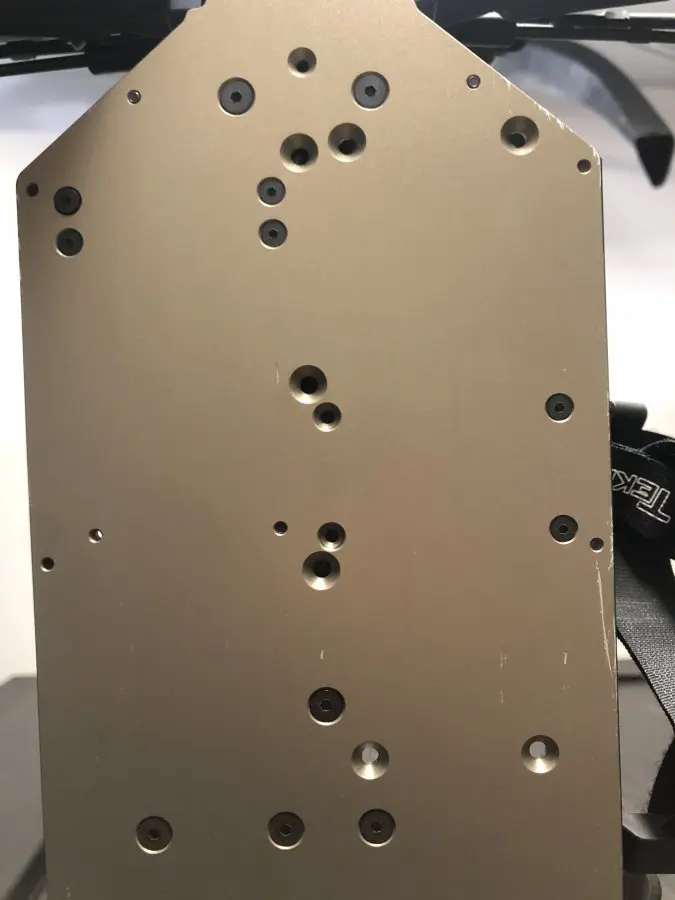

I drilled and countersunk 5 holes in the chassis to accommodate the ESC mounting plate and a wire guide.
Wire guide is just two M3 flathead screws, two M3 locknuts, two M3 spacers and a small plastic plate.
Proline Thumbwasher kit. Very easy to install and super convenient.
Yokomo 8mmx11mm shim kit for the hexes.
M3x6mm screws in place of the set screws in the castor blocks.
Leadfinger Racing Strife body for the NT48.3. RPM skid plates for the x-maxx.
Strapped dBoots Backflips LPs. Using 200lb rated kevlar kite line. I dremeled a section out of the center tread line. Two loops per row. I double knot and use CA glue on the knots.
This is the line I use. 100 feet was enough for a set of backflip LPs and backflip 6s tires.
TPpower 4070 1520kV
This 12"x12" sheet of Nylon 6/6 was super useful. I used it to make the ESC mount, a battery guard and front/rear bumpers.
T-Bone Racing 1/8 Wheelie Bar.

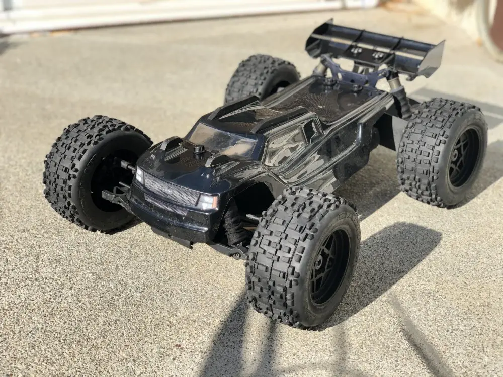

Strapped dBoots Backflips (4s and 6s). Using 200lb rated kevlar kite line. I dremeled a section out of the center tread line.
Tekno High downforce wing. M2C wing buttons. Installed with stainless screws.

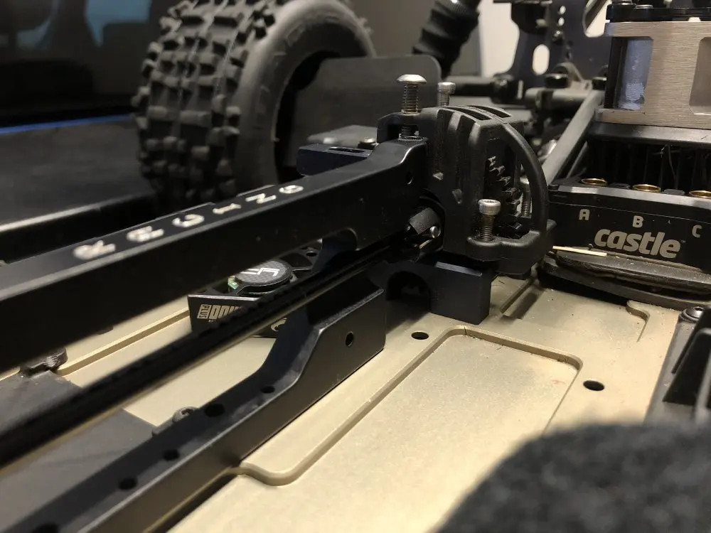

Nice build, any pics of the back. How you did the pins of the body, looks like you have some type of screw

Tekno high downforce black wing. I dremeled the wing so it could clear the shocks. M2C Wing buttons.
Orange loctite and knurled set screws throughout the drivetrain for extra security.

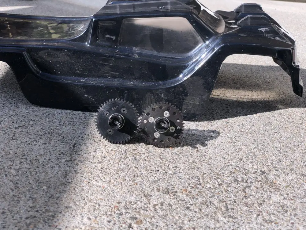

Steel Spur
Geared 25/44 for 85mph using bacfklip LPs.

I bought that battery (after seeing it one of your prior threads) but it does not fit between the battery holders on my EB2.0. I think those battery holders are identical between the EB and the ET. Did you have to do anything to help the battery fit properly on the front end (i.e. near the steering links)? You did a nice custom job on the back end. Does the battery sit flat?

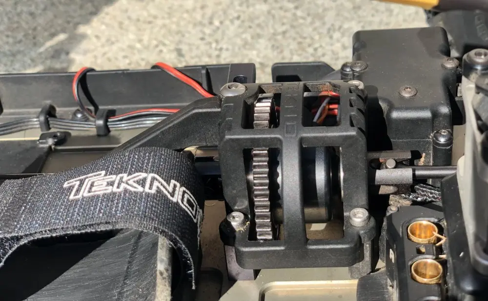

I always wonder whether such huge motors will cause the motor mount to fail on a bad landing (i.e. taco-ing into the ground, let's say). Do you have any problems?

I sort of just squished in. It's a really tight fit. The guard just lifts the battery up and protects it from the center diff outdrive. It doesn't sit flat anymore but I could remake the guard to have the battery sit flat. It was super easy to make. Nylon sheets are very useful. No modding near the front.
With long enough motors, like this one, you do need to add some support in the rear for the reason you describe. I'll likely use a couple of 40mm diameter O-rings placed on the rear of the can, a trick that worked with the ET48.3.

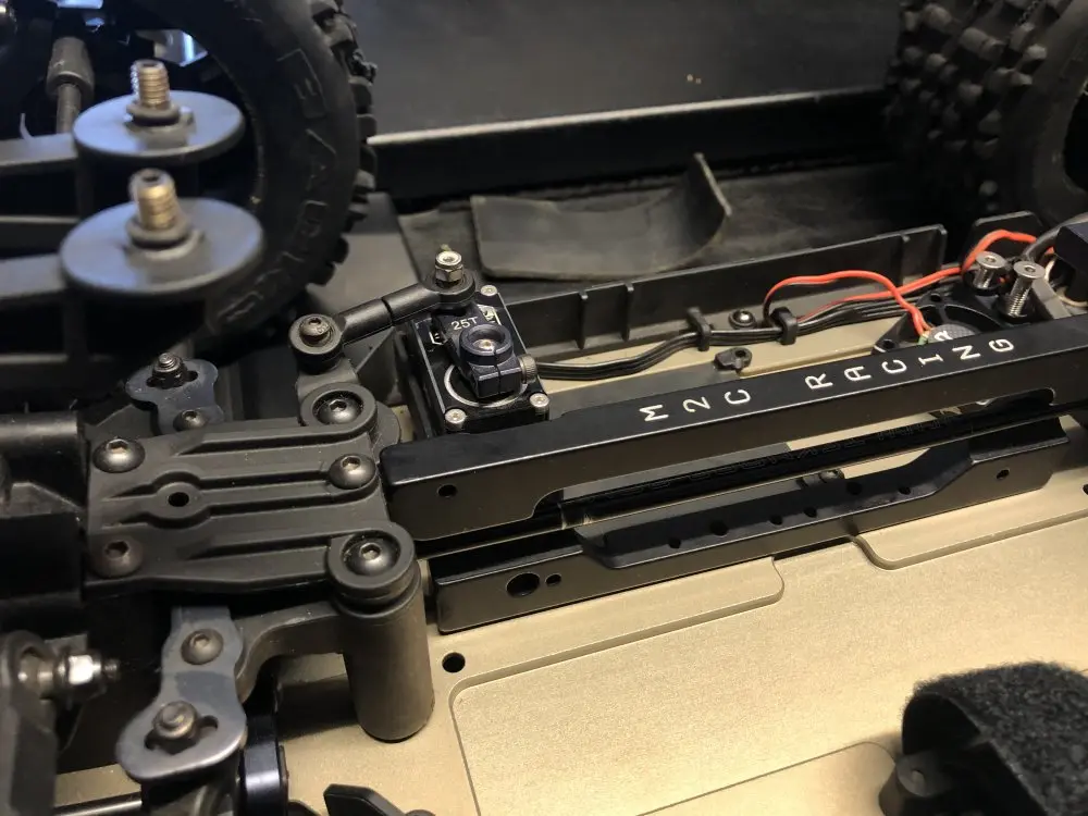

Did I see a shot with an m2c chassis brace installed on this car? Do the ET48.3 braces fit directly? Great looking build.
Thanks man! There's no there's no aftermarket braces out for the 2.0 platform yet.
I did try to fit the M2C V2 Mega Brace for the Mt410. The steering plate hole lines up and only the rearmost bottom hole lines up. The battery tray pieces don't fit with the V2 mega brace and the center driveshaft doesn't line up. Top rear hole also doesn’t line up. So the old platform braces definitely don't fit.

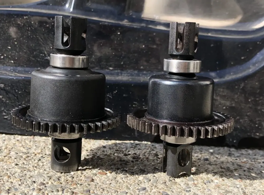

The .3/.4 center differential definitely does fit though. Left is 2.0 diff, right is an MT410 diff with a steel diff case and stainless screws. Both have 44t steel spur gears. Note the old outdrives have a flat edge.

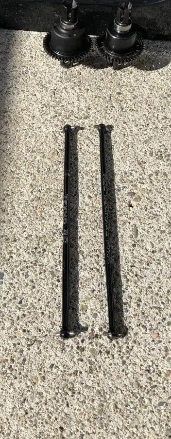

Driveshafts are also the same length end to end. 2.0 driveshaft is about 1.5mm shorter pin to pin than the MT driveshaft. They’re interchangeable.
MT410 diff installed. I'll use this in my 2.0 since I'm pushing a lot more power through this than my MT and I'd rather have the extra security of a steel diff case on this platform. The fly ratio 32t spur should also fit this diff case. I might run it so that I can fit a smaller sized pinion and maintain an 85mph top speed but also push the motor mount insert further into the center for better support.

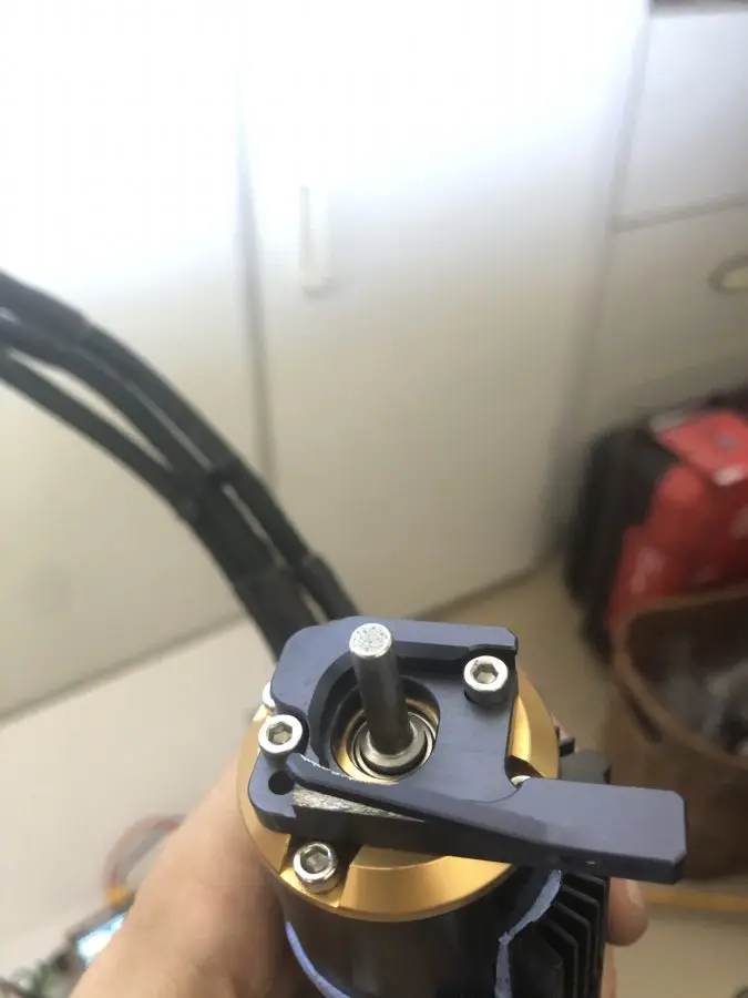

First run with this motor didn’t go so well.
I had a couple of hard impacts. Guessing one of those caused this in combination with the really heavy and long motor placing a lot of leverage against the mount. Will need to figure out some sort of rear end support system for the motor can. The motor screws were also loose but not stripped so it could have been that they loosened and on impact the mount broke.

I have used wetsuit material to hold the back end of a motor up, but I usually layer pieces of gorilla tape down and use a steel cable tie to hold the motor down to the tape, you'll need a few extra holes in the chassis to run the tie through.
View attachment 6825 View attachment 6827 View attachment 6824

The way the motor mount insert broke makes me think that the motor flexed up. This could be from landing upside down or the chassis flexed enough to bend up and hit the rear end of the motor. My guess is the chassis flexed and hit the motor. Inspect your chassis and look for marks near the end of the motor can.

You can’t build the 2.0 diff with the m2c diff case.
What you can do, is build a OG/.3/.4 diff with the m2c diff case and do a full replacement. I believe they fit in similar housing.
Not worth the effort and money if you ask me. You would gain metal, but the OG diffs are slightly smaller. The newer diffs are larger capacity and seem to require thicker oils. Go 200k+ weight in your center diff and you should be good to go. On an overpowered rig, I would do 500k wt to be on the safe side. Don’t overfill it or it will leak. If it leaks, refill it.
Yeah I should have noted that you can swap in an entire .3/.4 diff into the 2.0 platform, not swap parts between the diffs. The only parts that are interchangeable between both sets of diffs are the bearings, 8x16x5mm.
Yeah there's a small mark on the chassis. I think the motor loosened up since the screws were backed out, letting it flex and hit the chassis which then snapped the lip on the motor mount insert. Good motor support and a smaller pinion will probably fix this.

I use this on my builds that run a long TP4070.
https://www.ebay.com/itm/332787511241
Trim off the CD mount from it and then mount it on the rear of the motor. You will need transfer screws to mark your hole locations on the chassis. No matter what the landing is the motor will not move.
