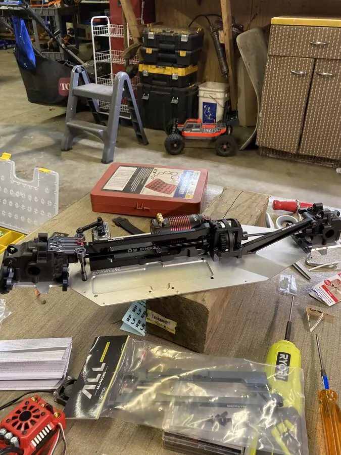

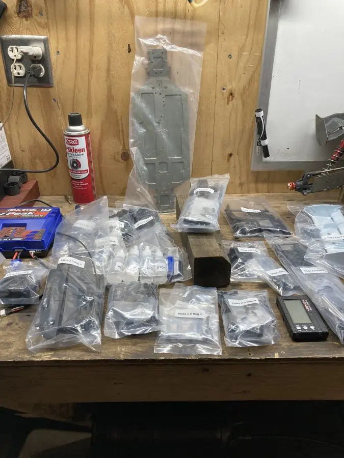

After building the ET48 2.0 I couldn’t wait to get another Tekno so what else to get the EB48 2.0 can’t wait to get it up and running. Build thread to come got the kit waiting on tires electronics and a compact 6S battery this is going to be wild.

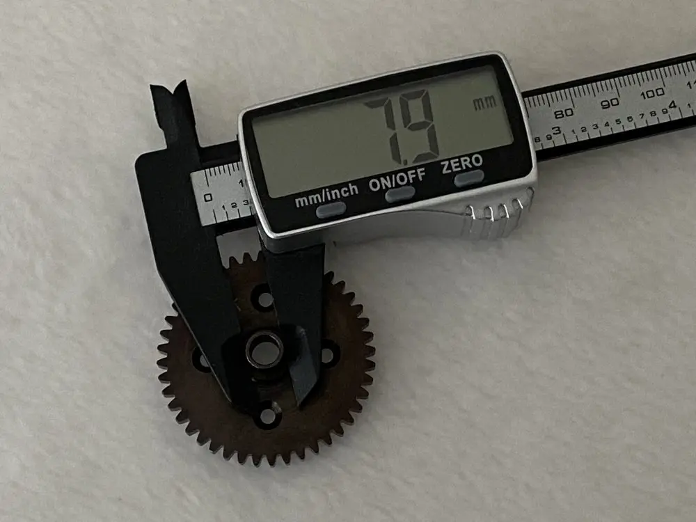

Sorry I totally forgot about the spur!
Heres the metal one I got:
Will be installing this weekend so will see how the bearing fits......

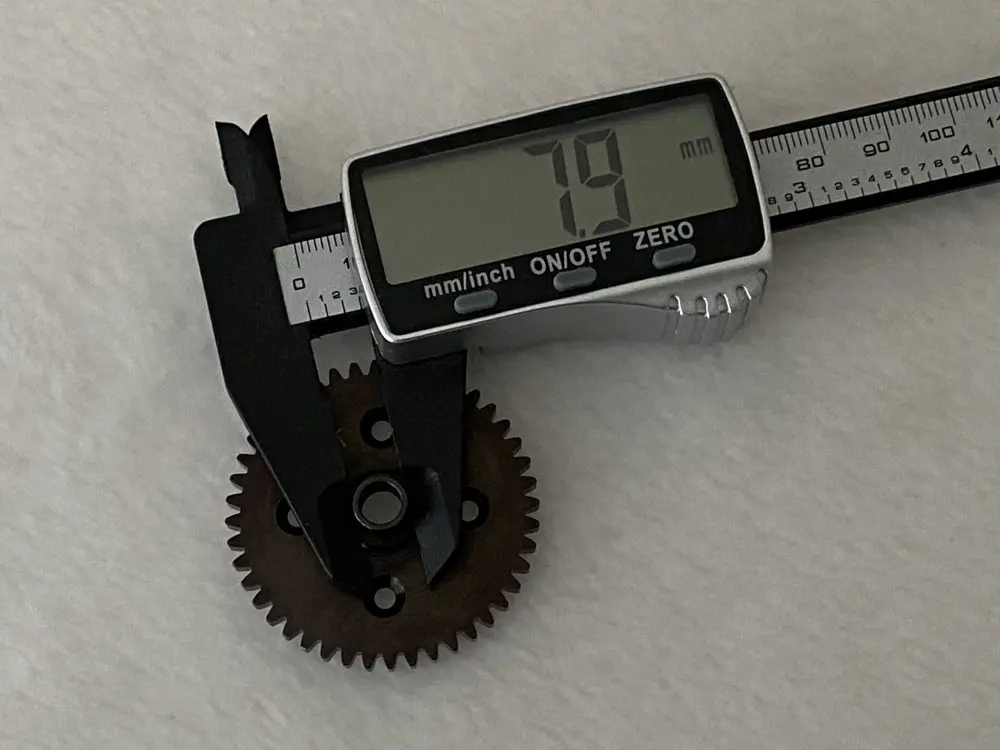

I bought a second one for my eb48 and it was the proper size the first one I got for the truggy was just a fluke good to see yours is the right size.

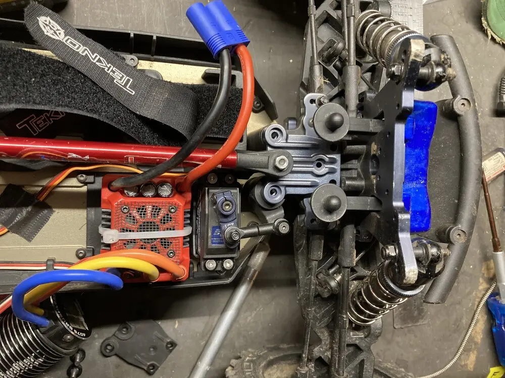

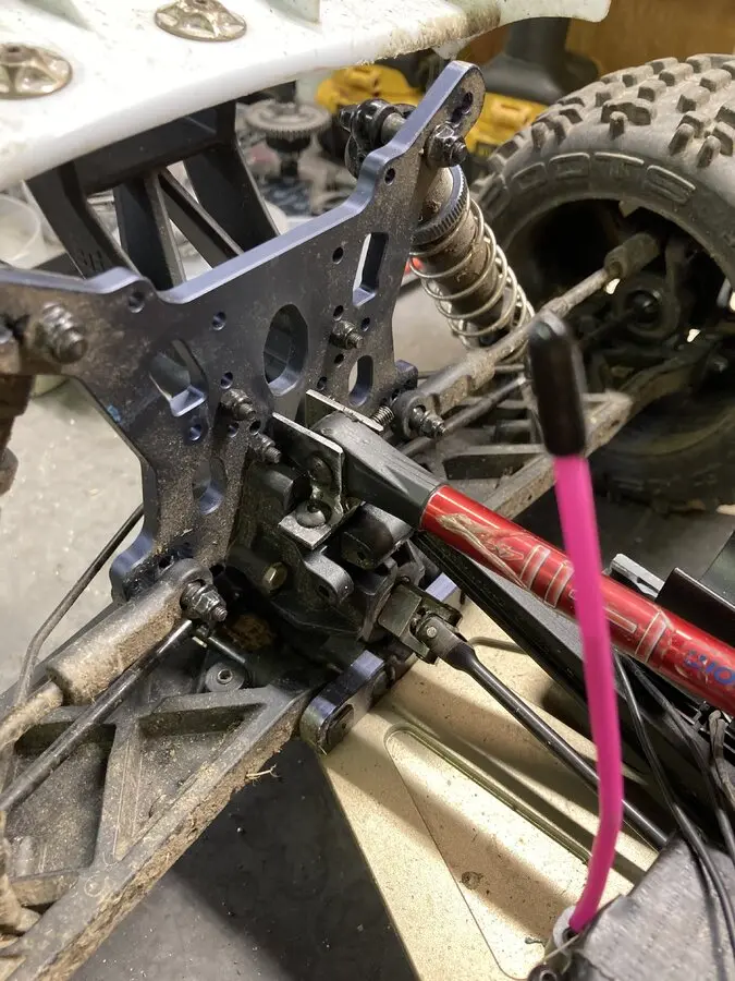

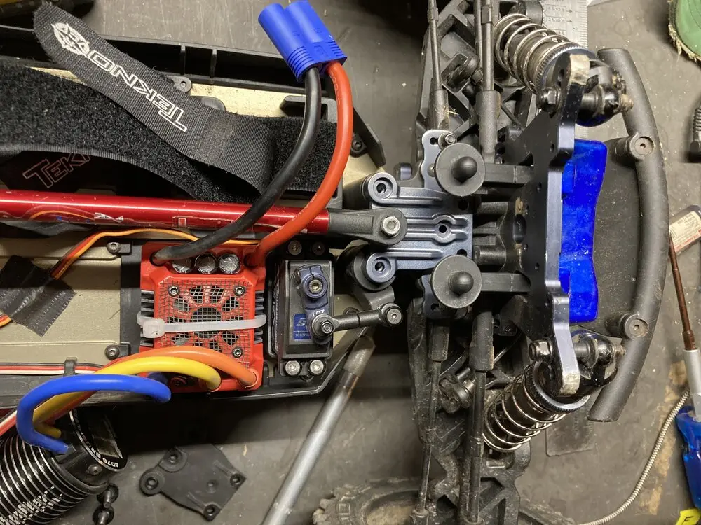

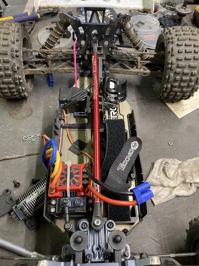

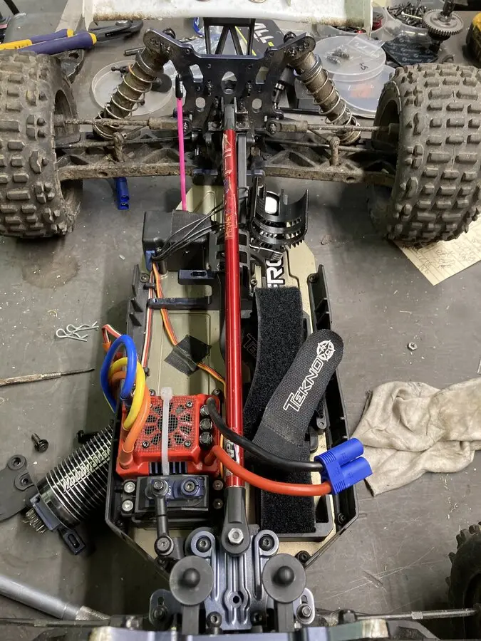

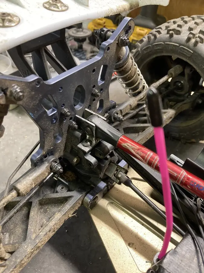

Got my first 7075 upgrade part and working on a brace. I keep bending the front driveshaft.

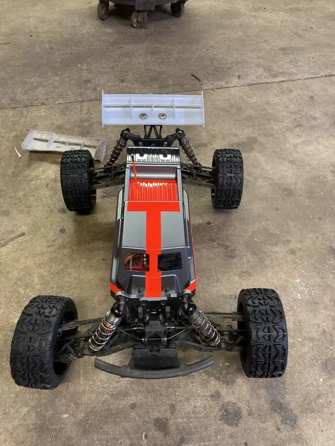

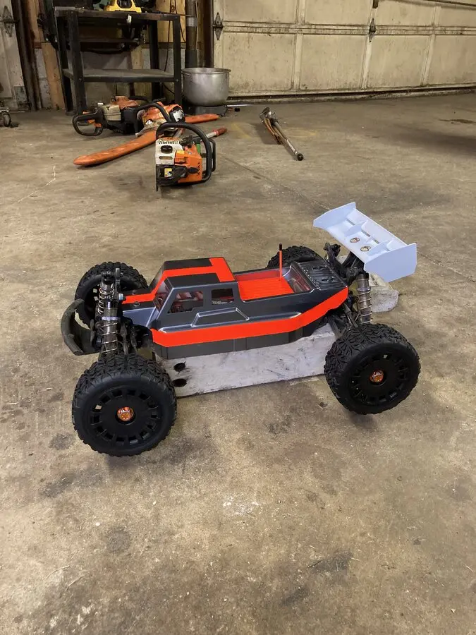

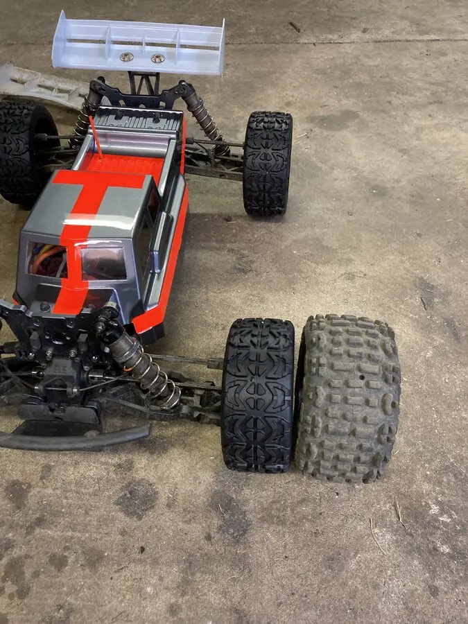

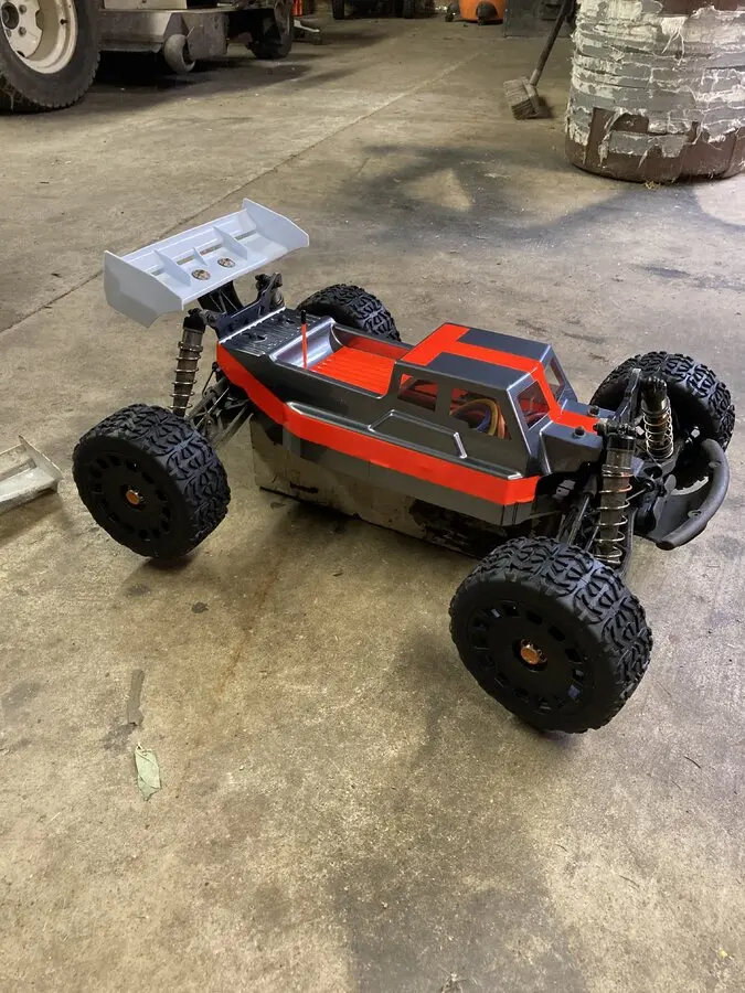

New treads and body for my Basher ET48 2.0 can’t wait to try them out. I was looking for something with less traction because the diff cups seem a little to hard and the edges chip then the driveshaft pins start to wear quickly when running 6S.

The rear hubs suck the bearings practically fall out even when new the center diff mount I don’t like the one piece cage. I have built two et 2.0 and one eb 2.0 and the center diff fit different in each one of them. The shock rod ends aren’t very good I’ve broke at least eight so far mainly on the rear. The battery tray will break hardcase batteries I’ve cracked three of them I think there should be a plastic tray. Last it is very easy to bend the front center driveshaft and crunch the bearings in the center diff and front pinion gear in the process. There is a lot of flex in the chassis and for a race kit it’s kinda heavy. I do run mine very hard and on 6s all the time once m2c comes out with a front brace and a chassis it will be a pretty much bulletproof Basher. One last thing where the turnbuckles mount to the towers they always come loose no matter how much I tighten them.
