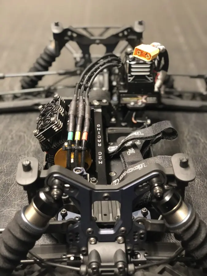

The boots rip really easily. Mine didn’t last 5 runs.
I use shock covers now but will also add TBR mudguards.
