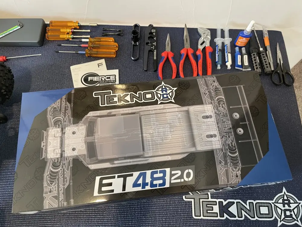

Got mine on Sunday but my diff fluid 60-100-30, metal spur, and TiNi shafts are delayed in transit by FedEx till who knows when and my other delay in the build is that I’m going on a week long fly fishing trip this weekend… so I won’t be able to build till May 8th, 😭😭😭😭😭

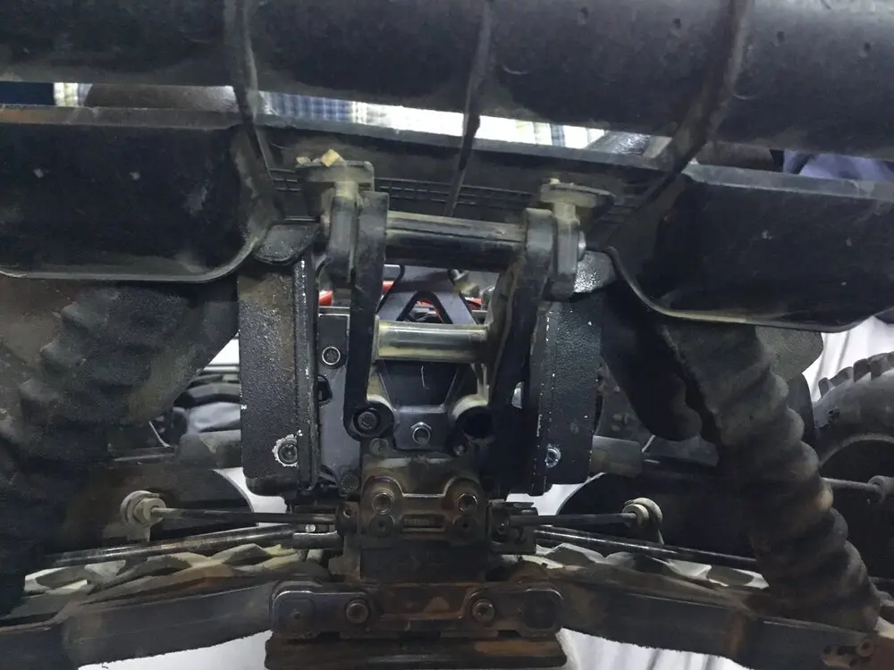

Seems like theres a lot of flex in the servo mount, guess this is normal? All the plastic on these seems to be super high quality, and all of $11 for a new mount so better than the force on the servo i guess.
Are you guys normally running the rubber inserts?
Sliced off the small nubs on the center side and used the rubber mounts.

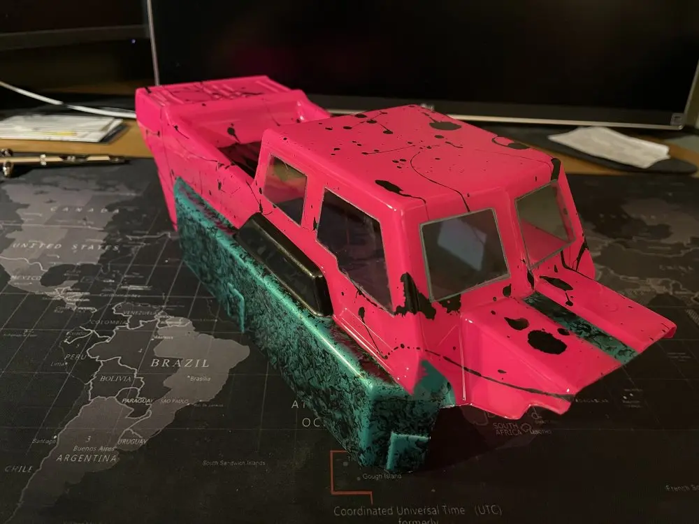

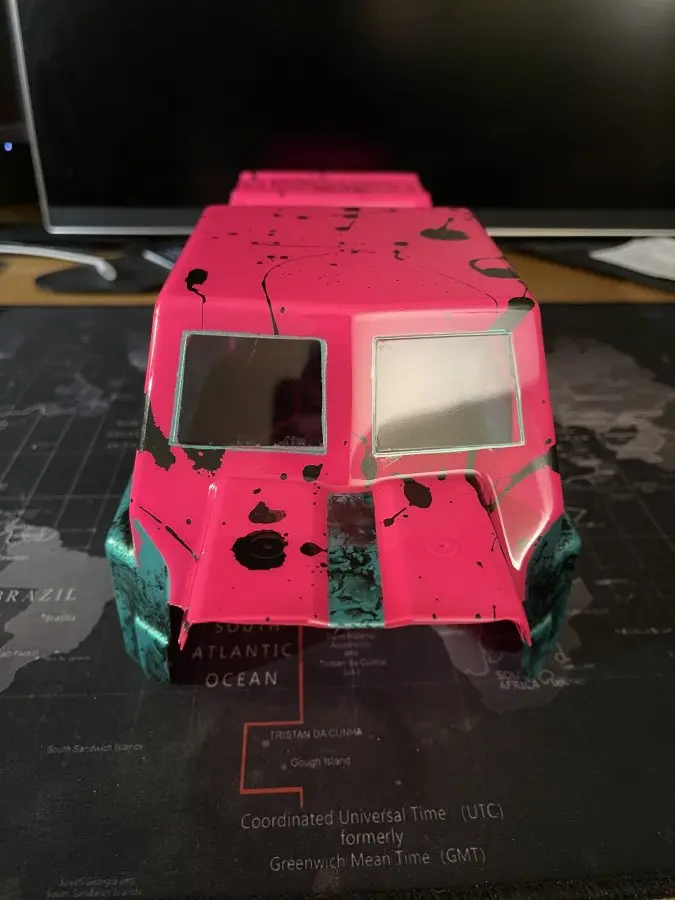

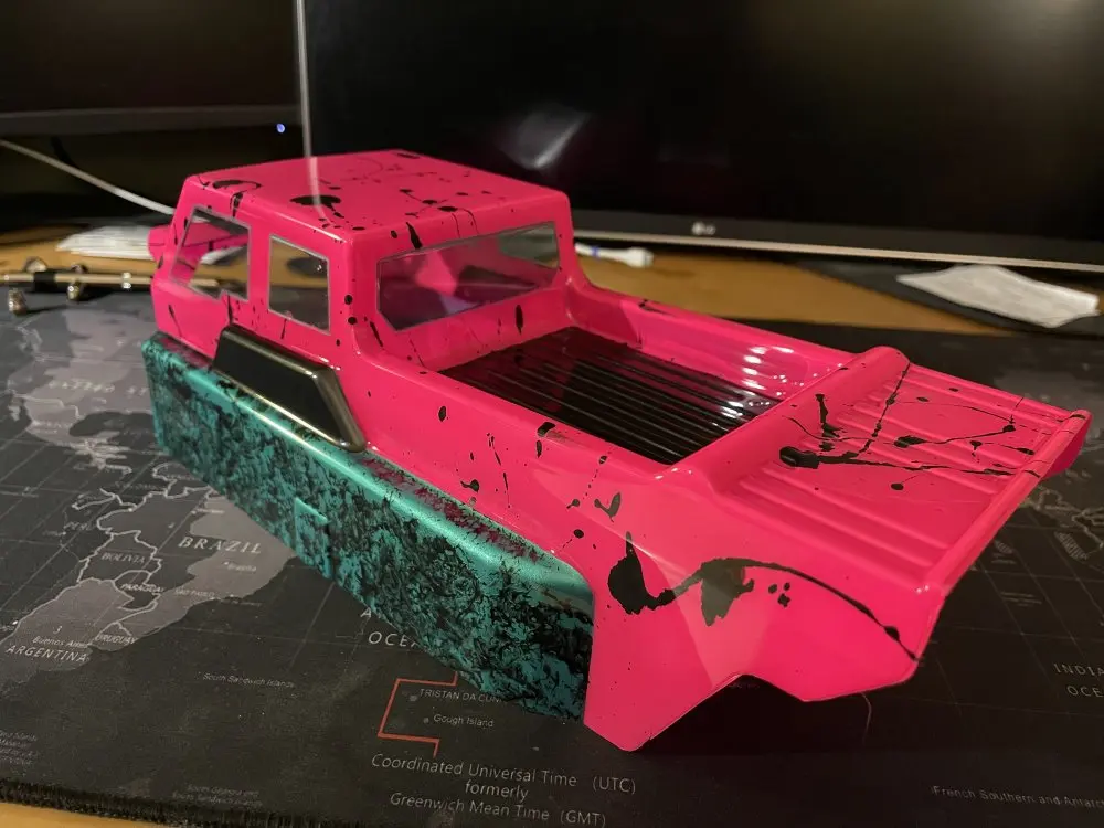

Second attempt at painting a body, pretty happy with how this one came out. Need to remove some sticky residue and a bit of overspray in the windows once it’s dry but lines are ok, look fine from a distance.

If you look in my build thread you can see how to stiffen up that servo mount
Thanks I did look through your thread before, will throw in some longer screws.
Considered seeing if it’s possible to use looong screws all the way up through the bottom mount , through servo mounts and lock the servo down with some lock nuts so it’s a single metal piece all the way through.

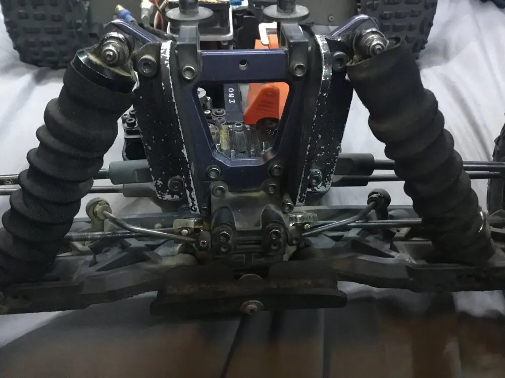

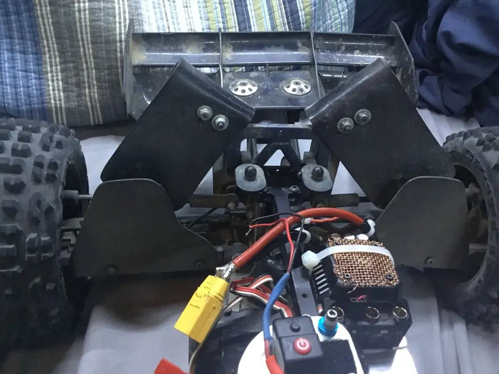

Looking for some way to protect top of the shocks/towers since they are exposed.
Might rig something up from HDPE, or buy one for another model and retrofit for a Cap on top that's replaceable.
Quarantine just wanted to share some ways I’ve protect my shock towers on ,y et48.3. The flaps going around the towers are 1/8” kydex. The mud guards are1/16 kydex. The braces on the shock towers are 1/8” x 3/4” aluminum angle. I have not bent a shock tower since I’ve done this…
