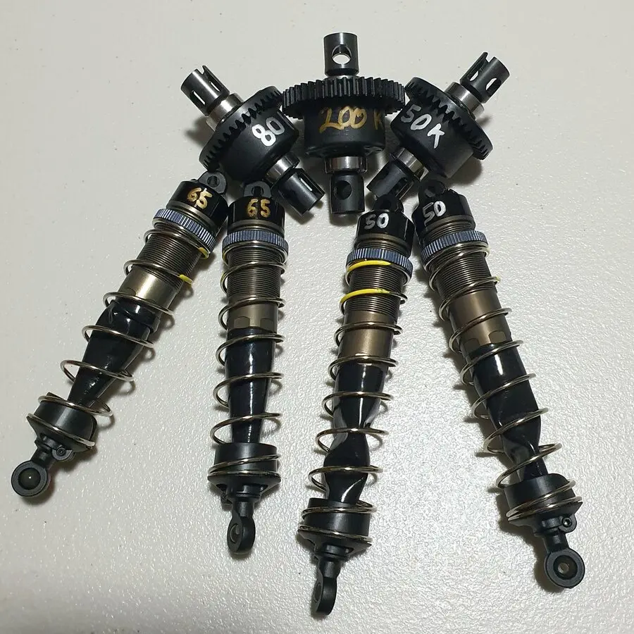

New Kit arrived today, but I'm going to use the one I've already built and convert it to the basher, I've started to install the Castle system again and I'll build the new kit diffs and shocks with basher oils.
I'm thinking of using 60k in the front 100k in the center and 30 in the rear for the diffs.
I was thinking of going for a slightly heavier set up in the shocks, so I'm thinking maybe around 80w front 55w rear?

I'm running 100kF/200kC/60kR and it runs good, doesn't steer super sharp though. CD gets up to 180F-190F using a steel cup. 100K in the center should be great on 4s, not so much 6s.
As for shock oils, I started with orange springs F/R and 900cstF/800cstR. My truck is pretty heavy so it still feels a bit light. Might work great for you.

Thanks a lot for the info I'll see what happens, I don't like not being able to turn. I tend to not bash much different to how I would drive on a track anyway so I never usually need a super heavy centre, the shocks I've got no idea what they will be like, but I'll set it up and make charges as required.
Got the new shocks and diffs built for bashing, now they are going to be transplanted into the race build, should be done tomorrow with the Castle system back in and ready to rip!
I'll build up the second kit as a race build and use the shocks and diffs from my already completed car. We won't be racing again for a while due to covid, so I'll take my time with it.
I hope these fluids will work out okay, I think it will be fun to drive anyway, plus I can always change things round if I need.
It would be awesome to have a spare set of diffs and shocks to be able to swap in and out whenever I wanted to test out something.
