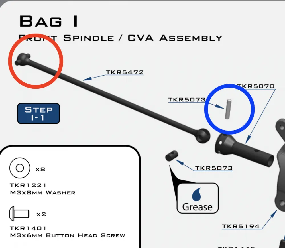

That video is helpful. It's hard to see which end he's doing. Refer to my picture below. Is this referring to replacing the red circled pin and NOT the blue circled pin? That would make sense. The blue circled one seemed to be easy to change. And if it is the blue circled one, then maybe after lots of use it becomes difficult to change without a tool?

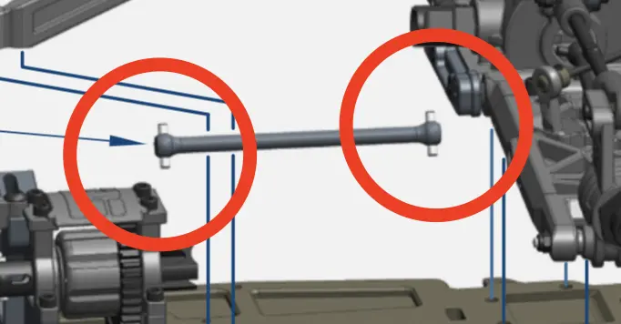

And you must be referring to the pins in the center drive shafts right? See below:
Yes, the pins circled in Red, the CVD rebuild kit I referenced earlier are the blue circle and don't need to be pressed out
Got it that makes perfect sense now. Adding those pins and that tool to my shopping list. Thanks for explaining
