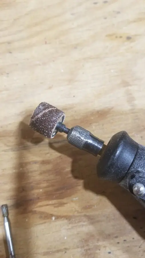

My first body I tried using my dremel and it didn't go anywhere as good as what I pictured in my mind and gave up after about 6" of cutting. I now have proper lexan straight and curved scissors as well as a body reamer and cutting the body is way easier and comes out looking better. After I do my cutting I use this sanding wheel in my dremel to clean up the edges and get rid of any sharp corners.

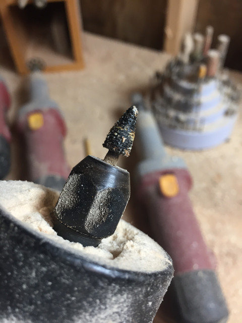

When it comes to the cutouts for my flotek bodies on my SCT, then I'll use a step drill bit on the front window and evenly drill holes along the lower front dash. The remaining holes are drilled out using my dremel with a chainsaw sharpening bit... I do this after the body is painted, but before I peel the protective film, and will rinse all the shavings from the underside and peel the film last after trimming all the vented holes.
