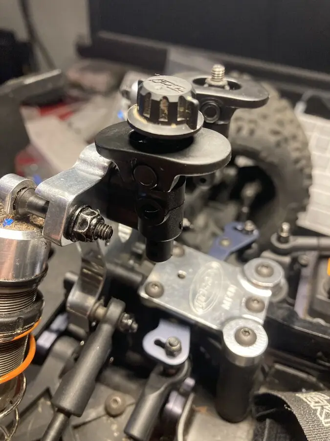

After bashing up a granite for the last year decided I was ready to step up, and I found a MT410 on ebay that had the 2 things I wanted.
-Castle/MonsterX combo
-M2C Upgrades
And it had basically never been driven. Certainly not abused.
I thought the MT410 was supposed to be indestructible, but I was a bit surprised when the body posts broke off within the first 15 mins on 3S. After searching here I see it's one of the most common problems.

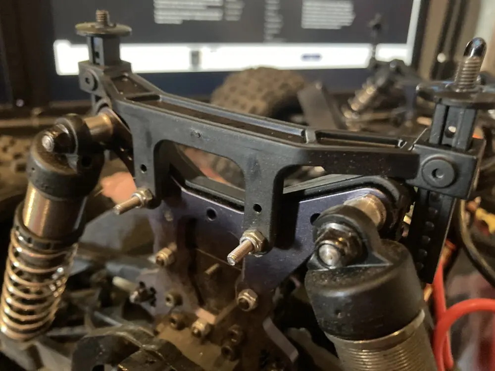

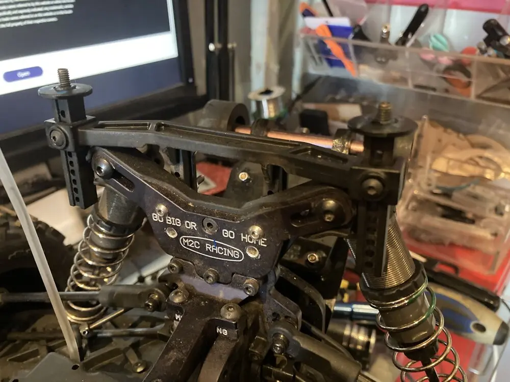

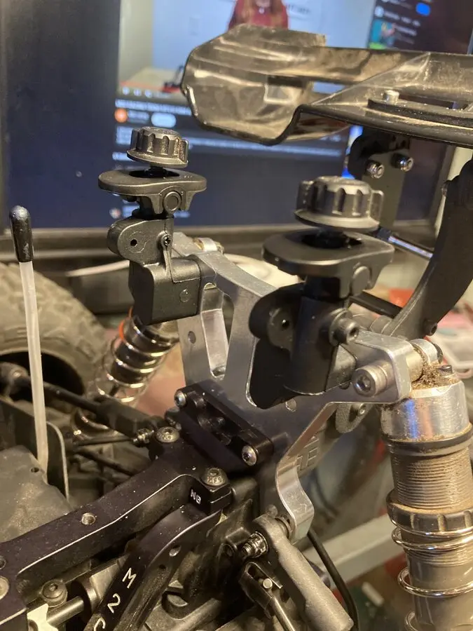

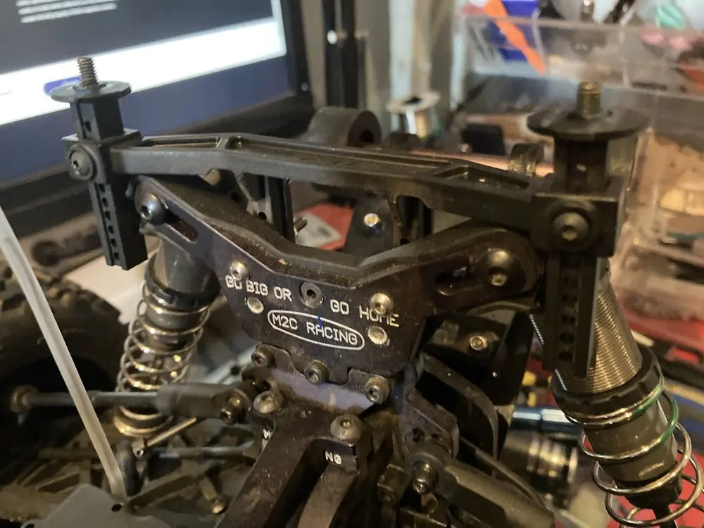

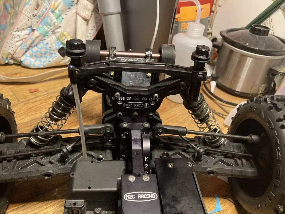

Thought I'd list my mod for the rear posts
I was able to use this Pro-Line product : https://www.amazon.com/dp/B0090TO12U?psc=1&ref=ppx_yo2ov_dt_b_product_details
Only required drilling 2 holes in the rear tower and cutting off the ends of the original post mounts.
Of note, this results in the post location being almost identical to stock location.
I have had 2 pretty intense bashing sessions with this config on the rear and the stock setup on the front. I'd say problem solved so far.
Next up is probably a front bumper from what I'm reading here...
