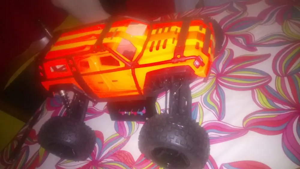

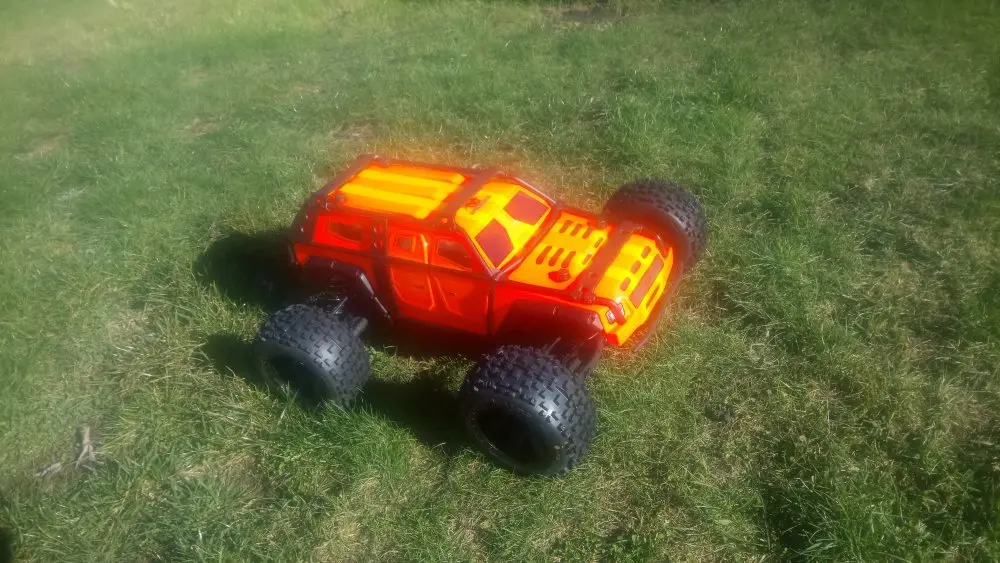

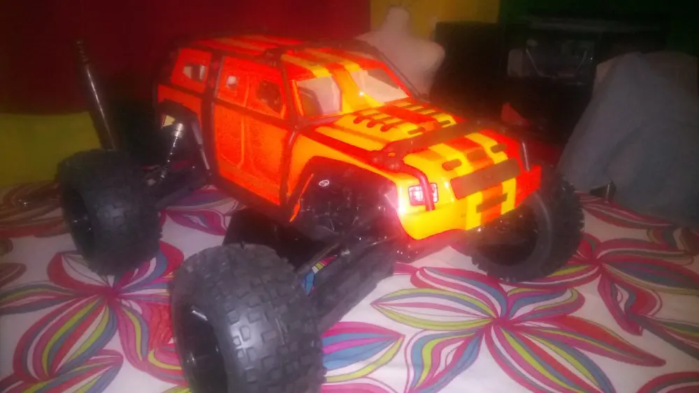

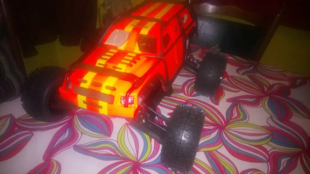

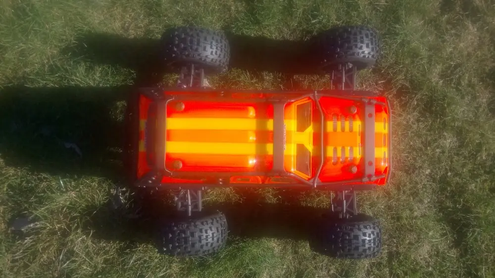

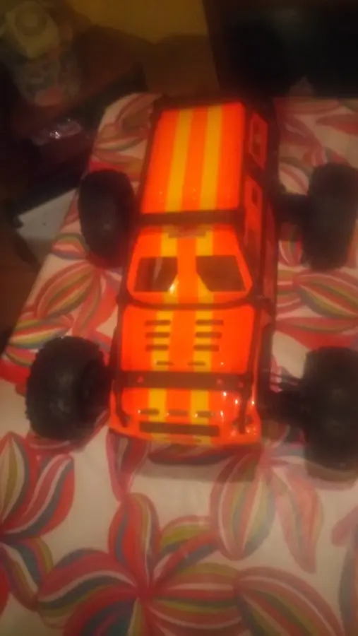

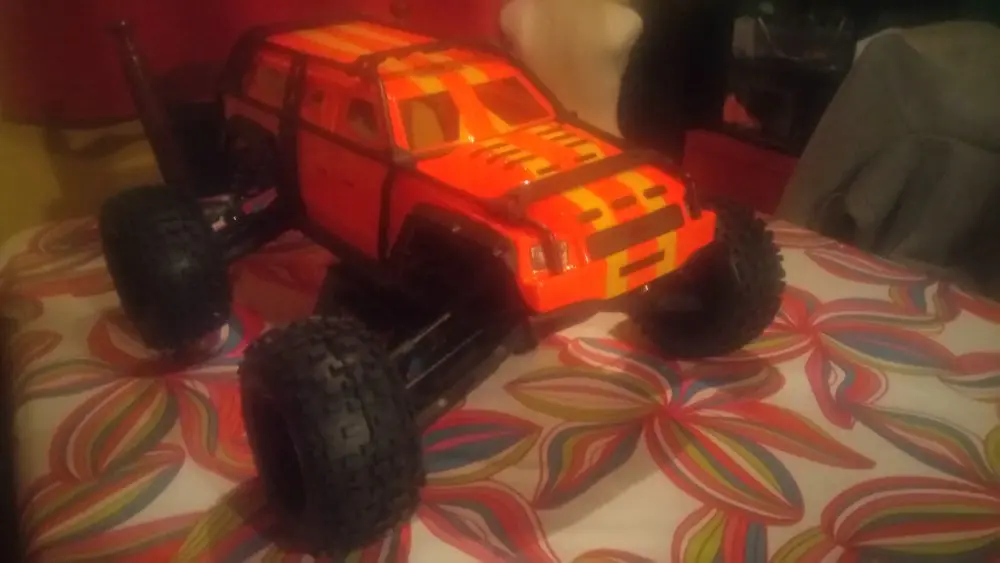

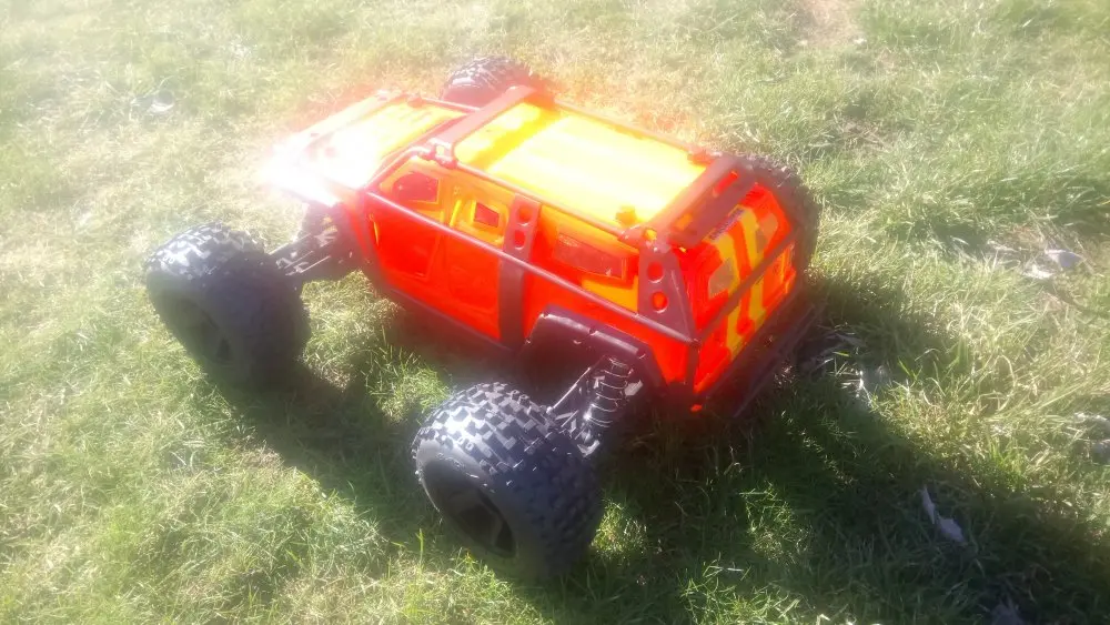

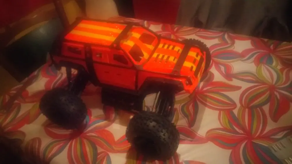

I took some pics with flash and it was a weird effect...:
2160
2161
2162
2163
It's the orange fluorescent colour of Tamiya with two "racing" stripes in normal yellow.

I have fitted the body yesterday.
I had to cut the posts to make them fit the body mount hole of the tekno.
Then I cut the support on top to make it fit in between the body.
Even now it is a tight fit to make the screw on caps work.
I'm guessing, it won't hold for long.

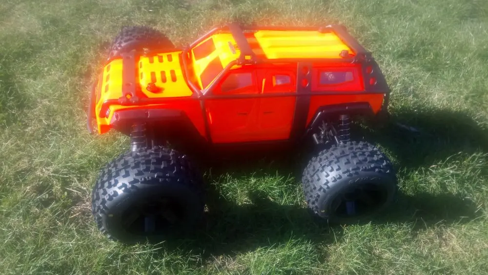

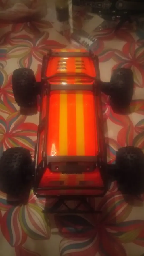

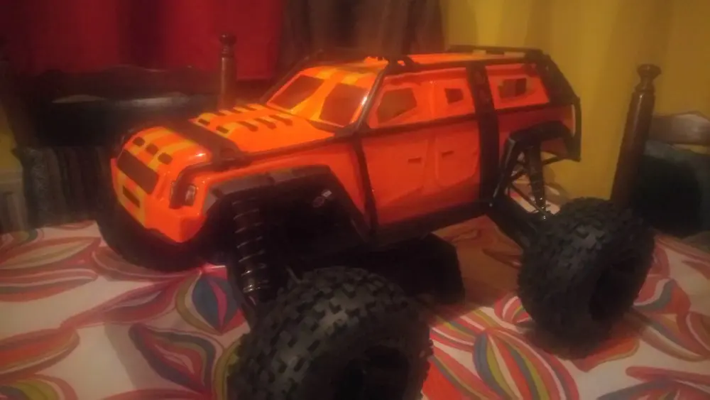

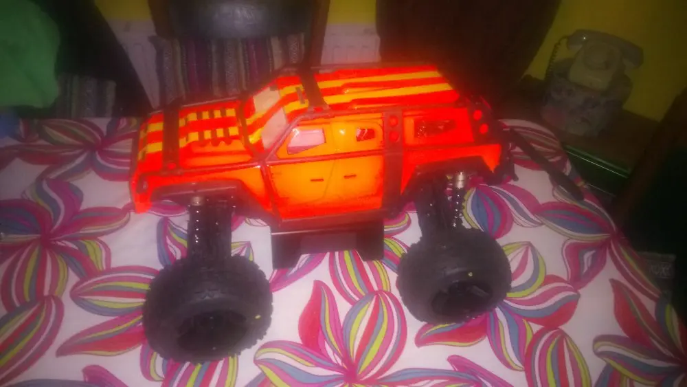

Really difficult to make a good pic of those fluorescent colours.. ^^
