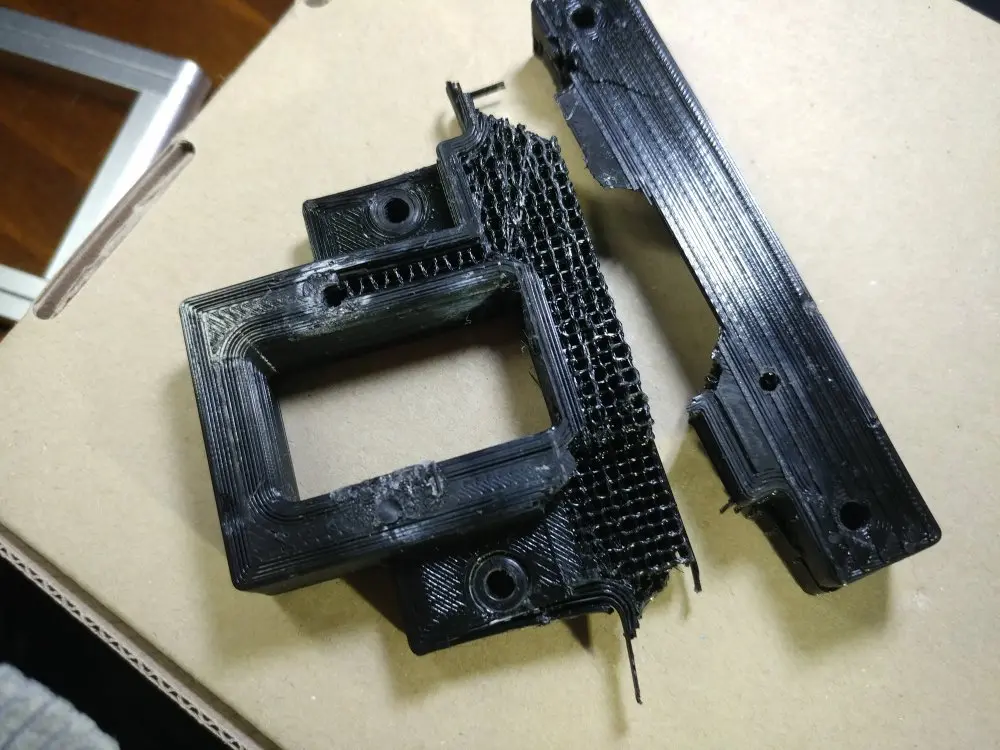

Once the cage mount broke, I wasn't too worried about it and kept going. I should bring some zip ties along the next time as I could have secured it with that, but the rear cage mount kept it in place for the most part.

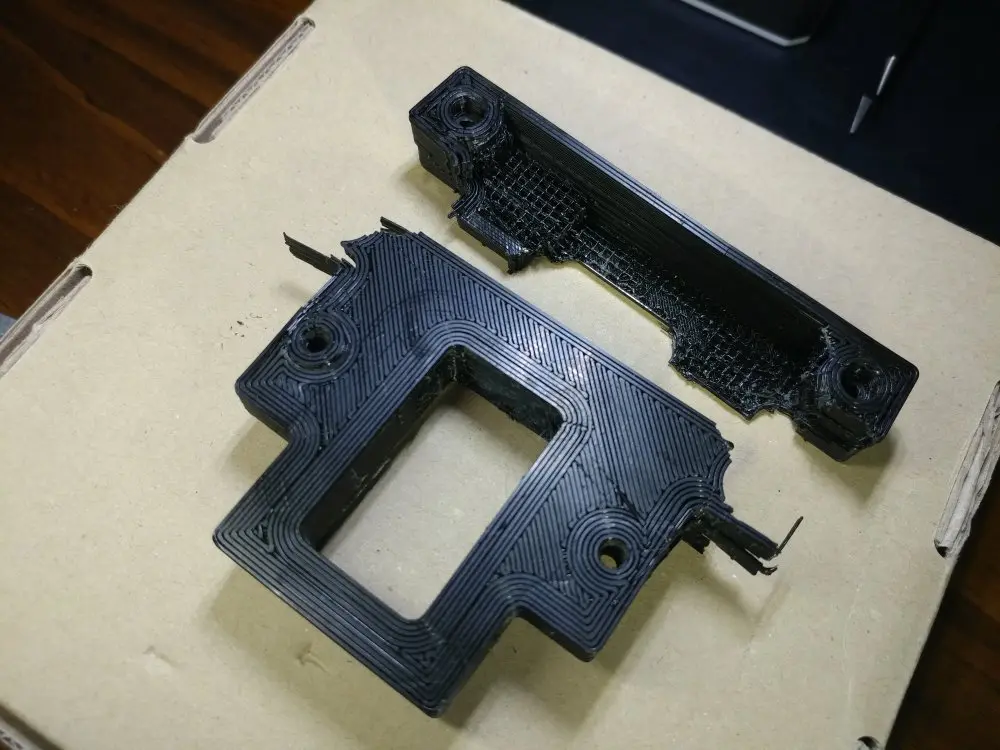

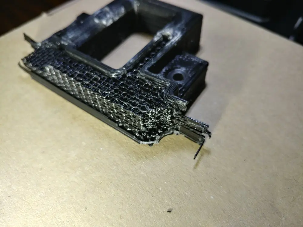

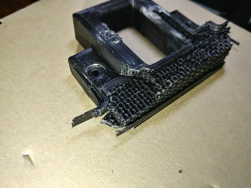

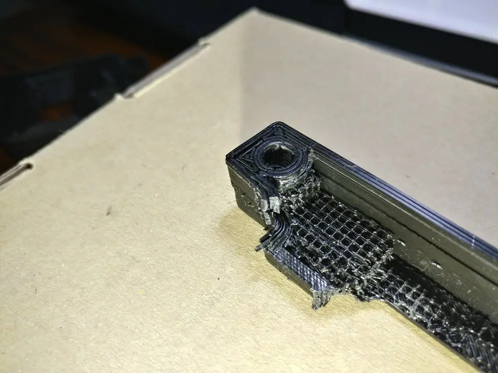

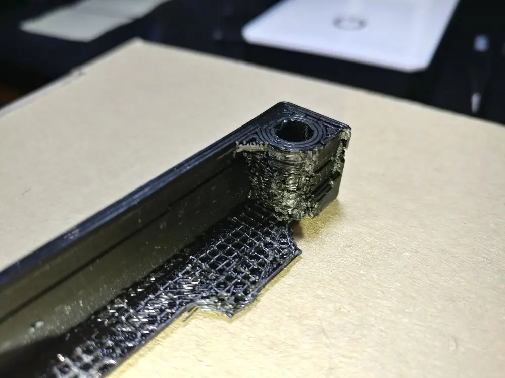

And the post mortem.
I printed that mount several months ago, and feel that I've improved my printing abilities since then, although I'm not sure I'd have been able to avoid this destruction. There does appear to be poor layer adhesion. I'm not sure what the infill was when I printed this part, guessing, I'd say 25%.
I've been kicking around some ideas for the cage mounts. Aside from the 3D printing I want to use, I want a quick removal process. A cage is great to have but they definitely make access more difficult. I'm thinking of a design where the cage will pivot/rotate in the rear, with a quick release in the front. Or maybe quick release front and rear and completely remove it. Not sure what I'll do yet.
For now, I'll just print the existing design in TPU filament to see how that holds up.
