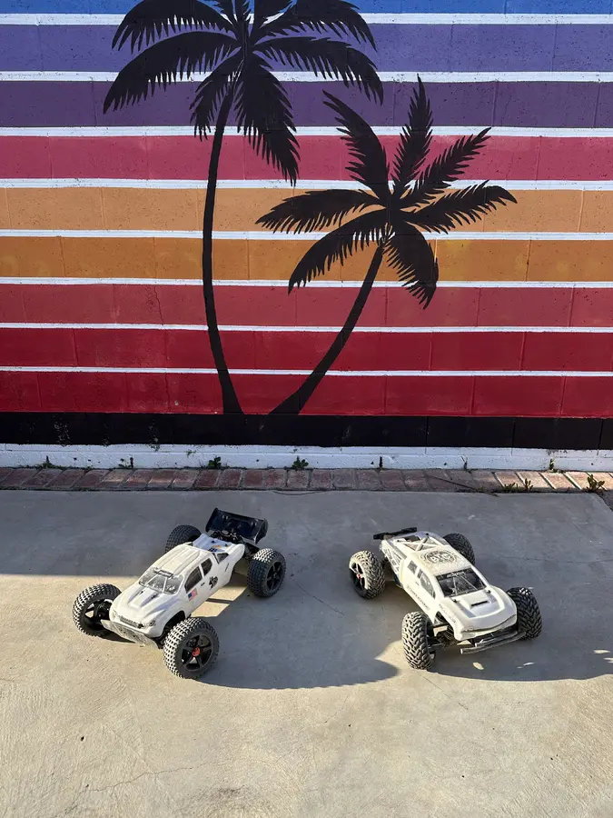

MT410 in two different flavors:
The short wheelbase is a lot to handle on 6s. The longer chassis (from the ET48.3) gives it much needed stability, but then becomes more of a speed basher.
I like the OG MT410 as is on 4s, turns on a dime, flips easy and stays manageable in a smaller backyard.
Nice looking cars.
Isnt running 6s on a 1615kv motor similar to running 4s with like a 23t pinion on the same motor?

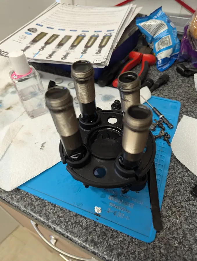

View attachment 10910View attachment 10911
Changed shock fluid and used the new revised shock mounts. They reduce wear with the shock cap.

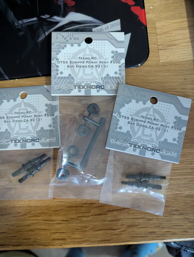

What are the part numbers to these standoffs?

Sorry took the picture with the labels around the other side​
TKR8727 -bushes​
TKR8730 - Stand offs​
What you are referring to is the theoretical top speed that is function of voltage, kv, gears ratio.
The reality of 6s is that at equivalent battery cell, you have 1.5x more power than 4s. It’s going to be faster, will generate more heat and wear & tear.
There’s likely a way to create an efficient 6s system that slows things down and focuses on durability. But i’ve never seen anyone do that. It would probably start with a reasonably sized lower kv motor.
The thing is, power depends on voltage, but squared, so ideally you have 2.25 times the power available. And 1.5x top speed. In practice it will be less due to increased electrical and mechanical losses and resistances.
