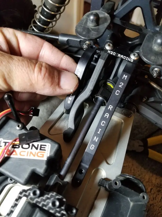

Chassis brace
M2C 7075 front/center chassis brace, M2C6905
This keeps flex to a minimum and protects the driveshaft and chassis.
M2C 7075 rear/center chassis brace, M2C6981
This keeps flex to a minimum and protects the driveshaft and chassis. The rear of the stock chassis has the most flex of any area.
