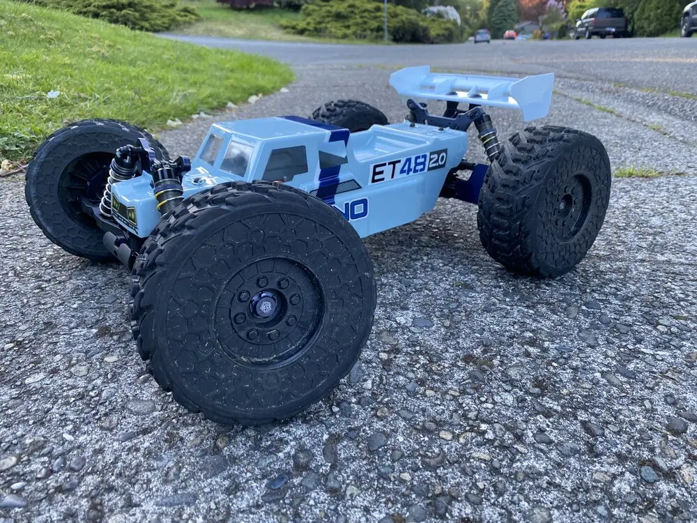

I can mount mine on my ET and verify as I just finished the build last night. I have both the 6S and 4S backflips that I can put on.

Yes, I can confirm that the chassis can slap the ground with the backflip 4s on.
so I failed to put my 6s backflips on but I put my Fireteam tires on which are 3mm smaller diameter. The front shocks bottom out before the chassis slaps, the rear does slap. Truck is setup 100% by the book so you may be able to adjust the front shock placement to allow for chassis slap.

thanks @PlayfordS - think I'll dabble with the LP3.8 4s in that case, and also might get some Fasttrax 3.8 block tires, which seem identical to the Dutratrax tires.
Cheers again.
thanks @a2lowvw - those tires look huge!
What light bule paint did you use? Like the colour and am looking to do a marbling effect with white..
